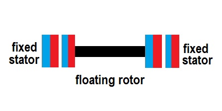

You could build a simple test setup using much smaller magnets and no Alu enclosure for the magnets at all, to see that a thus floating rotor is able to spin freely at all (like it does in the toy setup), see a drawing attached. If the floating rotor can spin for a relatively long time, then insert an Alu sheet of certain thickness into both air gaps to see whether spinning slows down or not. You may need to increase air gaps to accomodate for the thickness of the Alu (or copper) plates.
Similarly, you can place Alu sheets as if they were side walls, close to the floating spinning rotor to see any decelaration.
Either 4 cube or 4 cylinder magnets you happen to have could be used for such tests. Alu plate thickness counts too.
