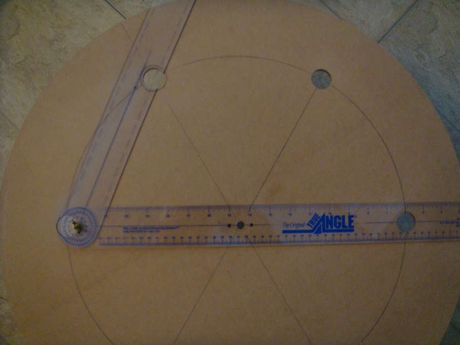

              To start out on this work, I first removed the center hub assembly from the wheel because I wanted to scribe a 30 degree radian line between two of the six 60 degree radian lines on the wheel. When the wheels are mounted to the shaft on the supporting mechanism, one of the 60 degree radians on wheel #1 will be in alignment with its adjacent upright support, and Wheel #1's shaft collars will be locked to the shaft with the set screws. With that alignment maintained, wheel #2 will then be rotated on the shaft to the position where the 30 degree radian line is in vertical alignment with the opposite upright support, and its shaft collars locked to the shaft. The effect will be to have a pipe placed every 30 degrees in the rotation.
              With the 30 degree radian line drawn, and which appears in the first below photo, I then set the wheel on top of a large, round popcorn tin that my sister had sent us for Thanksgiving so as to allow placement of the pipes into their respective bore holes, which obviously cannot be done with the wheels' bore holes laying directly upon a flat surface. I positioned each pipe to lay against the elbow of the next pipe, and laid each pipe centered on top of its standoff block. The blocks were moved outward along the pipes as far as possible, so are position up against the PVC fitting at the pipe ends. With everything aligned thusly, as seen below, I took a sharpened pencil and scribed an outline of 3 sides of each block onto the wheel to mark the correct positions for the blocks.

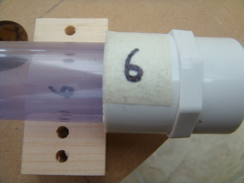

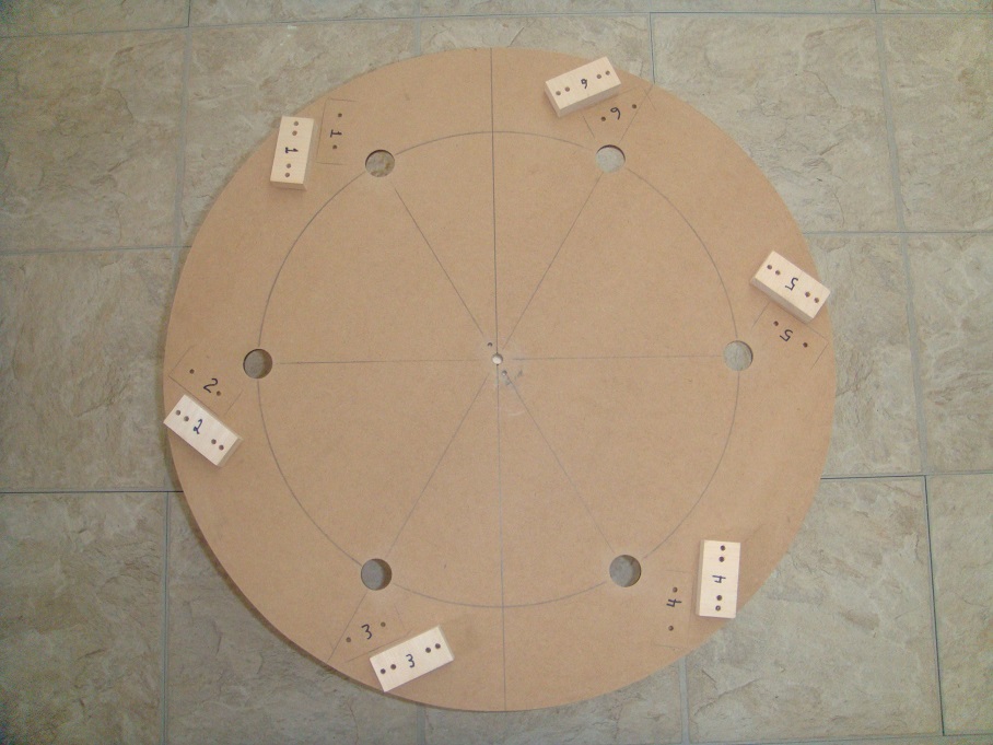

              With the block outlines marked upon the wheel, I then applied a number label to each pipe end, and numbered each block to match, assuring that reassembly, after drilling the block mounting holes through the wheel, will be precise. Each block is numbered according to the number of the pipe that lays upon it, as is seen in the example of pipe and block #6 in the below image.
              The next step was to remove all the pipes, and then slide each block over a few inches so that I could label the scribed block positions same as the block numbers, as show below.

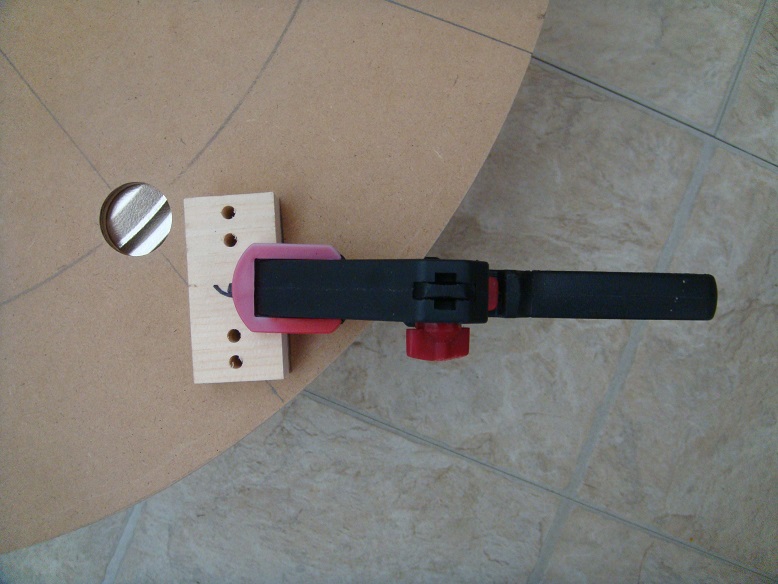

              With that done, I proceeded to individually move each block into its correct position at the scribed outline, and clamped it in place for drilling the mounting holes in the wheel, inserting the 3/16 drill bit into the inner holes of the block as a guide template. Here again, the bar clamp proved very useful for that purpose, as seen below. Before drilling, I re-positioned the block as close to the edge of the popcorn tin as possible to provide stable support. You can see the lid of the tin through the block's adjacent bore hole. Needless to say, but I'll say it anyways, one definitely wouldn't want to place a hand under that area of the wheel for support while drilling. What can't be seen in the below photo, but which I also did, was to place a block of wood under the area of the standoff drilling, which is included in the clamping. This allows for a clean cut through of the wheel material, which otherwise would be quite ragged.
              Here's an image showing the result of the completed drillings:

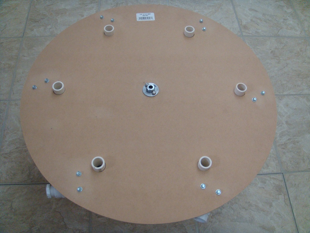

                With the wheel drillings for the standoff block mountings completed, I then attached each block to its respectively labeled position using #12 x 3/4 inch sheet metal screws, re-positioned the numbered pipes, and fastened the pipe straps to the blocks using the same screw size. The screws were simply snugged up slightly after contacting their mating surface material. It is important not to apply any further force to tightening, as it is not necessary and would quite likely result in the screws stripping and enlarging the holes.
                At this point, I also re-fastened the inner and outer hub assemblies for this wheel, and this time I used allen screws and nylock nuts. This allows for a much tighter assembly than the phillips screws and plain nuts that I had originally used. Here's a photo of the re-fastened hub assembly;
                By the way, here is an image showing the label for the hardboard material the wheels are cut from. The "MDF" designation stands for Medium Density Fiberboard.
                Here's an image of the outer side of wheel #2 as completed, with all pipe standoffs and pipe straps fastened. You will notice that pipe #2 has it's threaded end plug inserted. The end plugs, when removed, allow for filling of each pipe partially with water, and then affixing the end plugs for a water-tight seal. That will allow for experimenting with differing water fill weights. The initial test amount will be approximately half the pipe's holding capacity, which I am simply guessing will be the ideal fill amount to throw weight inward and outward. You will notice, of course, that in this revised 3/4 inch build using the larger wheel size as necessary to obtain the 68 degree lay angle of the pipes, the pipes do not overhang the circumference perimeter of the wheel nearly as much as they did in post # 19, which showed the pipes inserted in the bore holes of the smaller wheel. That photo more closely resembled the original design concept drawing shown in post #2, with about half of the long pipe length overhanging the perimeter. There are 3 reasons for this difference, one of which is that the larger wheels are twice the diameter of the smaller ones. The larger wheels are also cut out at a diameter larger than necessary. I had cut them to the full 24 inches available, as I figured this would allow placing the standoff blocks nearer the pipe ends for better support. The other reason is that the pipes on the smaller wheel were at a wider angle - nearly 6 degrees wider. As the lay angle is narrowed, it of course draws the pipe ends in closer to the wheel's perimeter. I intentionally built the supporting structure so that the height of the shaft would allow either the small or larger wheels to be used, and it also allows for the pipe lengths to be extended if I should want to do that. Even when using the larger wheels, the pipes can be extended several inches.
                Here's an image showing the inner side of the wheel, with the short pipes extending from the elbows and protruding through the wheel's bore holes:
                The short pipes extend about 0.650 inch past the inner wheel surface. I purposely cut the short pipes to allow for that dimension, which is 0.100 less than the depth of the pipe cap seats, as this allows each cap to tightly fit against the wheel surface when installed. I'll apply a light bead of silicone sealant at the cap seats to ensure that each cap is water tight, and this will also allow the caps to be removed if desired. If the caps were bonded to the pipes with PVC cement then of course that would be impossible. The caps fit so snugly on the pipes that perhaps the silicone sealant would not even be necessary, but I'll use it anyways, just to be sure. Here's an image showing one of the pipe caps installed. These caps are slightly rounded on the top, and with the raised lettering the overall height above the wheel surface is about 1.030 inches. This same dimension will be the spacing between the two inner wheel surfaces when assembled on the shaft.

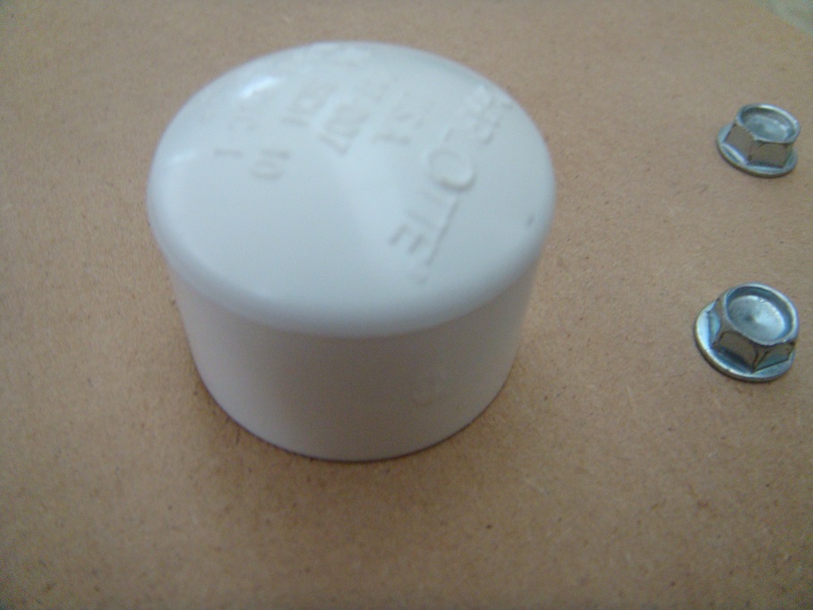

                        With both wheels assembled now, the next step will be to apply a small bead of silicone to each of the 12 end cap seats and install the end caps by twisting them onto the exposed pipe ends until the caps bottom out against the wheel surface. Hopefully I will be able to get that done tomorrow, and the wheels will then be ready to mount on the shaft.
