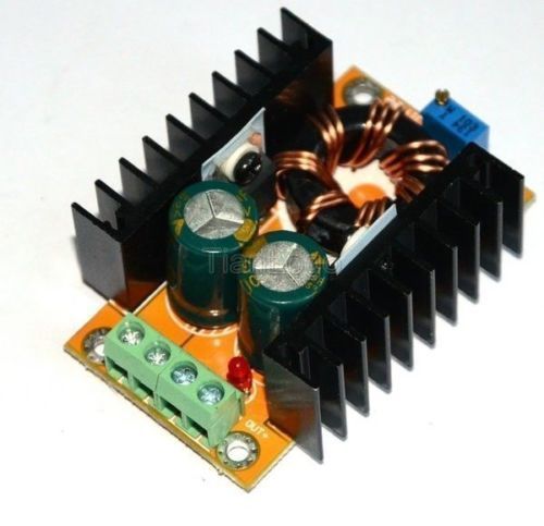

          much grateful brothers i guess i just found the solution on e-bay for only 7$, the chinese have it all!!
          DC-DC 12V/24V to 48v 60v 72v Boost Power Supply Module Step Up Converter Charger | eBayDIY a output adjustable car power supply.
          DIY a charger, for example, step up 12V power supply to charge a 48V battery
          Power for electric device
          Solar battery charger for electric vehicles
