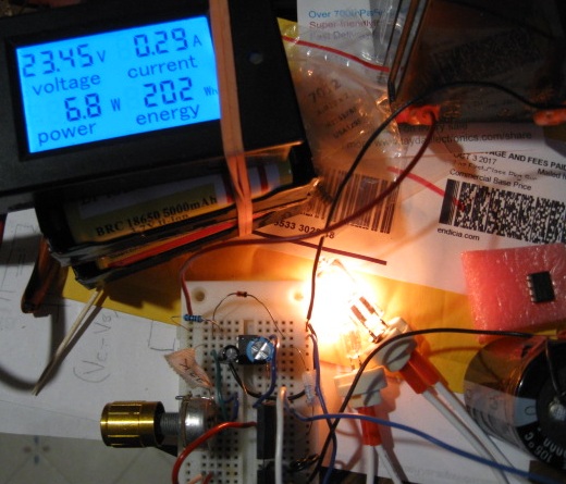

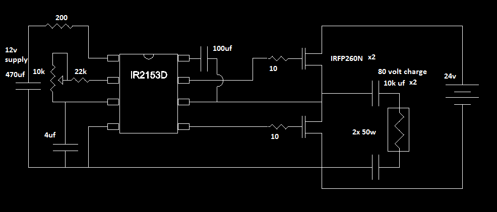

                    Something a little more advanced running on 18650 li-ion cells using an IR2153 half bridge driver.

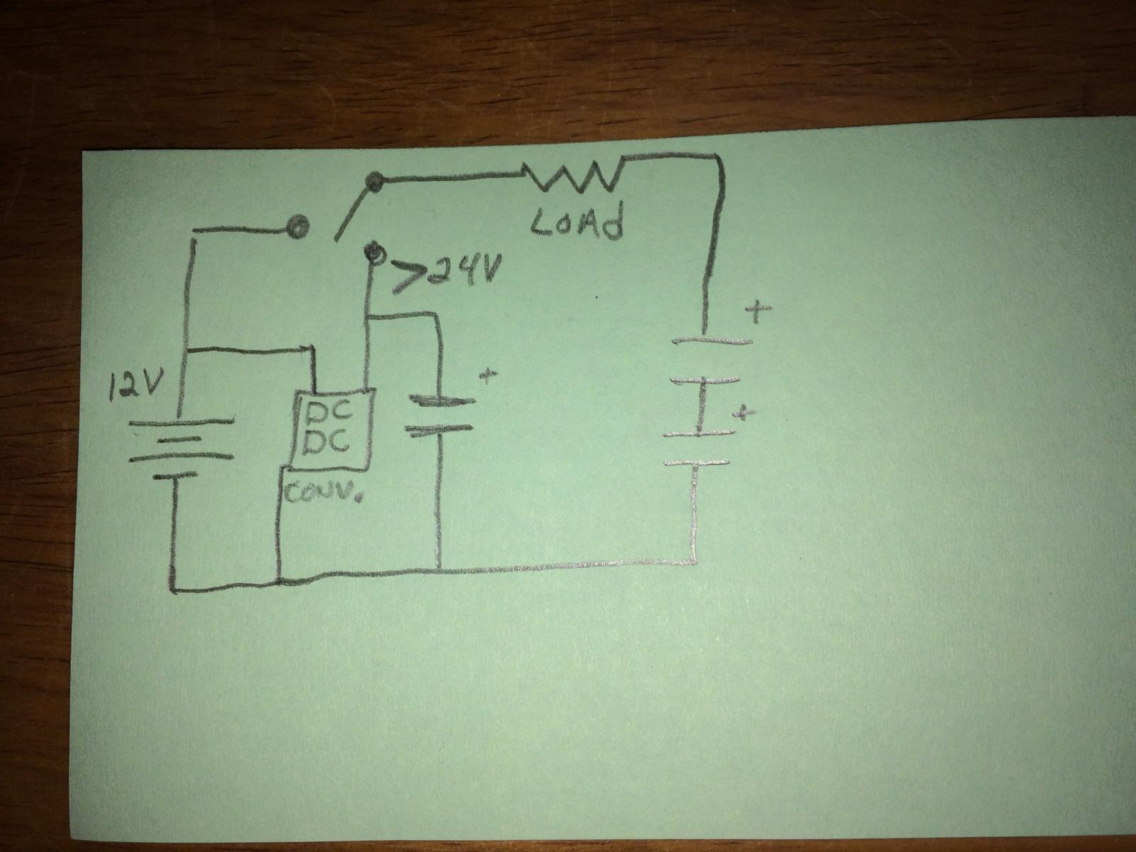

                          So what about the variation i've been testing, the drawing i posted.
                          If it works out the same, 300 watts output, while only using 150 watts, then what does charging the battery on the second pass contribute.
                          Maybe it works out the same, 75 watts input, if charging the battery is only 50% efficient.
                          Hmm, have to think more about this.
                          peace love light
