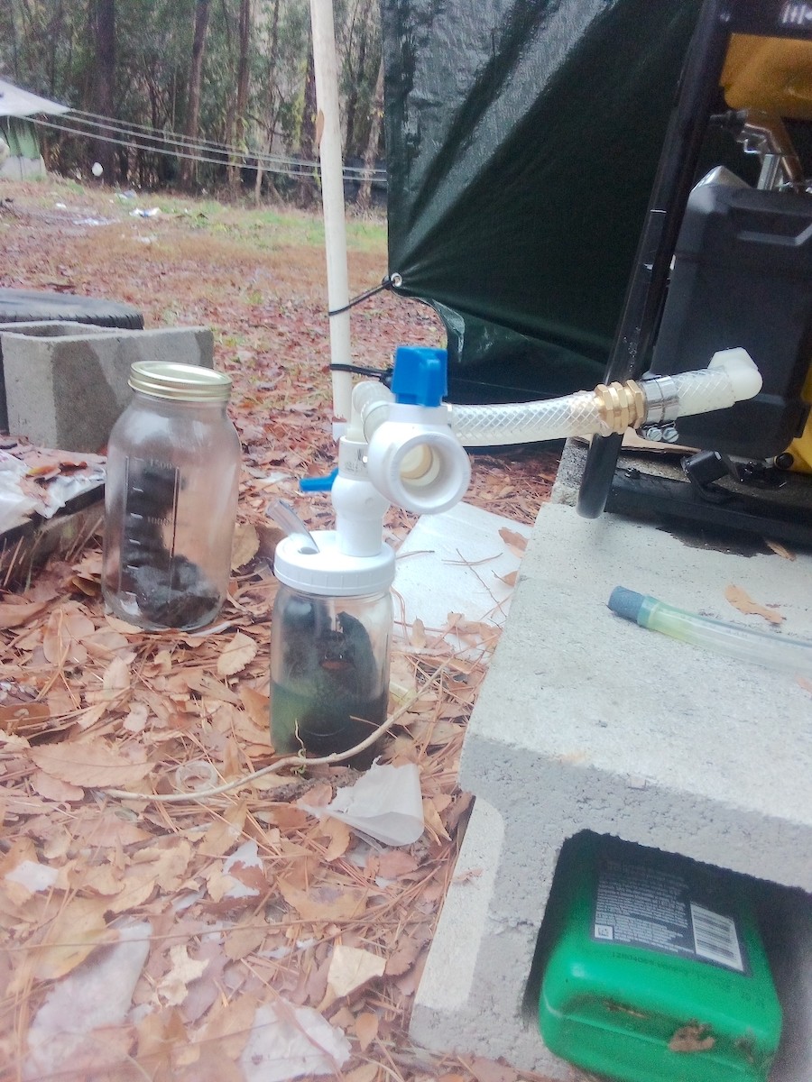

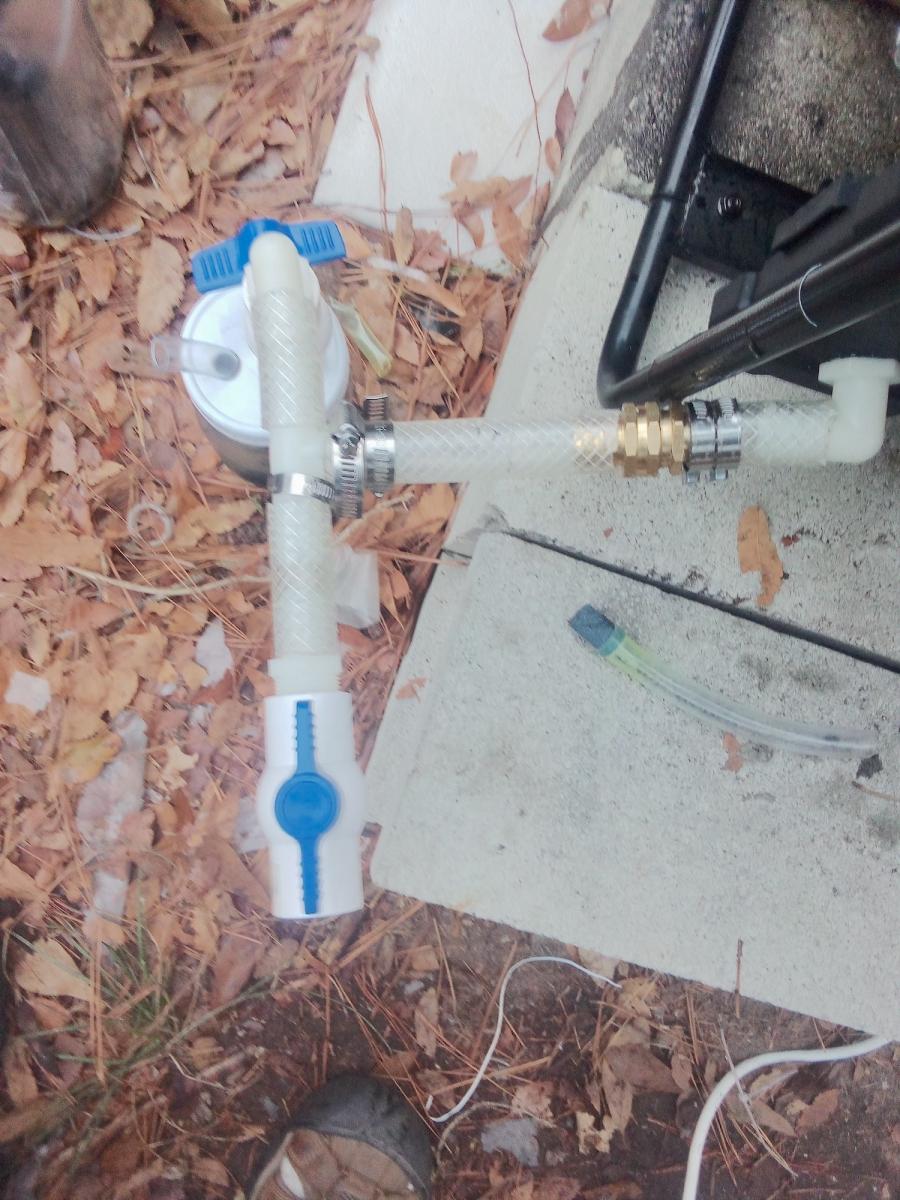

              I wanted to do a few more trials before I responded to you with the photos that I have now uploaded.
              I have new champion 1200W generator with new spare carb and airbox assembly. I measured the air intake holes on the airbox and calculated the total air inlet area to be same surface area as inside diameter of 3/4" hose.
              I used RTV silicone to seal up the airbox air inlet and made a 3/4" hole in the front opening and mounted a fitting and started the engine and ran the genny for a whole day under load using the modded airbox and it works fime.
              Next I created a brass FLAsBaCK aRREsTOR and attached it to the airbox fitting and again the genny operates fine with it installed!

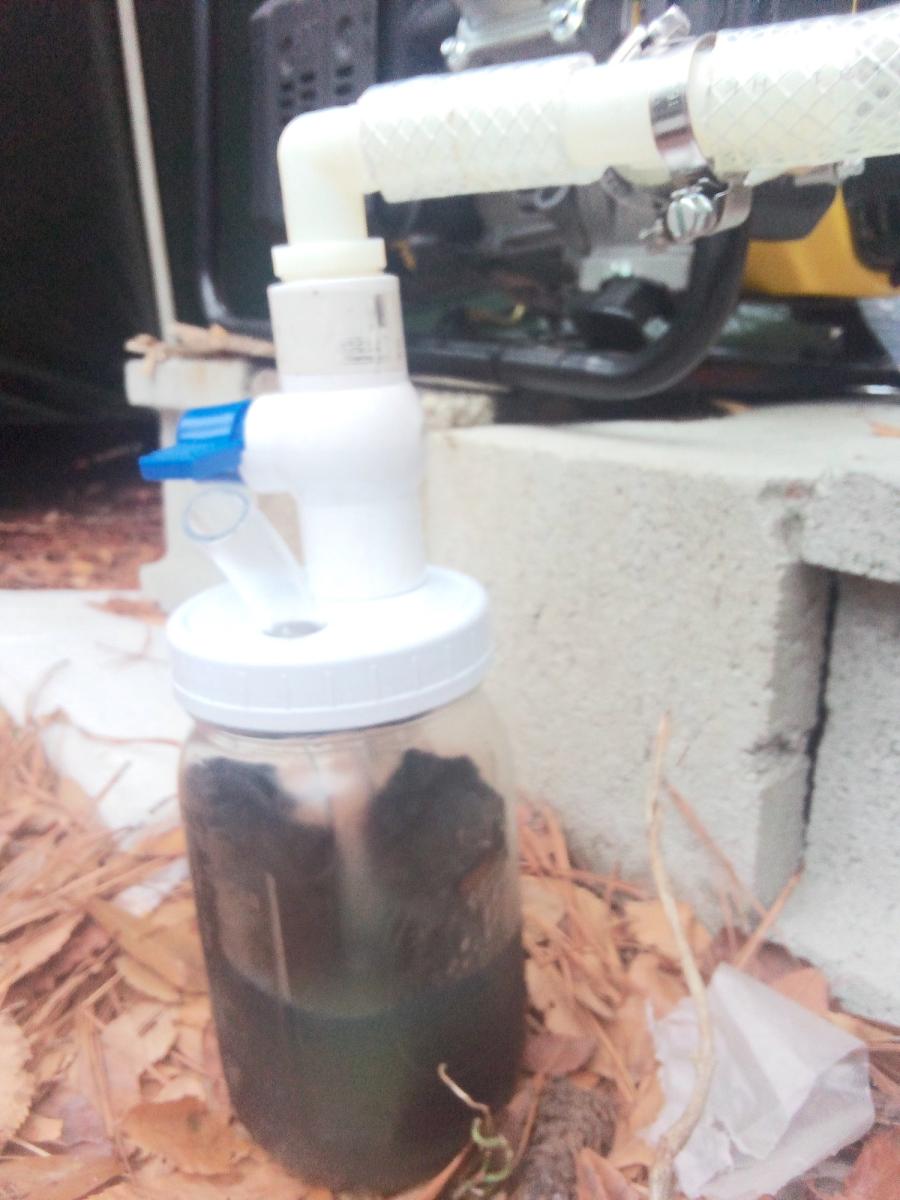

              Next I assembled the vapor assembly using a mason jar with appropriate hoses and valves to allow for mixing gas fumes to air ratio.

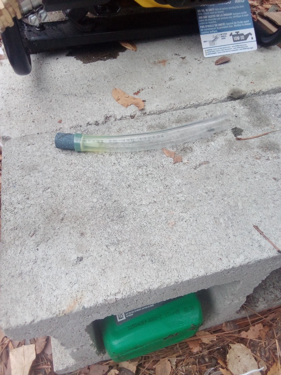

              I have tested different items in the setup including with and without wicking material, with or without air stone bubbler, plain open tube bubbler, 1 quart and 1/2 gallon mason jars, ultrasonic mist maker inside the jars, swapping valves to different locations in the setup.
              I have been able to START and RUN the genny by TURNING OFF the built in generator fuel valve on the carb and run on fumes alone, however regardless of the configuration I use it will begin to surge and cut off anywhere between 10 minutes and an hour.
              I notice that during the surge gasoline with quickly condense and get drawn into the tube leading to the airbox and flood the engine causing it to stall. Enough gas to actually drip out the airbox!
              If I catch the surge quickly enough, before the condensation phase, I can turn the fuel valve built into the generator leading to the carb back ON and the surging will stop. The engine calms down, and runs normal.
              If I LEAVE it like this to draw both vapor and fuel from the carb, eventually the engine will stop from too rich fuel mix.
              Logically it appears that during the run "something" is causing the engine to call for MORE GAS as if it is not getting enough, This causes the engine to slowly and quietly begin to surge, which builds up rhythmically with increasing intensity until the engine floods out.
