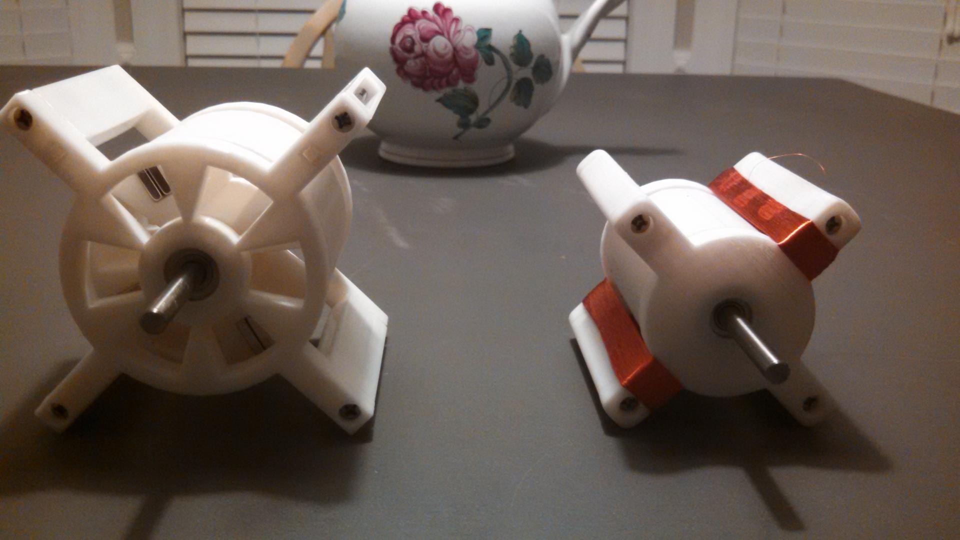

        Here is a picture of the two side by side.Click image for larger version

          Hi Dmann. Those are awesome. I seen a couple of other models at ES forum. These two are scalar north. I've got a buddy with a printer and I hope to print a your Bedini style window motor. I really appreciate your designs and that you make them available for everyone to print. My problem is deciding which one!
          al

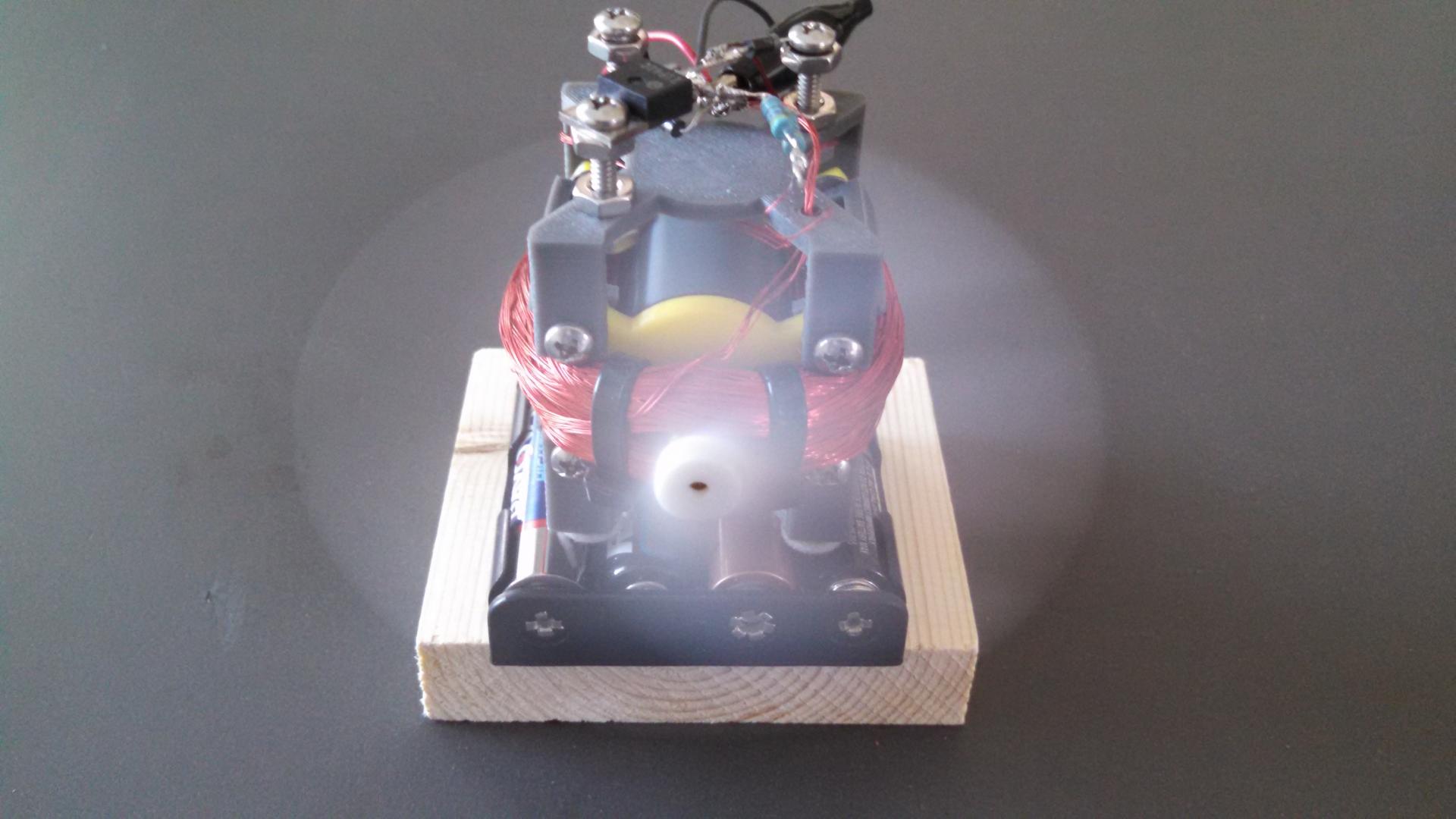

            Hey al. Yes, that one thus far is my favorite. It is easy to experiment with. I take that one, scaled down to 50%, everywhere. It runs on really low voltage. Those four alkaline batteries were "dead", from remote controls. They barely ran the motor when I first plugged them in. I ran a conventional fan behind it for a day and I guess it conditioned the batteries. I believe there is some sort of alchemical process that occurs in the batteries.
            I know that changes can occur between metals and acid/alkaline substances in extreme heat. I watched someone make red glass from gold powder using a strong unknown alkaline substance. Maybe the radiant does something in the batteries that mimics the extreme heat.

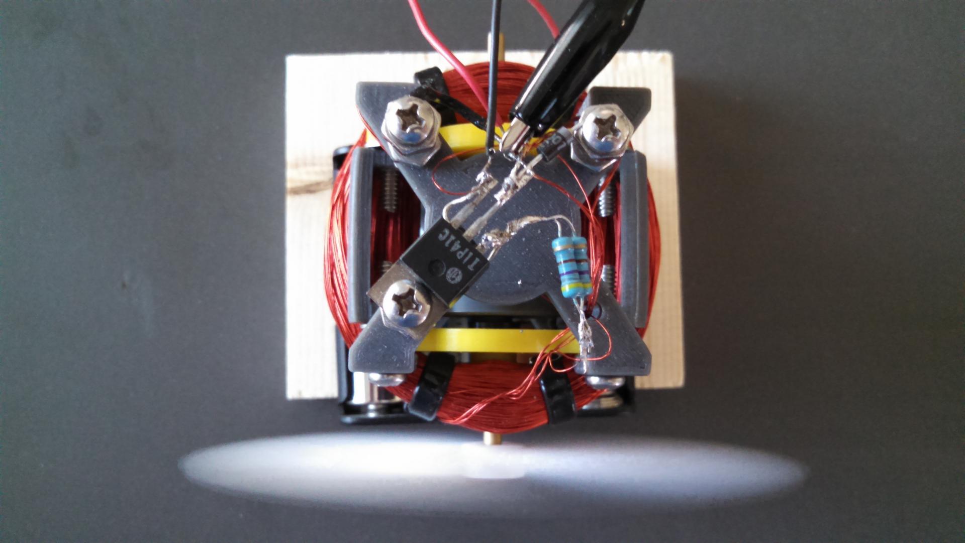

            The motor here is in the window motor configuration. There are four 31awg wires at 120-130 feet (3 for power 1 for trigger). The AA batteries are in series. It is being run on the basic SG circuit. The Tip41C does not have any trouble at this low voltage. I have run it on the SSG at 36 volts. That was way too much. The wire stand-offs got too warm and began to collapse on the brass shaft. The diode is a 1n4001 and the resistors are two 1/4 watt 470 ohms in parallel.
