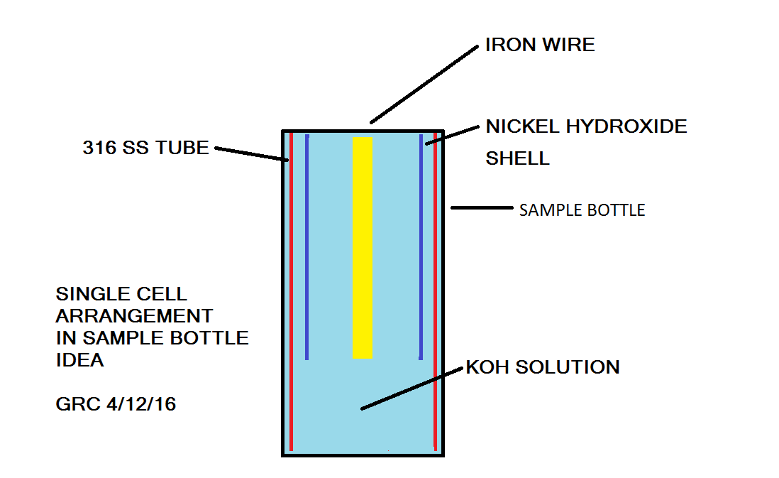

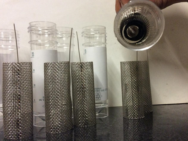

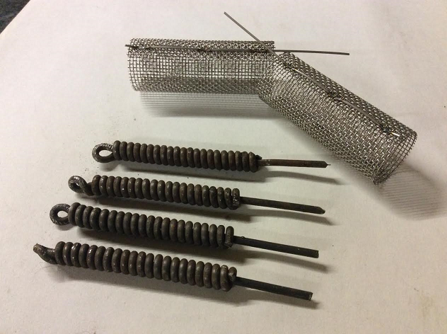

I have had the privilege of working with Mike on this project, attached are some pictures of a single cell the remaining four are under construction and my progress will be documented here when time permits.
