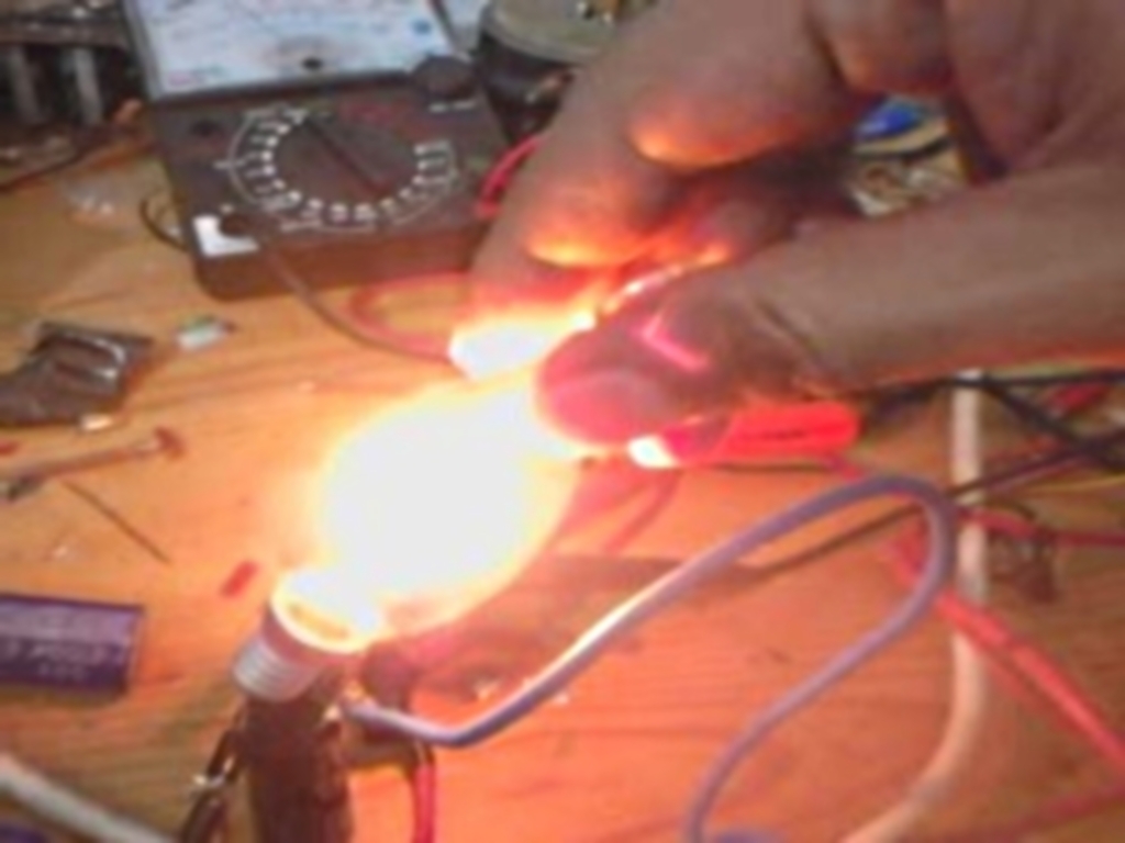

      the following photo show a 40W 220v light bulb bright in every 3 s in a system use only 3W as input, this is another enhancement known as the serial ETBC :

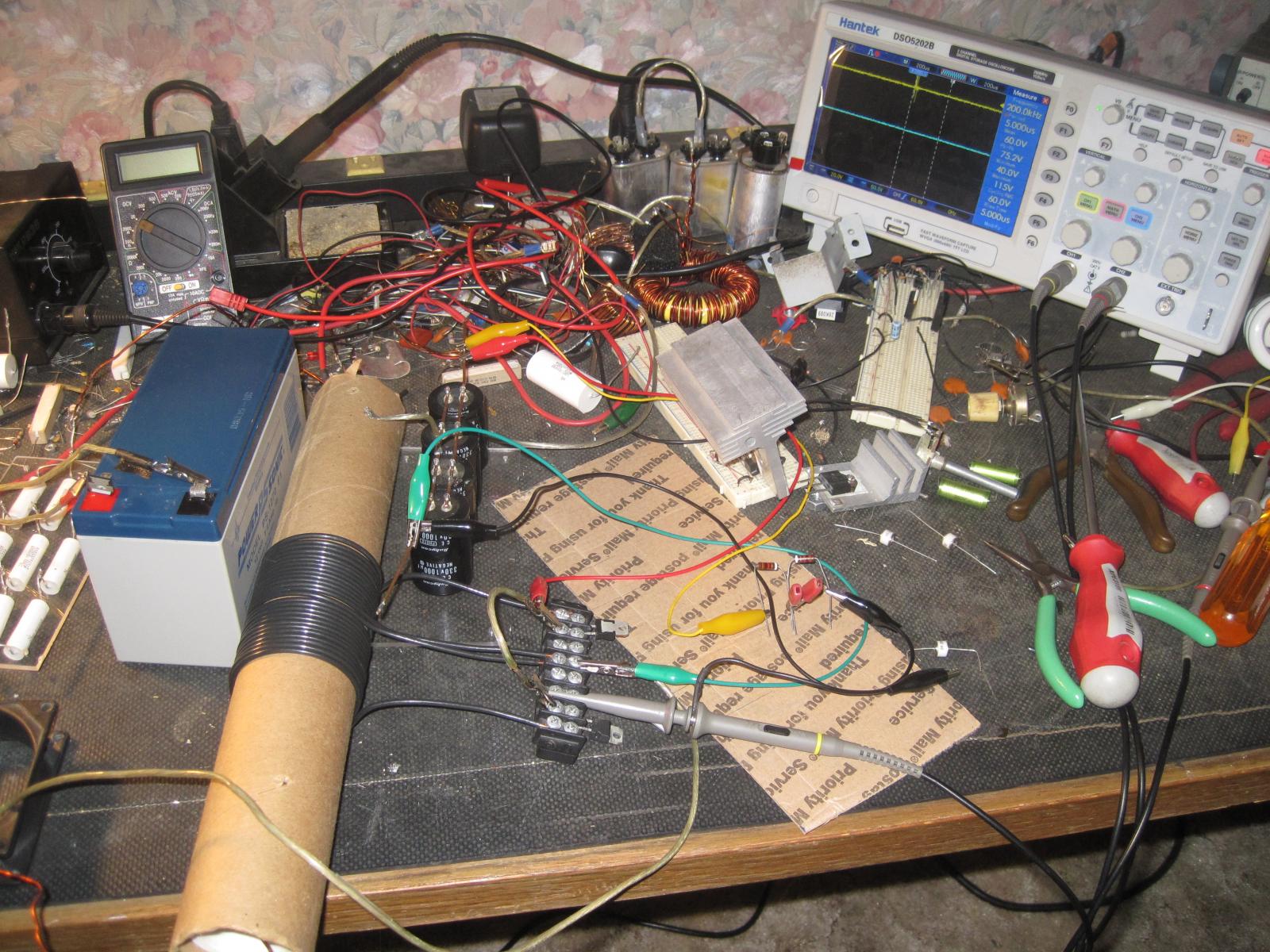

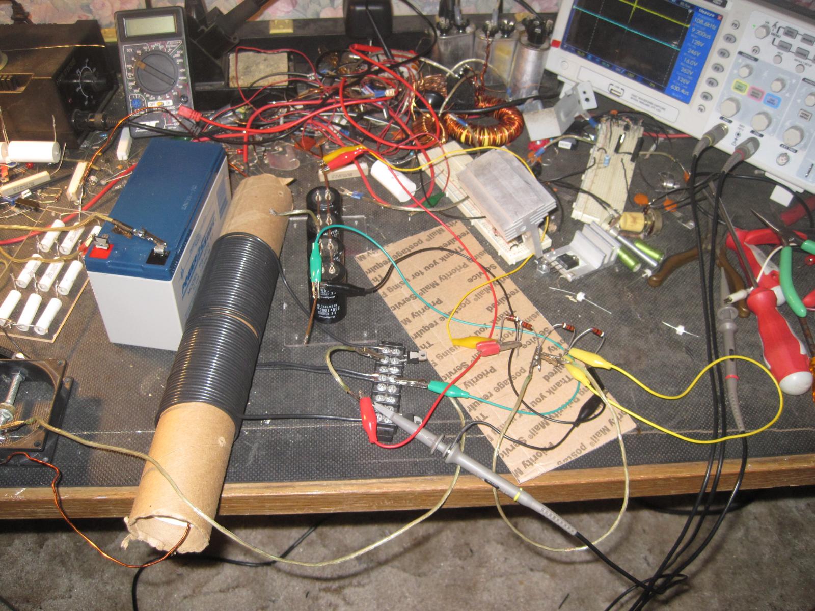

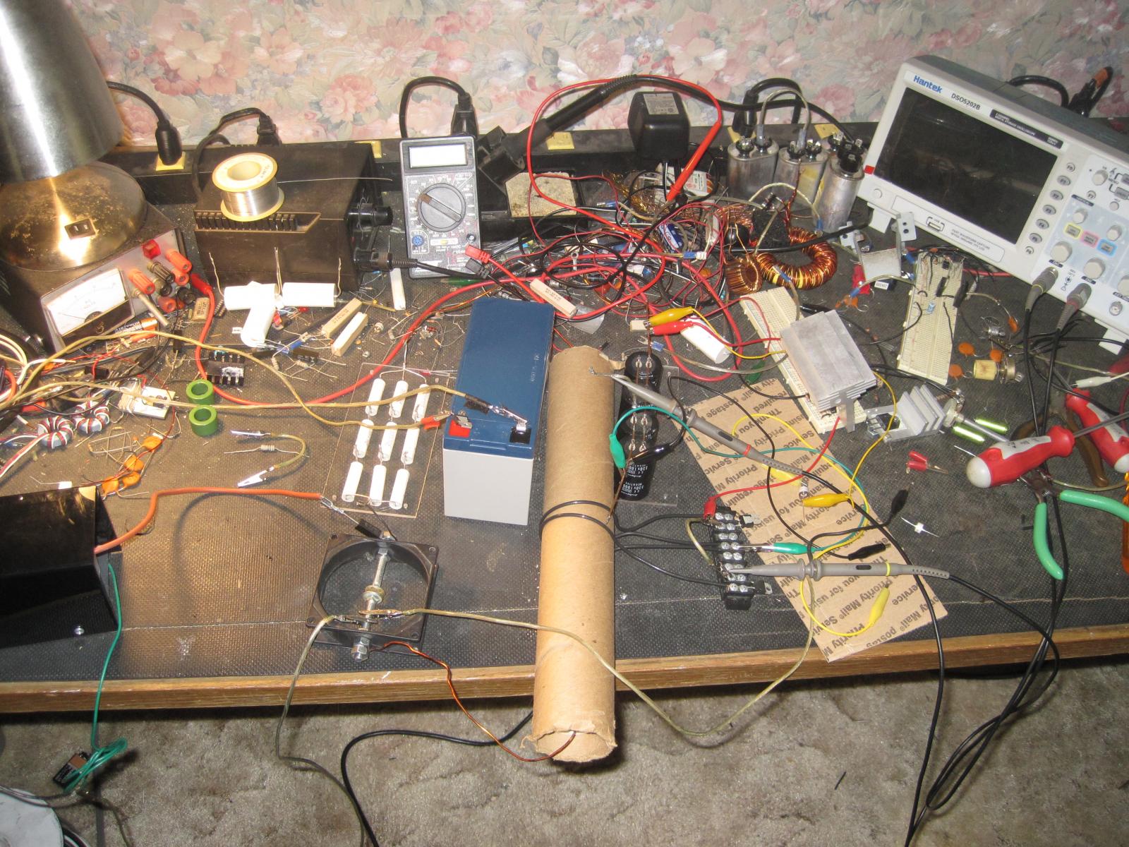

        OK, I just had something very strange happen. I was operating the circuit shown in the recent pictures, experimenting with the coil phasing and diode polarity as previously described. A few seconds after shutting off the power, I was reaching around the circuit and my hand accidentally brushed the center tap of the transformer primary and I got a significant shock. This was with the circuit OFF, and I waited some seconds for the cap to drain, as verified on the scope. This part of the circuit should have been at ground potential. None of my ground wires were loose, as verified by a visual check and then by operating the circuit again. I put the scope probe on this point of the circuit and verified that indeed it stays at ground potential except very briefly during each output pulse when the GDT fires. I have tried to see if it will happen again and I can't reproduce it either.
        BUT I AM QUITE SURE I GOT A SHOCK, and from a part of the circuit at GROUND POTENTIAL.... Has this ever happened to anyone else? Maybe there really is something to this voltage electron vs. current electron duality. I noticed that the part where I got the shock is geometrically in line with the Bloch wall plane of the dual output coils, so I experimented with putting the capacitor there too instead of close to the hot end of the coil. I still haven't observed any detectable difference in the (meager) output in any configuration I have tried so far.

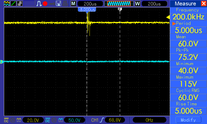

                      OK, I hope everyone will forgive me for using the forums as a lab notebook. It's good for a permanent record and this way everyone else can learn what I'm learning as I go along, and understand some of the engineering. In addition to the nonstandard overunity scalar electrodynamics happening in this device, there is plenty of good-old-fashioned Ohm's law engineering. Don's devices were efficient enough to run from a low power NST in most cases, probably just 10 or 20 watts of input. I think I would already have a working device if I had a really powerful NST to run it from, but one of my main goals for this project is to have a device that doesn't require specialty or expensive parts, materials, tools, or test equipment to build. A great many things can be scavenged: old TV's and microwaves are a plentiful source of donor parts for high voltage experiments.
                      Here is my latest test for power transfer. Back to the 13 turn coils, then rectified into a storage/smoothing cap bank (4000 uF in this case, but value not critical) then into a resistive load. Measured voltage across the load was 60V. The load was 2000 ohms, two 1K resistors in series. It takes a good 20 seconds for the voltage to climb and stabilize. I don't have any power resistors with this high a resistance and those little ones get good and warm in this brief time, so I can't leave this running very long or they will cook. Measured power is thus (applying V^2/R) about 1.8W. It is possible to get slightly more power from the PVM12 at lower frequencies, I'm running it here in sync with the coils at 62.5 KHz. Spreading the spark gap slightly also increases power input and thus power output. I used an 80mm computer fan housing for the spark gap, and it is possible to use one hand to squeeze it slightly while in operation to adjust the gap (without zapping yourself if you're careful).
                      I also tested spreading out the turns of the secondary coils to cover more of the coil form, but not only did this not help, it actually reduced power transfer slightly. Next test will be to wind some bigger secondary coils. To have some hope of running an inverter from the output, I need to have at least 4 or 5 watts from the secondary. Once I see that, I will begin designing the step-down stage.

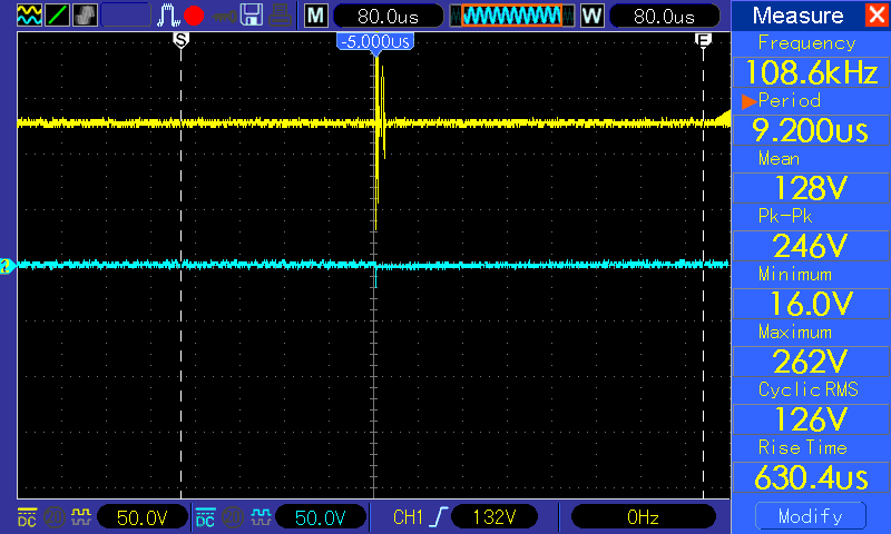

                        Well, it appears I can just barely reach 4 watts with this configuration. Secondary coils are 30 turns each, which brought a small improvement on its own. Load resistance now 4000 ohms to try and get a reasonable impedance match for maximum power transfer. By turning the PVM12 to a lower frequency once spark was established, I was able to reach 128V DC into the load, which is just over 4 watts. The spark gap won't light up initially unless the PVM12 is close to resonance, but once it's going it can be adjusted considerably. There is a limit beyond which the gap quits sparking and you have to return it to resonance to work again. The power from the PVM12 appears to be greater at lower frequencies, not sure why this is exactly.
                        Also, I did try a resonant cap on the previous secondary (13 turns), and the approximate capacitance to resonate it at 62.5 KHz was 400 nF, which I actually had a cap for. This produced a very slight but noticeable improvement in power transfer, so I need to try it with the 30 turn coil as well. Capacitance will probably be 100-150 nF, the tuning on the secondary is not sharp at all due to the load resistance. The Q is very low so the tuning is very broad, unlike the primary.
