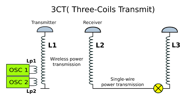

    Configuration with three coils without ground connection:
    It is interesting that this configuration is somewhat similar to Tesla’s version of wireless energy transmission shown in this picture:
