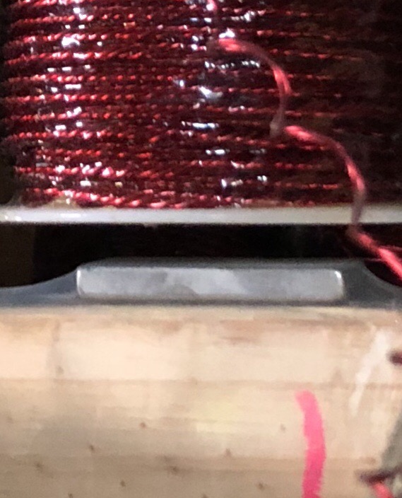

                        • Hello Skywatcher, my question to you, why is your gap from rotor to coil so wide?
                          If I may, my gaps on my large generator are the thickness of a paint stir stick.
                          It ran my house’s power.
                          The neos are n52 and mounted on previously set weaker ceramic 8 on pine wood glued and heat shrink tubing three times to keep magnets in place.

                                Here is what I found out on the bench. A 1" long magnet 1/2" thick
                                without a shield will result in a longer reach than the magnet to core
                                side. With the shield installed that is 1/16" iron the pounding due to
                                imbalance is greatly reduced.
                                All I have to go on is what I am trying. The diagram explains how a
                                shielded (Or semi shielded magnet say 90%) field is pinched off on the
                                outside and pushed out front.
                                During experiments I was able to create a much better balance than
                                without shields. In fact i was completely unable to get even close to
                                a balance without shields, that is what got me thinking, so I tried it.
                                If you have a shield on a magnet all or 90+ % on the field interaction
                                is out front of it. My core would not be in contact with the magnet at
                                all while the opposite side where both north pole are were very reactive.
                                Very little balance without shields, it helps but not as much.
                                Jordan and i will show you our demo coming up.
                                We are not trying to shield to the ""N"th Degree" which is virtually
                                impossible. Unless you try it with a long magnet you wouldn't know.
                                The diagram is incomplete, all magnets must have a shield. Remember
                                that my rotor is plastic and magnets just sit on top of it?
                                Using only a single shielded magnet (No shields on the rotor) for
                                counterbalancing improved the system tremendously. Less pounding.
