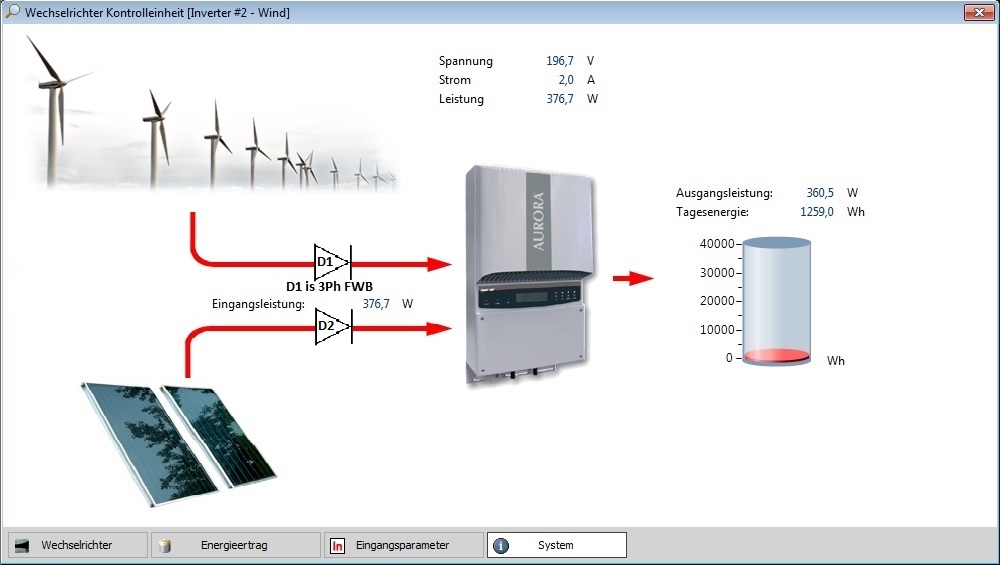

I have Solar Panels powering the lines in on the Inverter max. 220VDC. + Blocking Diode.
On the same Line the Rectified Voltage from VAWT.
The Inverter is a Wind Inverter PVI 3.0 OUTD-W. So no issues.

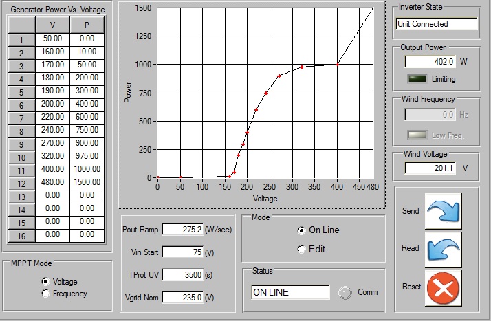

When the Sun is gone. The VAWT has issues starting up, because of the initial Inverter start-up. Is about 50VDC @5% there of.

But at the moment, the Inverter cuts in too soon, to Power up; that is. The Inverter does not dump a load to the
Grid before ~160VDC.

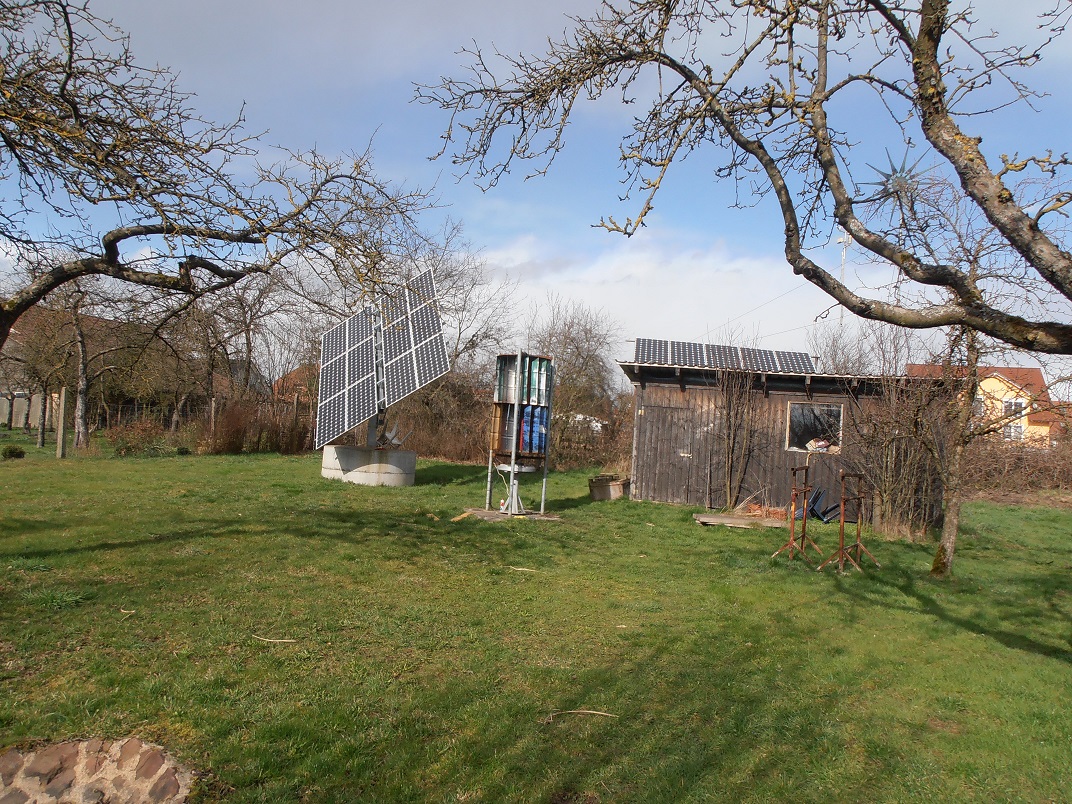

Attached is a general Graphic of what I have. As well a Pic.
The other Graphic is the load curve that functions quite well. When the darn thing is already running.
