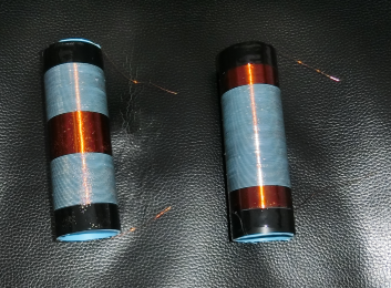

                    Last sentence on page 2:
                    The function Ph1() can be used to directly estimate the quarter wave Fres from the h/d ratio and the wirelength:=
                    Fres = (0.39 * ln(h/d) + 1.19) * 75e6 / wire_length (Hertz)
                    He does also say that the coils used are all "fairly close wound", but my experience shows that this is not a factor of importance.
                    Also read Tesla's patent on that bifilar coil claim 1:
                    A coil for electric apparatus the adjacent convolutions of which form parts of the circuit between which there exists a potential difference sufficient to secure in the coil a capacity capable of neutralizing its self-induction, as hereinbefore described.
                    You can agree or disagree, but maybe you should do a test to verify it?
                    I have also tested with coils that are not evenly wound, having a tight winding where capacitance is effective and a less tight winding where induction is effective, or the other way around. See attached picture.
                    This actually does affect the resonance frequency (by 13%).
                    Well, as I said, the only way to convince anyone is by putting it to the test!
                    (I have not tested with flat wire, because that is too difficult to wind on a cylindrical coil)
                    Ernst.
