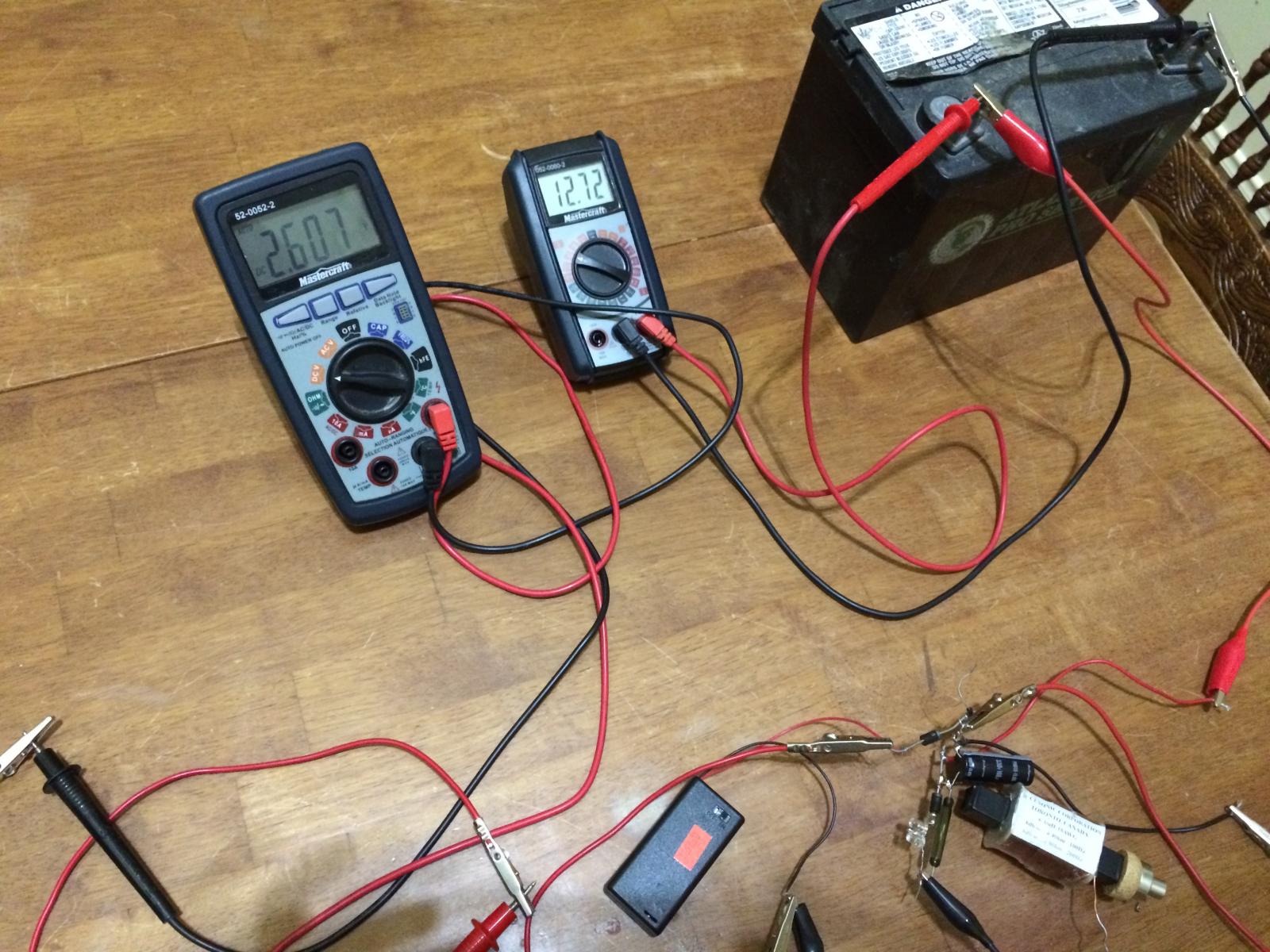

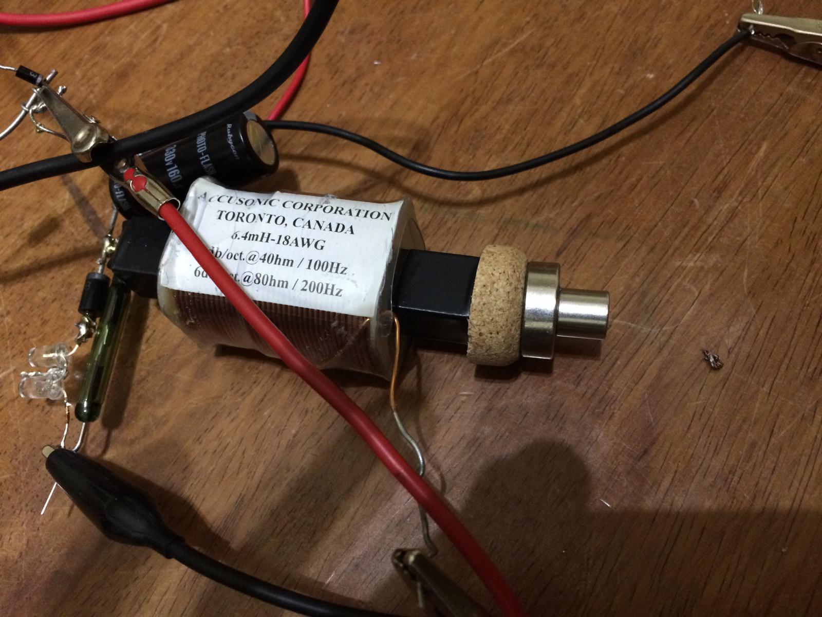

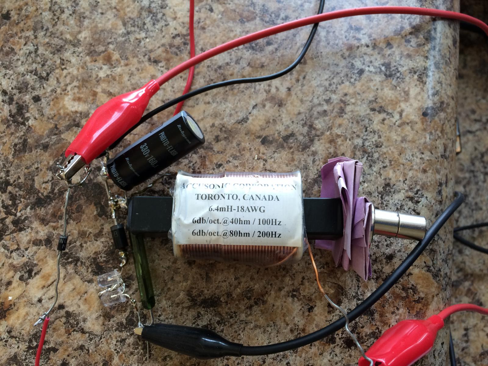

Wow! Really looks awesome. Thanks for showing it. You added some impressive heavy copper, 18 AWG. Does it work? How many volts are you using? I bet that coil would spin a neo sphere.
It would be a simple matter to calculate the resonant frequency if you can read the farads off the capacitor, along with the Ohms of the coil.Last edited by Allen Burgess; 03-21-2016, 10:51 PM.
Hi Allen!Originally posted by Allen Burgess View Post@Wistiti,

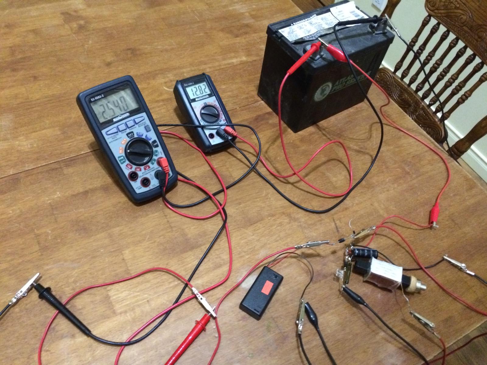

I use 2xaa battery as the source. My cap is a 160uf photo flash capacitor. The resistance of the coil is 0,8ohm.
I use a gap betwin the magnet and the steel core to start it and adjust the frequency...
But as we already know; battery may act really strange... The only thing i can say for sure is this little circuit merit to be construct and explore furter more...
It produce real power.
Hope someone else will build it and share is result...

It appears you're charging a 12 volt battery from a pair of AA batteries. That's a pretty cool trick!
I need to apologize about the formula for "Resonant Frequency" I outlined by mistake: Inductance in Henries, along with "Farads of Capacitance" are the factors needed to calculate resonant frequency, not Ohms of resistance. Your adjustable magnet gap changes and regulates the coil's "inductance", thereby controlling the frequency. Very nice setup, thanks for the contribution.Last edited by Allen Burgess; 03-22-2016, 10:47 PM.
Permanent magnet and coil inductance
"Incidentally, because all magnetic materials are eventually nonlinear, an increase in static magnetic field can reduce the inductance of a permeable-cored inductor. In fact, this property has been used for years, between saturable reactors, magnetic amplifiers and other very interesting devices".
Reducing the magnet gap space reduces the inductance of the coil; Reducing the inductance of the coil raises the resonant frequency of the LC tank: So, narrowing the magnet gap increases the operating frequency, and widening it slows it down!Last edited by Allen Burgess; 03-22-2016, 02:23 PM.
