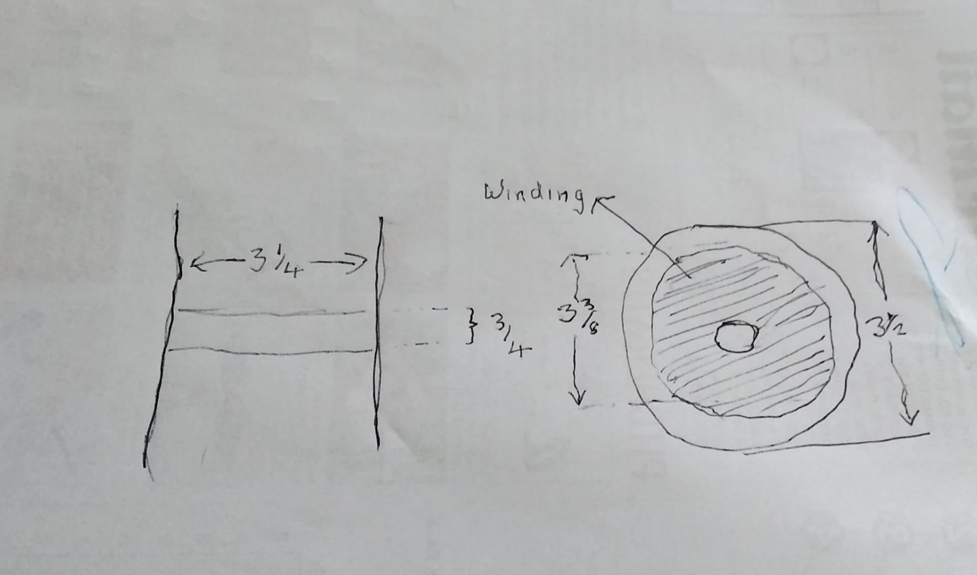

                    • Another couple of things that I need for calculations are the diameter of the opening of the coil (air/iron/ferrite area), the length of the coil and outside diameter of the coil (measured at the outer copper windings, not the bobbin). Not sure if you remember how many turns you have on the coil, but if not, I can estimate based on those dimensions and the wire length.
                      Also, I think you mentioned that you are use N52 magnets, correct?
                      • Area of core 3/4" x 3 1/4
                        Diameter of wire 3 3/8 x 3 1/8 (minus core)
                        Yes, N52 magnets
                        • Is this something like?

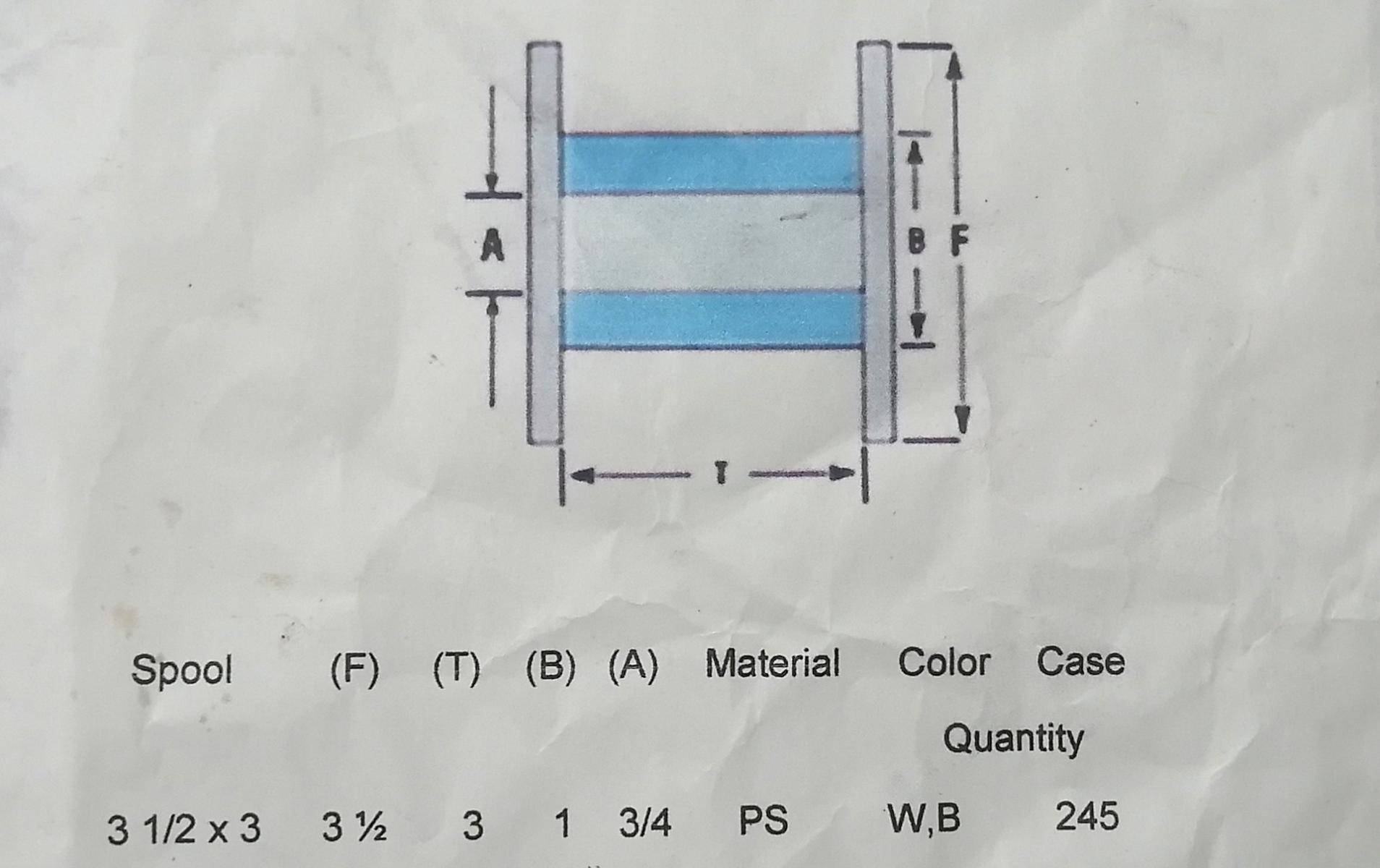

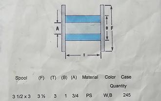

ID:	504581 Here are the spool measurements for the coil
                            • Alex,
                              where did you get that. I lost my bookmark to where I ordered them from and my friend who is building these machines needs to order more bobbins. I’m OuT! I bought a CASE last time, so that shows you how many coils I have wound for the various versions I have built.

                              • Alex, thank you for that, if you have time could you please say the diameter of a finished coil.
