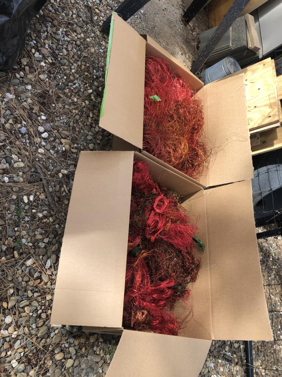

    $3.45 per pound for copper at the scrap yard so it looks like $100 box to me from here

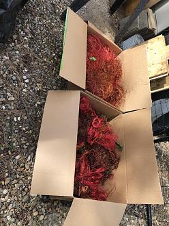

    In case you thought I was kidding about the number of coils that have “died”’on the bench since I started working on this generator stuff. Many $1,000 worth. Boxes are 31” long by 21”’deep by 11” high x2Click image for larger version  Name:	195C966F-29E8-4528-B8FD-BCAACAA71585.jpeg Views:	0 Size:	237.2 KB ID:	509553
