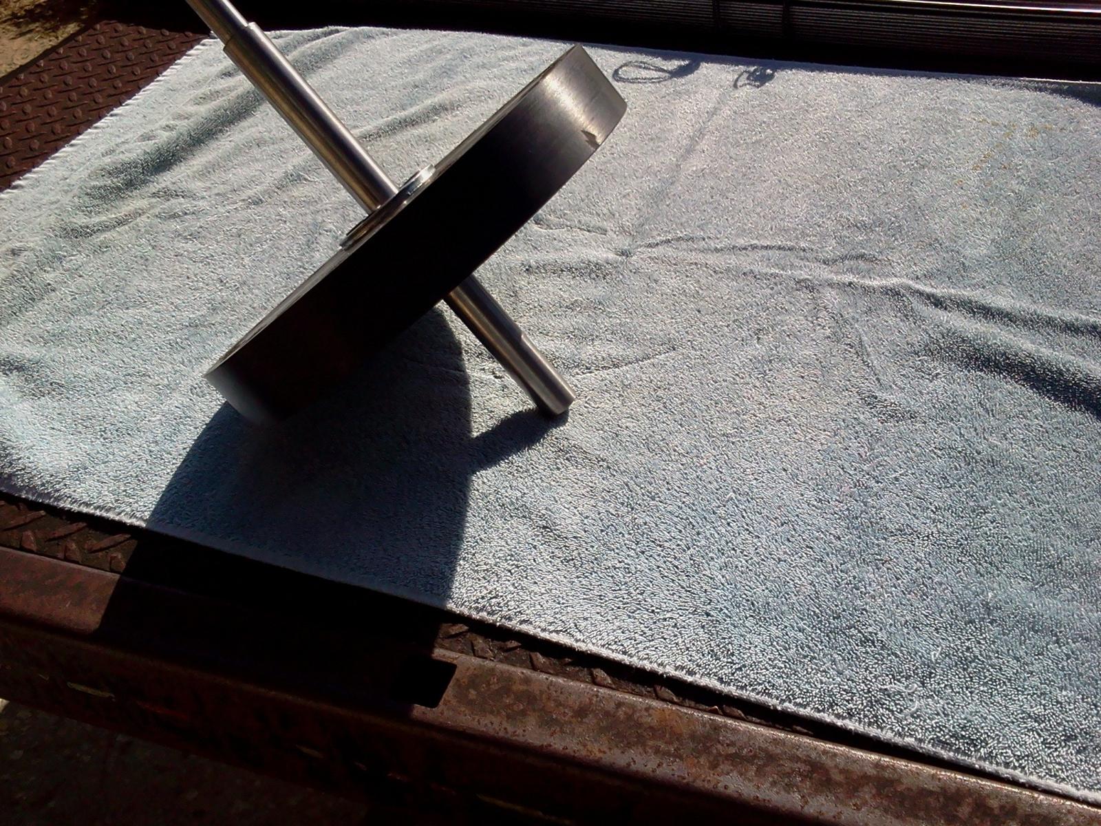

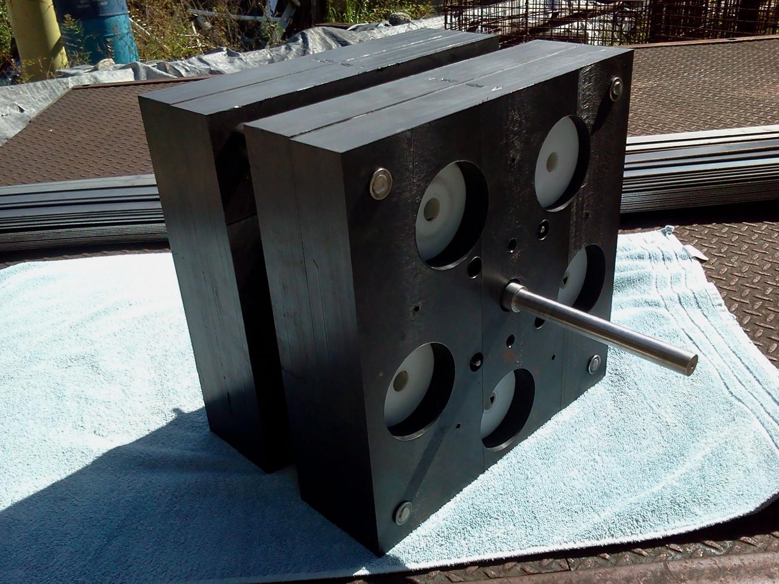

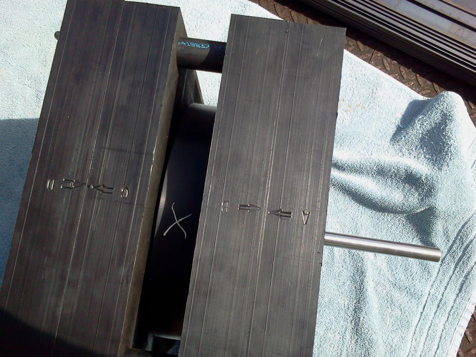

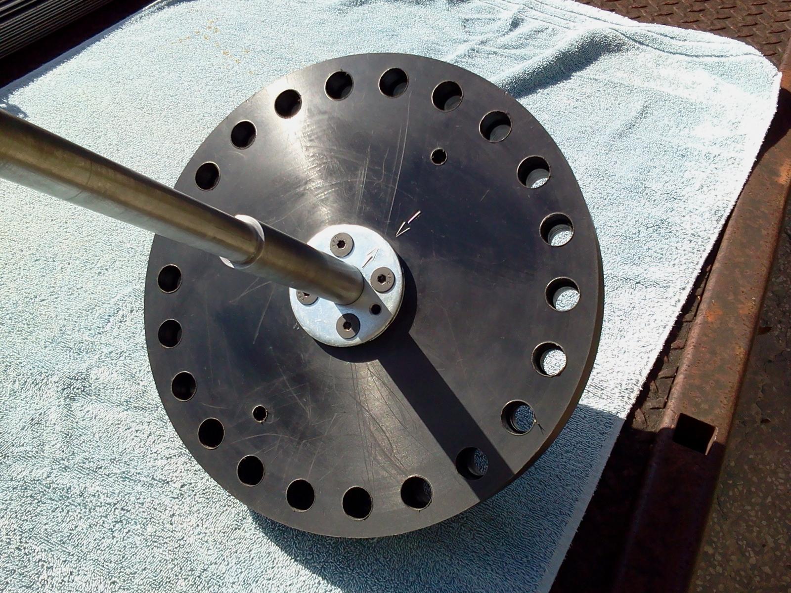

    The other individual who is in CA and is adding repulsion magnets to his existing build has been too busy with actual WORK to make any progress, but he will keep me posted. The third individual who is replicating the generator and building one for me at the same time sent the following pictures this last week:

    Bro, you can use aluminum for the rotors, but you need something strong and non-magnetic to make the coil holders out of. Garalite might work for that, and we may give it a try one day soon. But with equal attraction of the rotor magnets in both directions because of coils on both sides of the rotor, and magnetic repulsion equal because of repulsion magnets on both sides of the rotor, most of the stresses I was running into have been eliminated. By having the rotor shaft larger between the bearings, we eliminated the ability of the shaft to move from side to side because of a nut coming loose, so the major stress point is where the rotor is attached to the shaft, and we went up to a 1" diameter shaft.

      Now they are using new materials and the motor shaft was changed for a 1 "one, well it supports more effort
      The rotor that you show are 22 repulsors, is that right?

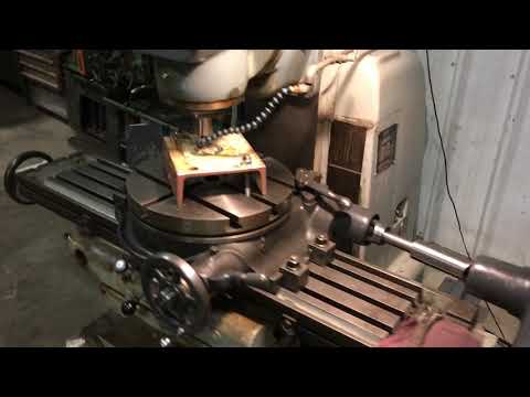

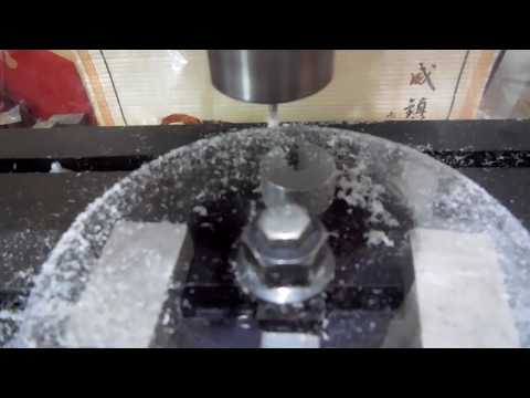

        • Here we are witnessing a standard milling, which is about 2000 pounds with a rotary table cutting in circles. At this time the rotary table is connected to the feed on the mill. Turning the rotary table by hand is another video.
          If you are cutting circles with a tablesaw or drill press lathe, remember that the "run out" is anywhere from 50 thousandths or more or less. "RUN OUT" is all about the wobble in the cutting device. With a regular mill "run out" is less than 1/2 a thousandths and could be 1/10th.

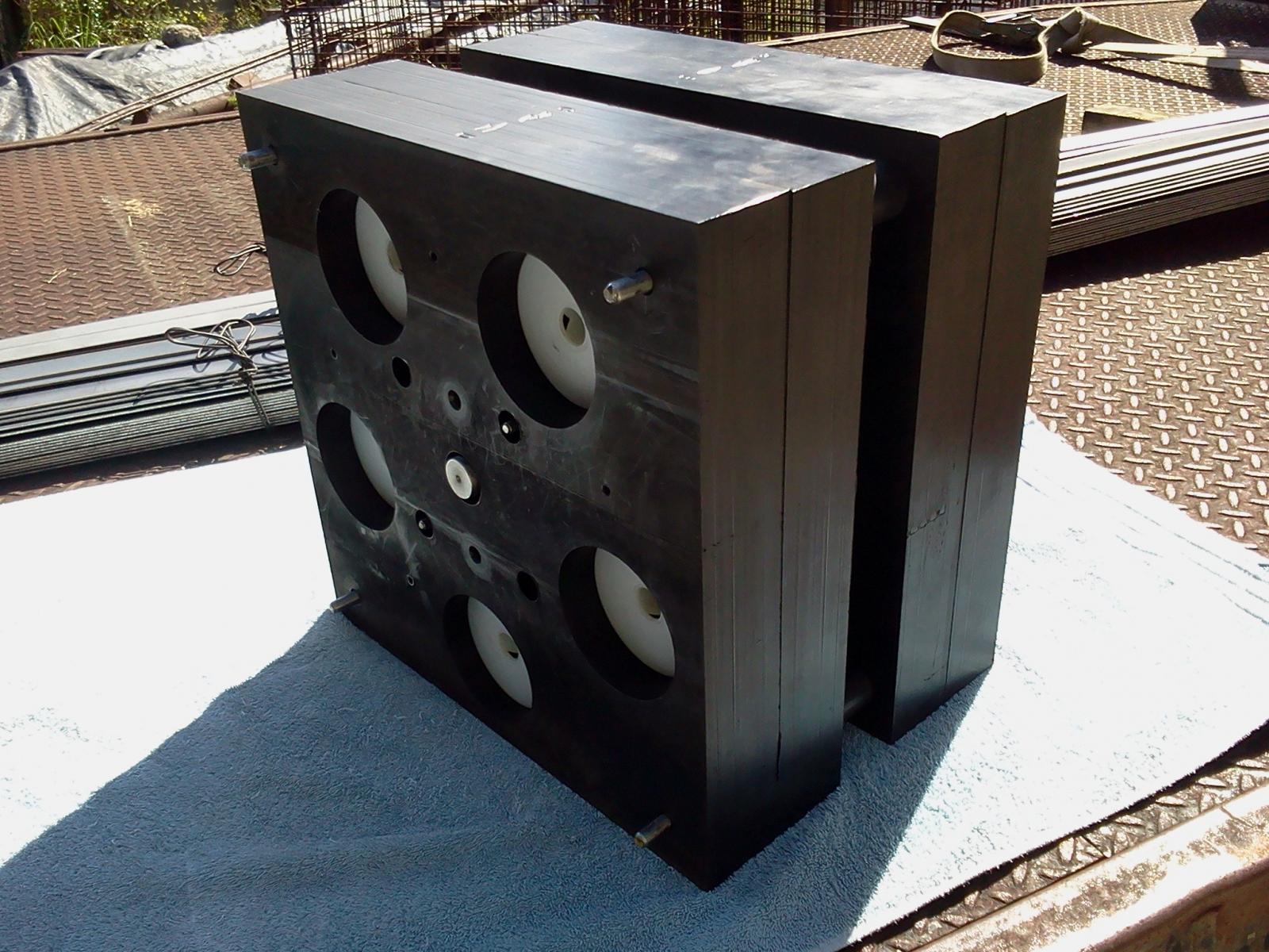

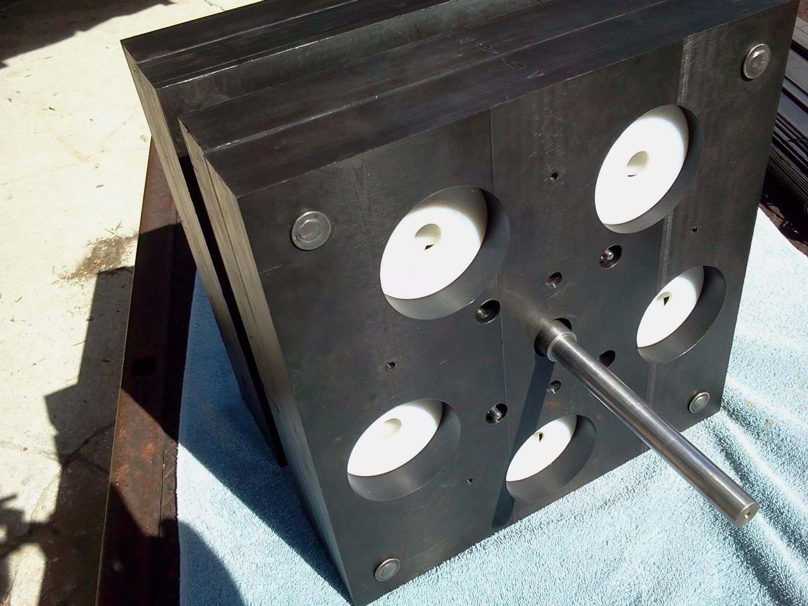

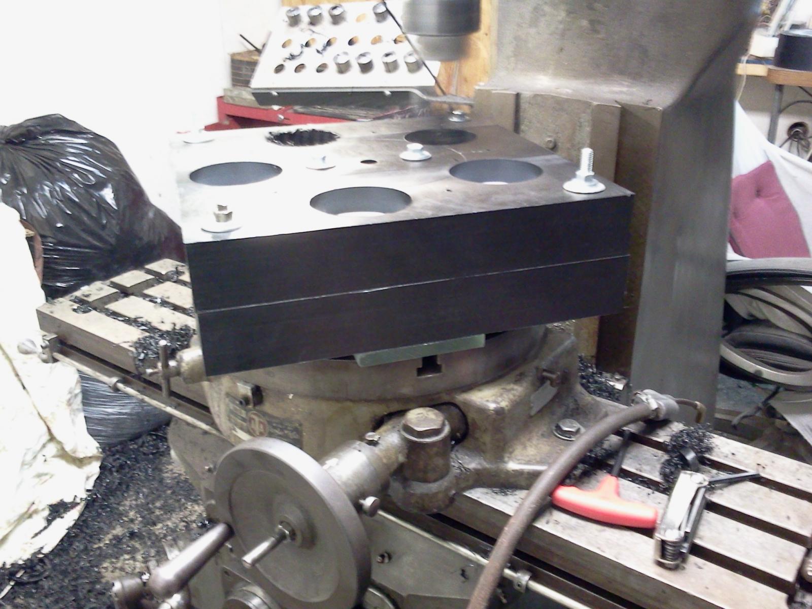

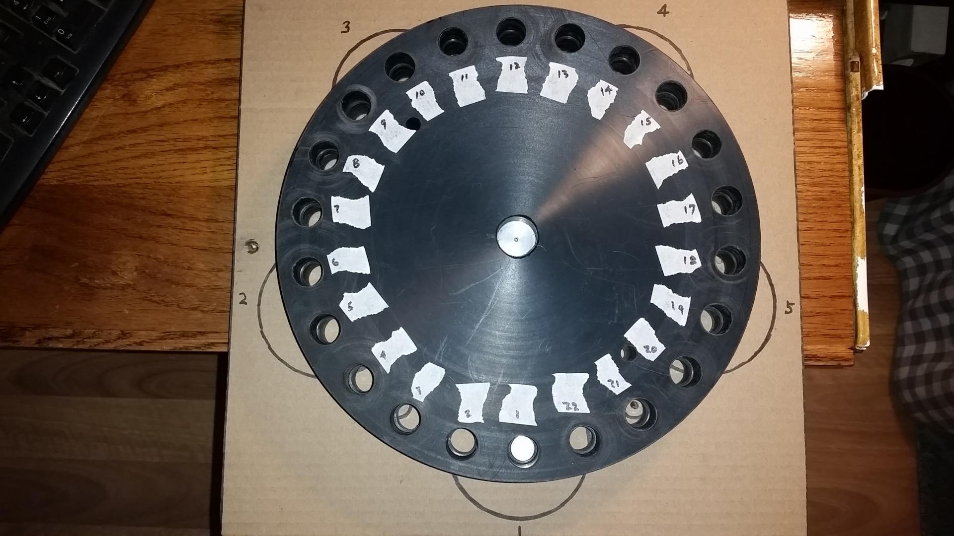

ID:	501023My buddy will be shipping me all the parts to put this thing together sometime in the next week or so. And he will have one also. The differences between it and my current machines will be that the rotor contains almost twice as many magnets, which are 3/4 thick instead of 1/2 inch thick. More mass means more flux, at least up to the point where the core becomes saturated. The coil cores will be ferrite rather than iron. It also only holds 10 coils instead of 12, but only TWO coils at a time align to the rotor magnets, so it requires much less input to turn the rotor. If you have followed along, it STILL requires amps to turn the rotor, but maybe if this build is more accurate, those requirements will diminish. One of the cool things about THIS build is that the adjustment of the opposition magnets, which was a painful process on the big machine at Greyland's shop, has much finer control, far less PLAY, and is therefore far more accurate. I'm VERY excited about THAT. Also, the bearings are built right into the coil holders, so far less distance between them. My intention with this machine is to change the wiring scheme to see if I can get the amperage up and the voltage down while still maintaining speed up under load. I would like an output of 30-50 volts AC, with more amps. I can control that with either a step down transformer and then convert to DC or convert directly to DC and then buck down to a lower DC voltage. The range of DC to DC buck modules has a high end limit as far as I can tell. I haven't found one that will deal with over 120 volts DC. Anyway, that's the update.
