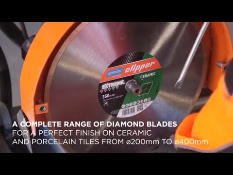

  • Remember all ceramics such as ferrite magnets are going to crack if coolant is not used during the cutting , grinding and polishing process. See the huge glass sheet and the water?

      • Here is a piece of Ferrite properly cut. Diamond blades ( 2 thousandths thick) plus coolant All these are well within reach. See the finish cut of ceramic iron

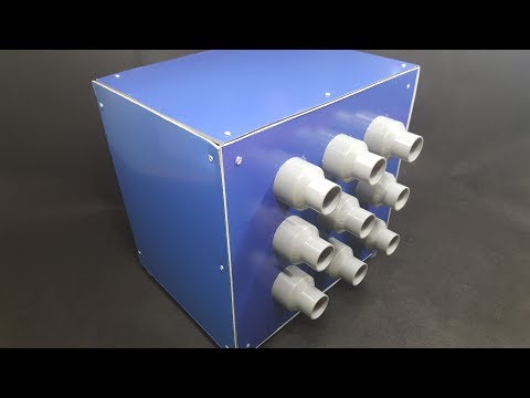

                          • Powered version cooler. Using water is even better.
                            I lower my shop from 101-78 on hot days using a fan and water mist.
                            This one works by compression just like all refrigeration cycles.
