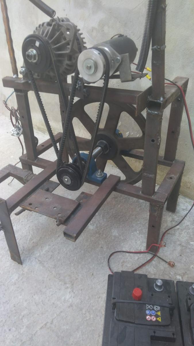

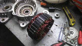

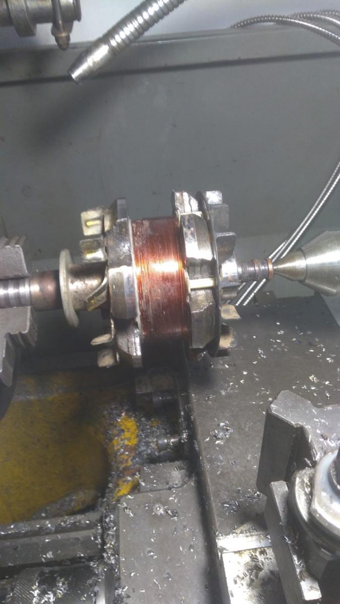

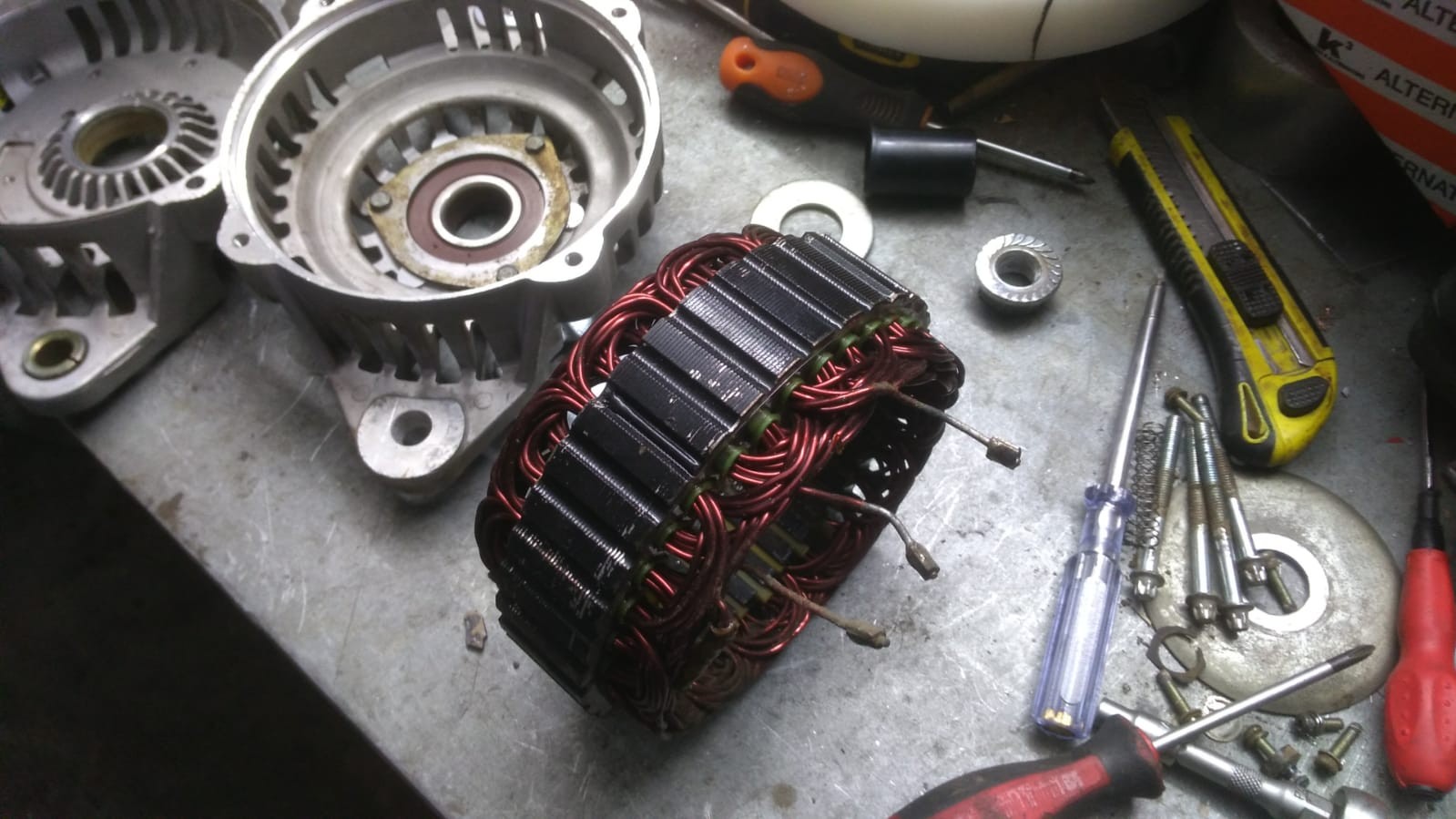

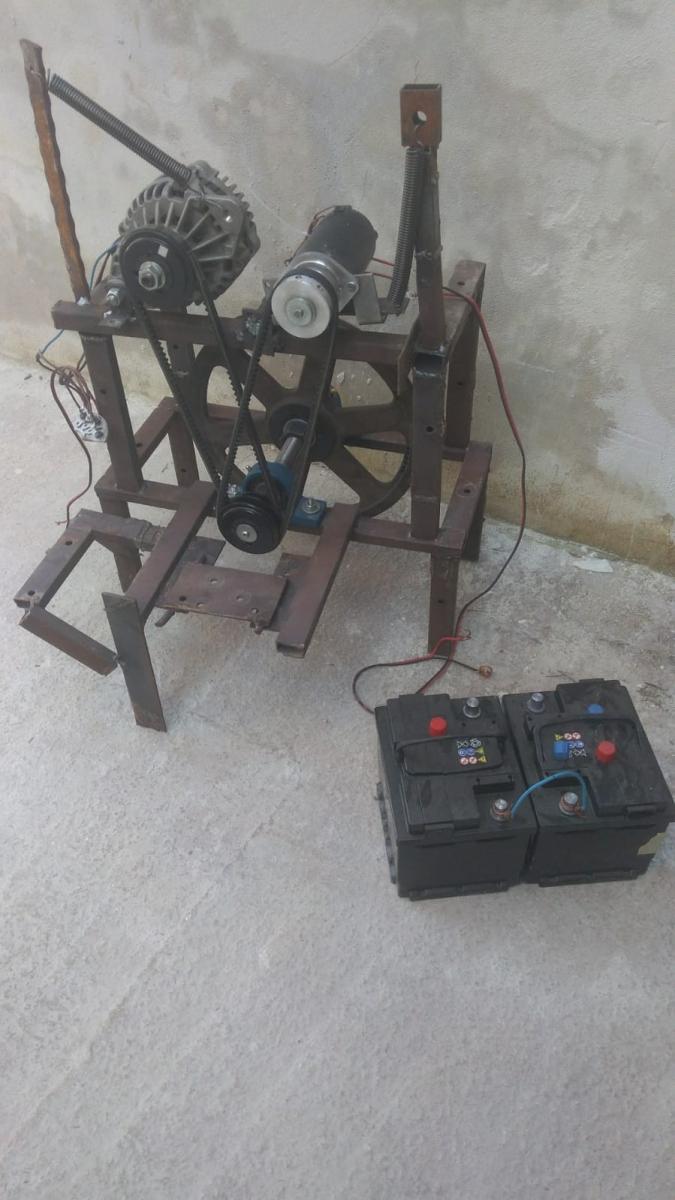

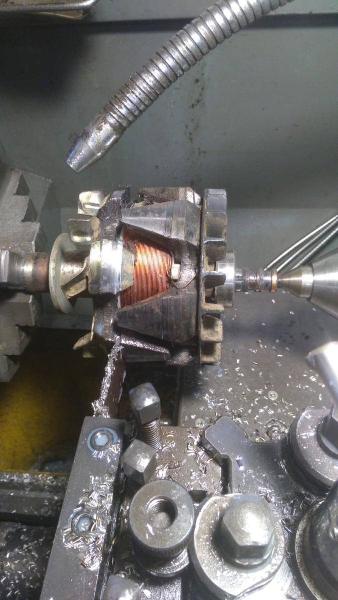

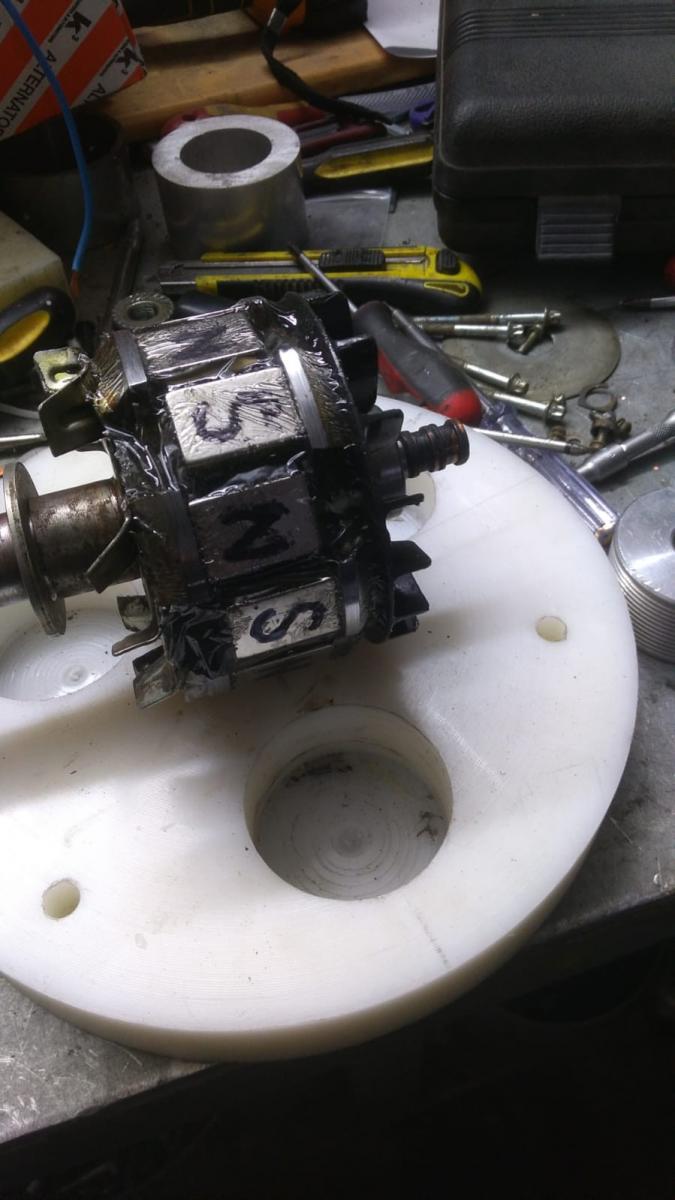

ID:	510175 no, I don't convert an alternator into a motor, I just modified the motor to avoid it using a part of current to produce the magnetic field of the rotor, now I will try to post the photos.this is the rotor I modified
ID:	510178 this is the machine, of course being a test I didn't waste too much time to look after the appearance and I used recycled materials, so don't pay attention if the structure seems a bit strange, the important thing is that it absolves me well task. Now I would need a scheme for powering the engine at short adjustable periods to find the best combination to give the flywheel enough momentum and keep the batteries charged. Click image for larger version

                      • Mikey what you see disassembled is the three-phase 24v alternator of a bulldozer to which I replaced the rotor winding with magnets (so I also eliminated the brushes and the control circuit, now the output varies according to the speed of rotation, at 2500 rpm it takes out 42V.) The motor is the black one you see mounted in the photos on the right, it is a 24V, 500watt direct current.Now I need to power that pulse engine.Thanks always for the help.
