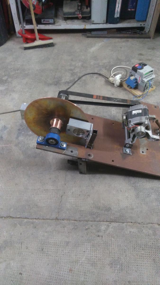

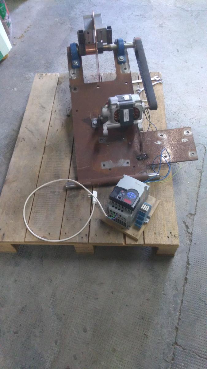

I also tried to spin only the copper disc, putting a single pair of fixed magnets, on aluminum supports, but the motor is not there because an excessive braking force is generated, obviously a Lenz reaction is generated. even at very low revolutions, trying to rotate the disc with your hands you feel a strong resistance. I also tried to offset the magnets, but there is always resistance, even if a little less.

Yep, with those set-ups you make an eddy current brake. To get the unipolar (or homopolar) DC generator you need a 'uniform' magnetic field covering the entire disc area.
Thanks Bistander, ... so to work the homopolar generator the magnets must remain fixed or turn with the copper disk? ... I saw that in the De Palma experiment the machine built by them had the magnets on the rotor together with the disk of copper, and they were all spinning together, and that's what I tried to replicate but without useful results, nothing to do with the De Palma generator.There are 4 brushes for each pole, of the carbon type which are used for electric wheels measuring 16x6mm.Last edited by Memphis; 12-30-2021, 06:26 PM.
" so to work the homopolar generator the magnets must remain fixed or turn with the copper disk?"Originally posted by Memphis View PostThanks Bistander, ... so to work the homopolar generator the magnets must remain fixed or turn with the copper disk? ... I saw that in the De Palma experiment the machine built by them had the magnets on the rotor together with the disk of copper, and they were all spinning together, and that's what I tried to replicate but without useful results, nothing to do with the De Palma generator.There are 4 brushes for each pole, of the carbon type which are used for electric wheels measuring 16x6mm.
Yes.
First you need to generate voltage. Requires complete flux coverage, uniform and unidirectional, over copper disc.
To get high current, you need very low resistance electric circuit. Carbon brushes offer too high resistance. Use very low resistance everywhere. Brushes especially. Try straight copper metal at first. Will be low resistance but poor wear. Once working look into high copper content metal graphite brushes.
