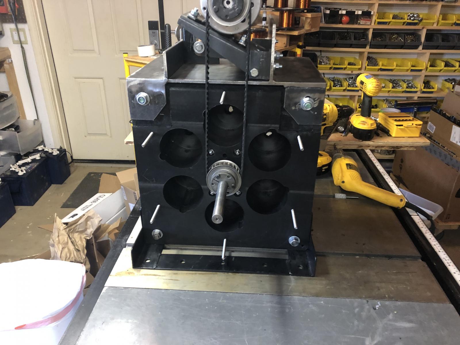

      • Got the Beast together and the motor mounted. The bolt holes in the frame don’t quite line up so I need MORE time to deal with that and I’m not in the mood. Only have an hour to work before I am done for the day, so will see how much of my light board I can get rewired. Might get some time this evening, but not likely.

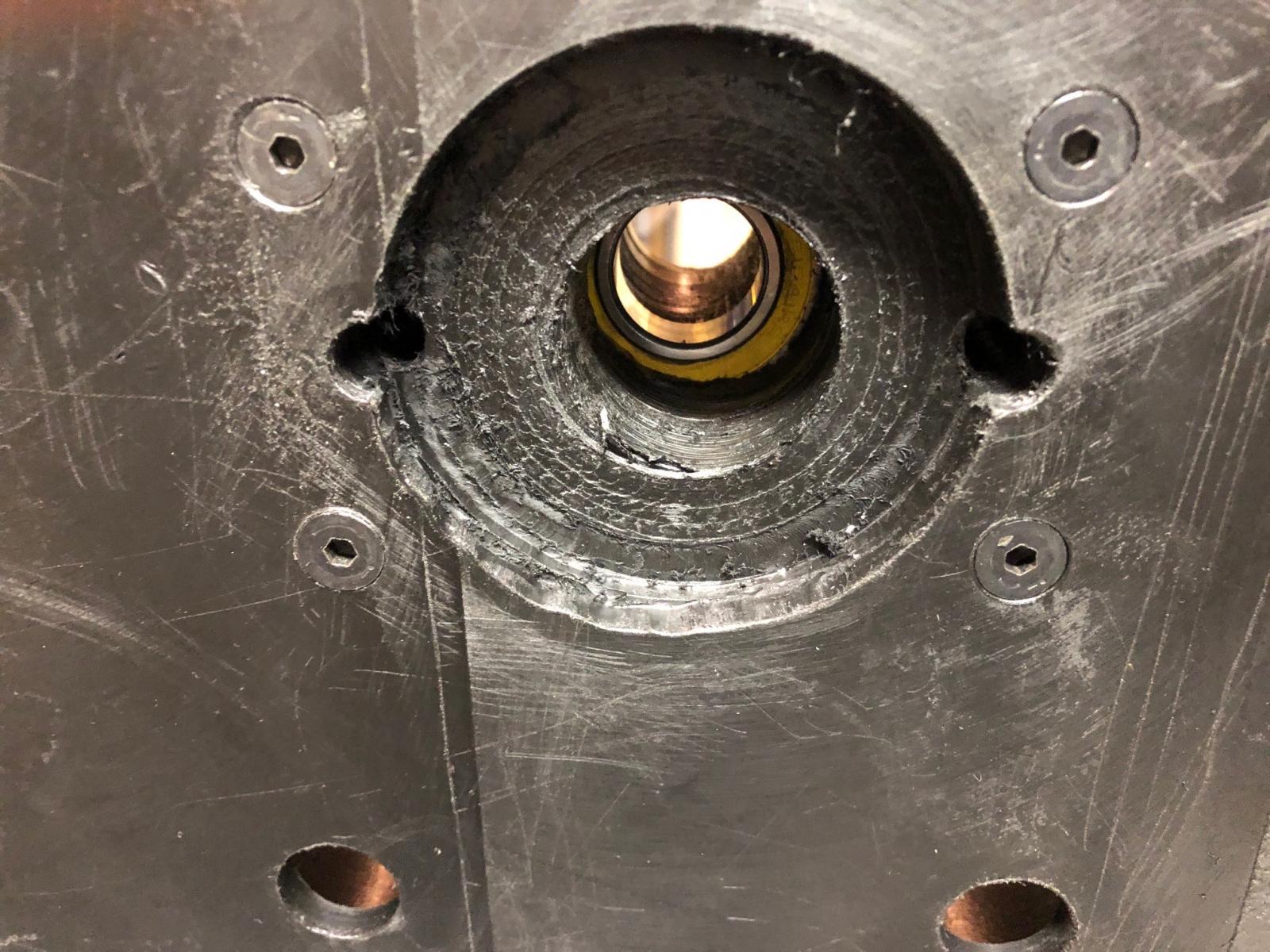

                • The motor was pulling well over 15 amps to turn the rotor, and when I disconnected the belt drive, the shaft was hard to turn by hand. With all the bolts loosened, the shaft turns with MINIMAL effort, but with everything tightened down, it does not turn properly, so somewhere something is in a bind. The coils came this morning and we spent a couple hours trying to figure out what is binding where. No luck. So this evening I disassembled EVERYTHING and just clamped all the pieces of the coil holders together with the bearings in place to make sure the center hole was in alignment all the way through. It is as far as I can tell. At least it the rotor shaft slid all the way through and fits into both bearings, and turns. Not as freely as when everything was loose, but not as tight as when everything was bolted together, so I need to look for where the shaft is rubbing on plastic and see if there is anything I can do to solve that problem. I have a few more things to try before I just give up and take it to a local machinist to see if they can solve it. If one of the two bearings isn't sitting flat against the case like it should be, that could be the problem. Almost impossible for me to tell. Tomorrow is another day.
                  • Hi Turion, it could be that the shaft is straight and the bearing housing is aligned, but when you tighten the rotor or stator walls they touch on the outer circle of the bearings, you have tried to insert thin washers on the shaft from both sides bearings?
                    • I tried all kinds of stuff today, and I MAY have figured it out. In the attached photo you can see a large countersunk hole that the circular metal plate on the rotor would recess into, allowing the rotor to be closer to the coil holder. For WHATEVER reason, when the rotor turned, the plate on the rotor would rub against the wall of this circular opening during about half of its rotation. I have no idea why. Also, there are four Allen wrench bolts shown in the picture. They secure the two halves of one side of the the coil holders together in the middle, and "clamp" the bearing in place that fits in a compartment between the two halves. I didn't realize that if I tightened those four bolts TOO tight, it would clamp the bearing and not allow it to turn, even though the center race on the bearing is not being clamped.
                      Unfortunately, I took the rotor off the shaft yesterday, believing I would need to have the shaft checked for straightness. Doesn't look like it needs to be, but since I put it together with lock tight, I need to let the bolts soak in acetone for a while before wire brushing them and reapplying lock tight to reassemble it. So, tomorrow is another day.

                      • Still have wires to strip and holes to drill and tap to bolt the coil holders in place, but I will get the RPM meter set up tonight or tomorrow and can start loading coils into the machine and adjusting it. I was incredibly happy to see 26 volts and 4.4 amps as the unloaded input of the machine. All my calculations have been based on 7 or 8 amps input. I don’t know if it was at 2800 RPM so it may cost me more than that. But it was exciting for me to finally have it (the NEW version) running on the bench.

                          • So, lots of things done today. The RPM meter is all set up running on a separate power supply. Although I had to take it APART again because of some issues that it was in the way of working on. The RPM of the machine was about 1500 RPM with the input I had yesterday. It took me 30.2 volts at 8.7 amps to get the RPM up to 2800 RPM, and that is unacceptable.
                            I'm going to have to change the gears. So I took the gear off the motor and the one off the generator shaft and I will go to Sacramento either tomorrow or Tuesday to see what I can find. Probably call a couple places tomorrow and figure out a plan. Maybe a bigger gear for the motor or a smaller gear for the generator shaft, or both. Got the whole unit moved over to the rolling cart that will remain its home for the foreseeable future and I can reclaim my table saw for other purposes.
                            All the coil bobbins have to be slightly sanded to get them to slide into the holder correctly. The two end pieces of each bobbin have a sharp edge on them, and that needs to be blunted. Just takes time. Also, all the 3/4" holes in the machine at the center of each coil holder need to be sanded, and I am working on that, one hole at a time, as I prepare each coil and fit it into the machine. The metal that sticks out of the coil 1/4" to fit closer to the magnet needs to be filed, and I have a whole process for that. The video of what I worked on today is below.
