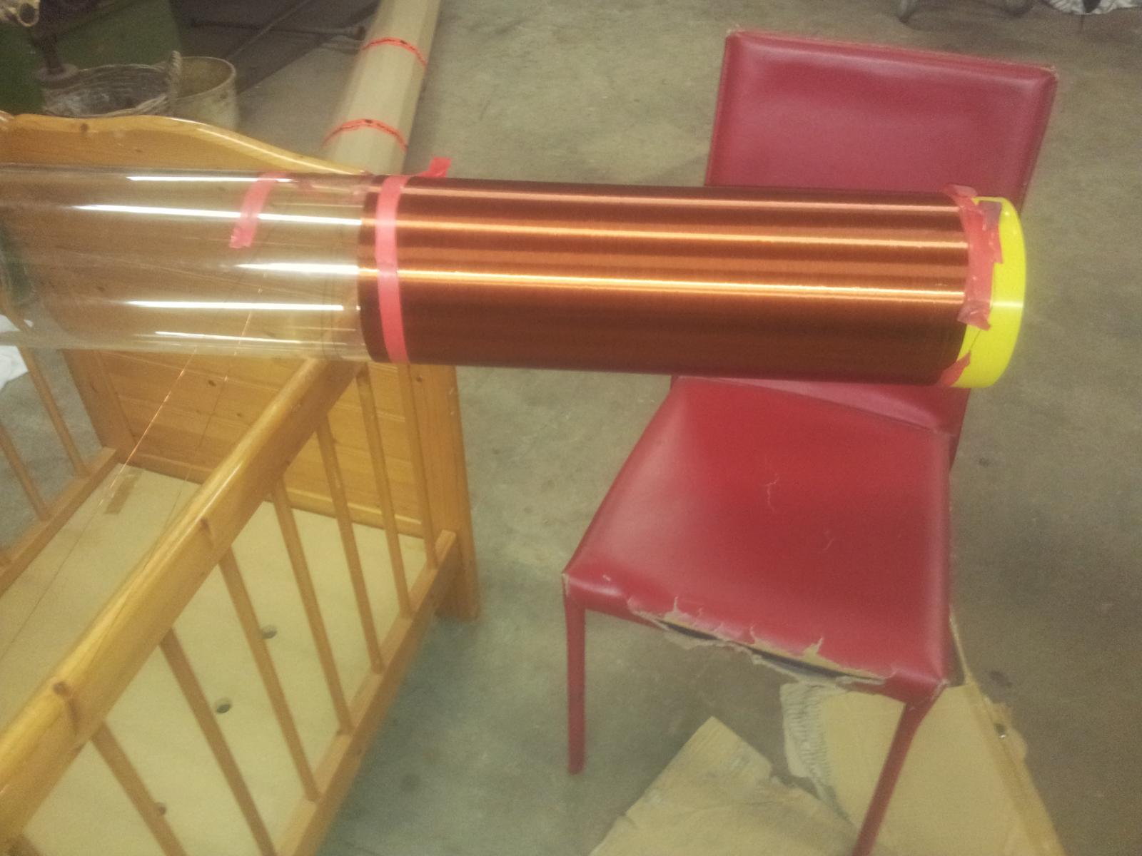

    This is the bifilar CCW total of 530Mx2 (bifilar), still need to finish winding.
    According to Helical Coil Calculator we get an aprox of 1880 turns on 95.8 CM pipe.

            Okay bi-filar coil is winded.
            Tomorrow I go tighten it up by hand and even/straight it all out.

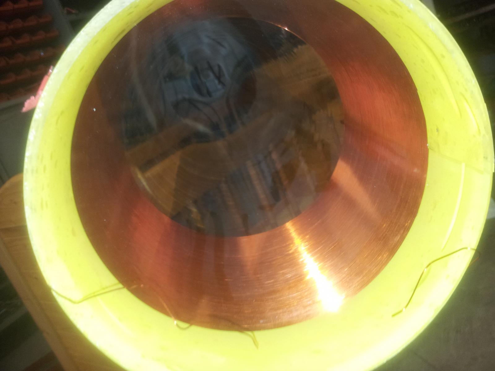

            Someplace its wounded to tight that it pushes itself out while onstart its winded to loose.
            Getting 107 CM windings instead of the expected 93.8 CM.
            Image of the coil

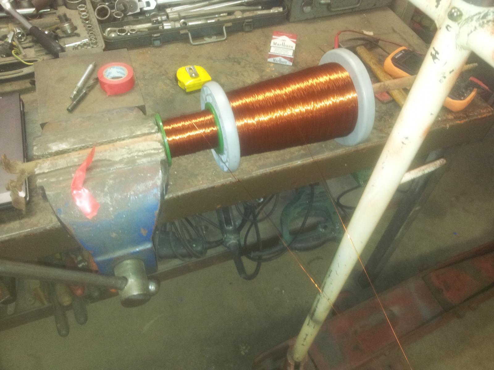

                After removing the insulation I was breaking my head why the OHM
                meter was passing through but not beeping.
                It was obv due to much resistance. According to resistance table 23/24 AWG the restiance is atleast over 30 OHM on 500 meters.
                I probably reduce the size of the coil, and upcoming coil due the fact I can't move the winding properly and have few CM short of acrylic pipe (which costed 140 euro's) and everything ****s up. Wasted 3 hours today and gained a lot of stress.
