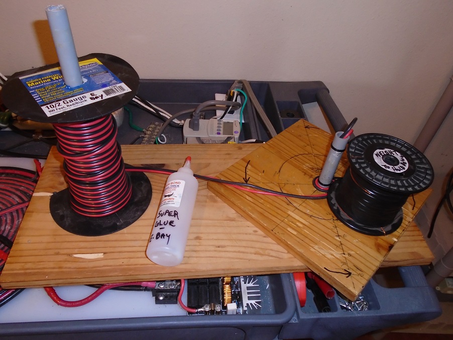

                            Hello BroMikey,
                            missed that I guess? The new and old TPC coil takes 25 feet of black and 25 feet of red # 6 AWG tinned stranded battey cable. I get mine on line at
                            Pacer Group - Marine Wire, Battery Cable and Electrical Parts. pull it up on your search and you can navigate around their site until you get used to it and then go to the section on battery cable
                            and check it out. not really hard to get used to their system. they ship and charge for shipping. most all places do!
                            Also the Red and Black #10 AWG Parallel wire that you see in the attached photo I use for all the TBC coils comes from E-Bay.Com. I order that from them and also the Hyperbond SuperGlue Medium Flex too!
                            I don't give out info on numbers of turns and such - up to everybody to use their eyes and count. the photos are quite clear! you will need a lot of super glue as you go. make a few turns and keep it tight and weighted down and NO gaps between turns before you spread super glue between wires. then let dry and get after it again till through.
                            It IS a real pisser to get it complete for sure! like breathing, just keep doing it! I showed a photo of the type of jig I made for flat coil winding awhile back. I works damn good too!
                            I put the finishing touches on my added Dipole TPC this afternoon. will take another day or two to finish for install and then run for a good while for results.
                            all for now.
                            respects,
                            Clarence
