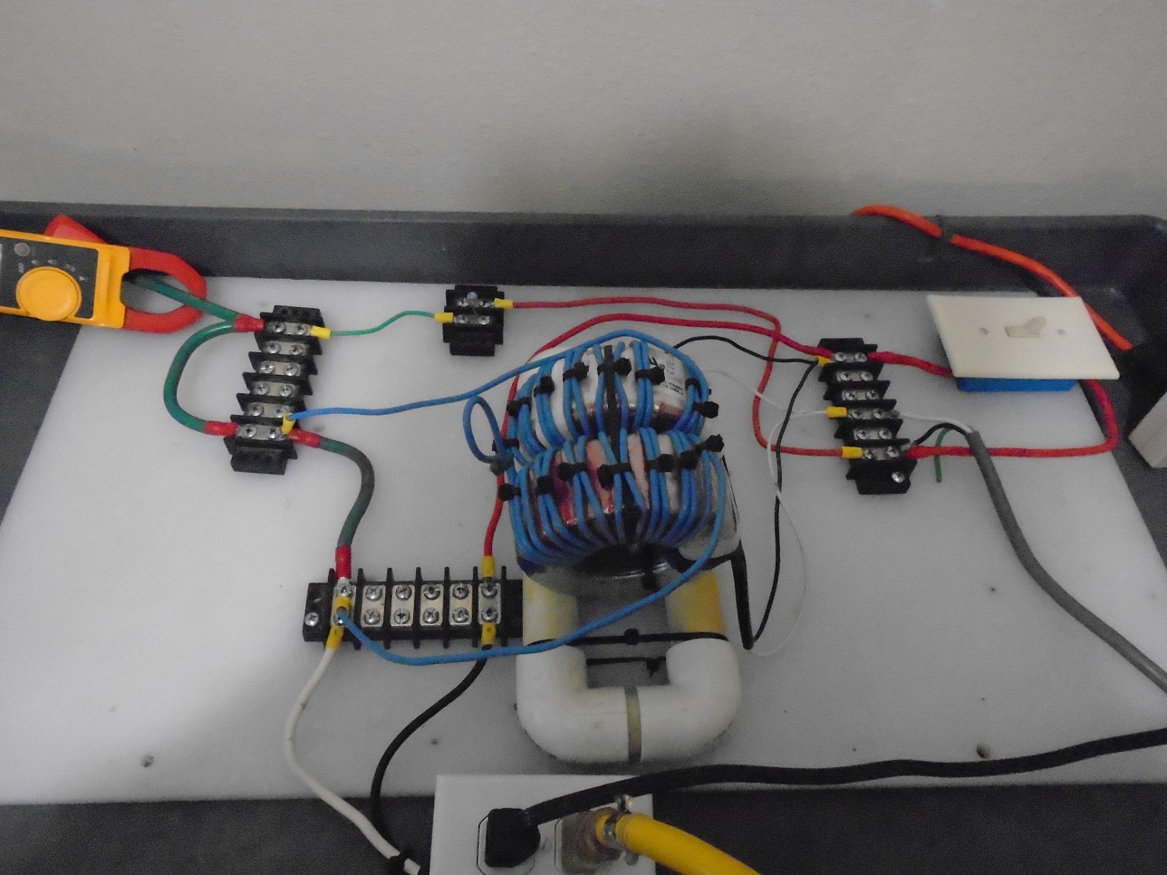

    • Hello Clarence. I took a close look at your latest setup, and when connected to the mains it will still just be a ground loop from the mains hot phase wire through your ground rods and through the ground back to the grounded neutral wire on the utility box. Nothing has changed in that regard with this latest setup of yours. That would seem to explain why your setup can only power light loads when powered from your battery and inverter, as you described in your comment above. In other words, it is still the same old mains ground loop situation fooling your power meters.
      You can easily confirm if this is the case or not by doing two very simple tests:
      When powering from the mains:
      When powering some large loads, set your clamp-on meter to measure AC current and measure the current on the 'hot' phase wire (should be the black wire) on your extension cord which is powering the whole setup. If this input hot phase current is way higher than 0.07A, such as in a high Amps range in proportion to the loads you have connected, then you know for certain that it is a mains ground loop fooling your power meter, since the ground loop return current bypasses the power meter.
      When powering from the battery and inverter:
      Simply measure the DC battery current in one of the battery wires going to the input of the inverter, and if this current is quite high in proportion to the loads you are powering, then you know all or much of the power is coming from the battery.

            Hello Cadman. This is not about 'whether OU can be measured', and never has been, as of course over unity is capable of being measured. If you are getting more power out than the total input power to a system, then that would be over unity. There is nothing complicated or mysterious about that at all.
            What is of interest here is what is really going on in a B&L setup of this type. If you had bothered to actually read what I wrote above and considered what is being said, you would realize there is a very apparent problem with Clarence's latest setup. It performs great when connected to the mains, but Clarence stated that it causes the current limiting on his inverter to kick in when trying to power larger loads. That is a big warning sign. Let's not mislead people here. Clarence was suggesting that the high current on his ground wire (18A to 25A) when connected to the mains was not coming from the mains, and that is why he felt he had something special this time. If you have any doubts about this, go back and read Clarence's previous comments on this.
            Anyone who cares to look will see that Clarence's latest setup has the hot phase wire going to one side of his load, and this phase current then returns through his ground rod array through the ground back to the grounded neutral on the utility box. In other words it is just another mains ground loop setup. That would appear to be why it performs great when connected to the mains, but apparently can only power light loads when connected to a battery and inverter.
            I have suggested some very simple tests that Clarence can do to easily confirm where the power is really coming from in Clarence's setup, whether he is connected to the mains or to a battery and inverter. A person who is genuinely interested in trying to understand what is really going on would of course not hesitate to do these kind of basic tests because their goal is to get a better understanding.
            The problem here Cadman is this latest setup by Clarence appears to be no different than any of Clarence's earlier setups other than this setup not having the high current 'captor loop', so chances are it is going to perform about the same as his earlier setups. I encourage Clarence to do some proper testing and confirm this for himself and report his results back here, as I would hate to see a bunch of people shelling out large sums of money on batteries and inverters and toroids and a whole pile of ground rods if this latest setup is really no different than Clarence's previous setups.

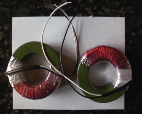

                • Somebody could tell me this please
                  Hello
                  I understood the circuit of the device that is on the picture that clarence posted before
                  What it is not clear for me, why on the picture of the final setup (attached the picture) the toroids look differenf in comparison with the picture of the toroids from birdgeport magnetics
                  Just tell me if you did a modification to the original toroids (I kow you added the blue wire, I saw in the picture very clear, but I do not know if there is another modification to the toroids).
                  thanks

                    • level
                      • They are the same ones
                        Originally posted by FRANKLIN View Post
                        Hello
                        thanks
                        FRANKLIN,
                        I don't know why you think you see any difference?
                        They are the very same ones in the image photo!
                        Years back I bought a total of five of them.
                        Two of them I sent to another member several years back so he could
                        do some building.
                        As you said yourself, the Blue wire is just clearly an overlay.
                        I don't mind the question, now you have the answer.
                        Respectfully,
                        Clarence
