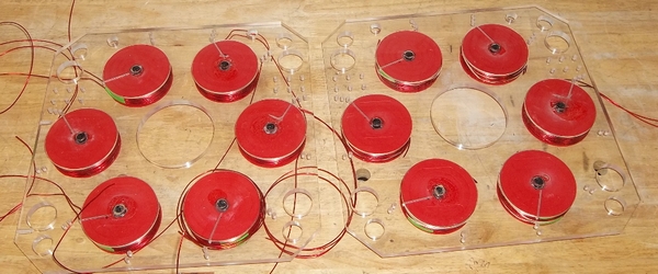

                    Building Pulse Motor Stators
                    Hello everybody.
                    When I began work with the pulse motor stators and did discover a couple minor issues in the process.
                    In fact I have already repaired the stators once, already, as it does appear that UPS managed to drop the kit somewhere along the way, at least once, and one coil on each stator had broken loose.
                    This was easily repaired with weldon #16 acrylic adhesive. When coils break loose; this results in a unique pattern, or "key", allowing the coil to simply be glued back into exactly the same place.
                    After removing the protective wrapper from the acrylic plates; I did discover that three of the coils were not actually lined up with the plates. :P
                    The plates have circles machined to accommodate the coils as well as a groove machined in each circle to accommodate the inside wire from the bobbin.
                    And whoever assembled these simply didn't do a very good job making sure the coils, and respective wires, were lined up with the grooves properly.
                    I don't think this is a performance or clearance issue but, sometimes, I am a little picky about such things...
                    So I simply used a hammer to knock out the three coils, machined in a 'side' groove to accommodate the improper alignment, then reinstalled the coils in a similar manner that I used with the first two that broke loose in shipping. So that solved the first minor issue.
                    I can understand why this might happen as it was assembled while protective acrylic wrap was still in place therefore no way to see this alignment during assembly.
                    It's a catch 22. Either leave wrap on to protect finish but possibly misalign coils. Or take wrap off for the assembly but possibly damage finish during assembly or shipping.
                    The second issue I discovered is that some of the fasteners were sticking out from the back of the stator plates resulting in a small 'bump'.
                    And, because these stator plates have rotors on both the inside and the outside, this rear face should be as smooth as possible and no obstructions so that rotor may be mounted as close as possible to the stator.
                    This was easily remedied in a few seconds with an angle grinder to smooth down the bumps and solved this second minor issue forthwith.
                    And, BTW, mine was one of the earlier shipments of this brand new product and the manufacture has already addressed these issues, implemented some changes, and is no longer an issue with the current product.
                    I did go a little outside the original design specification which calls for both stators to be connected together via two brass crimp connectors to be installed after stators assembled together in frame.
                    But I chose to actually solder these connections and provided separate pairs of leads for each stator.
                    This will be a more solid electrical connection and makes it much easier if experiment needs to be disassembled for whatever reason.
                    That is all for now.
                    Kindest regards;
                    Larger images here-
