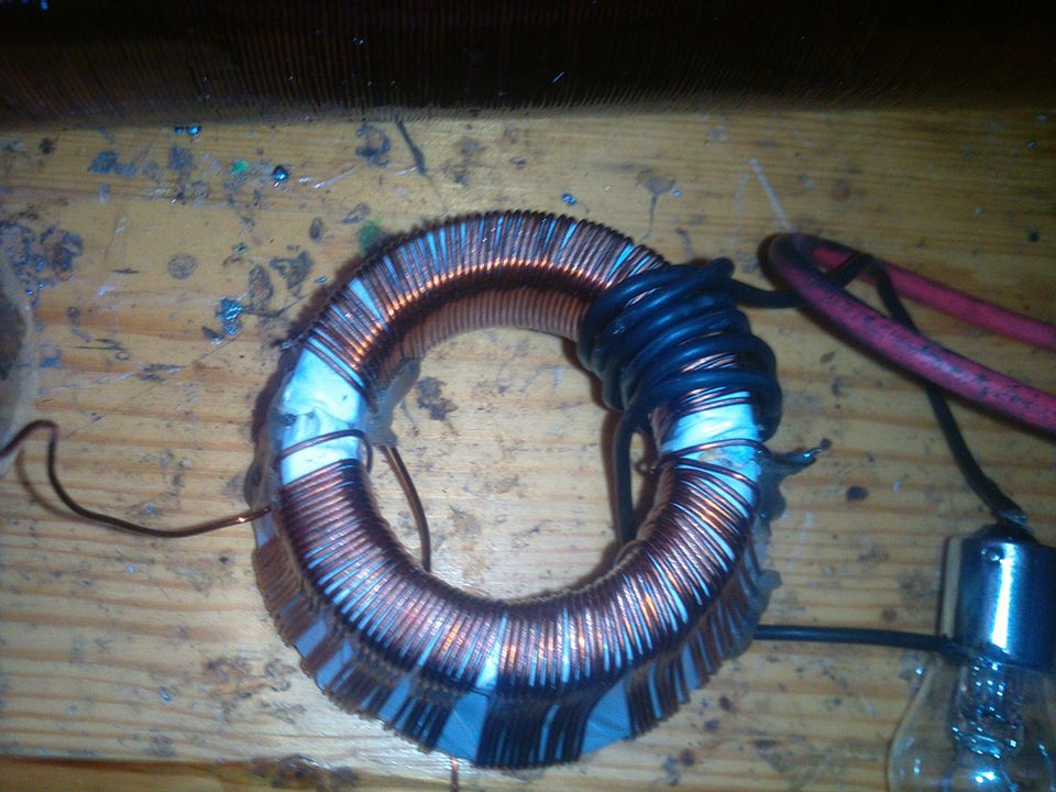

            i did that experiment just to see if i am correct or wrong so no deep improvement since i have a big obstacle using high voltage, the ferrite core is CCW ( around 160 turns not 80 T ! my mind stuck in the half because i made two coil 80 t each, most TV Yoke can be divided into two parts )

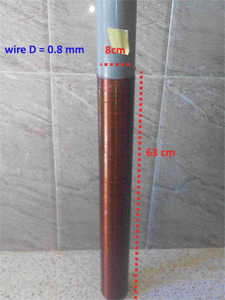

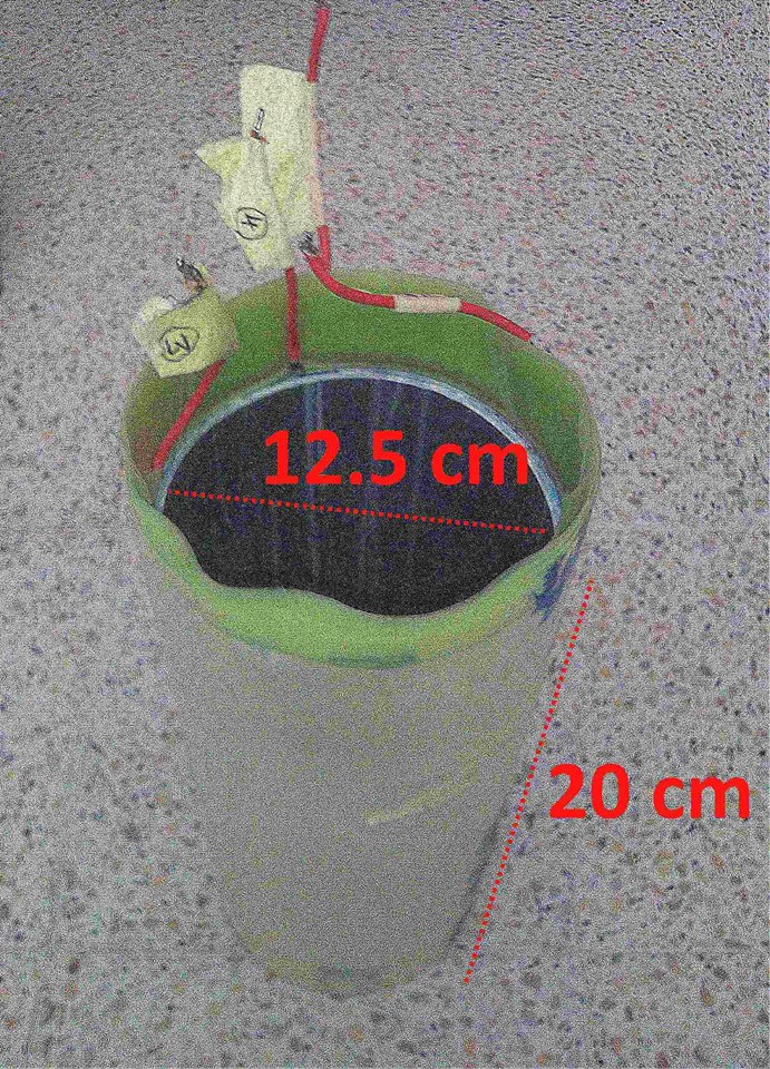

                      • now this is the actual sizes used :
                        • The length of foils is 2 meter each with 20 cm width , the used metal is the aluminium in this test now if you have a problem soldering the Aluminium with copper wire please use a mineral oil , see this video for details

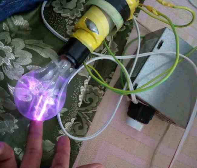

                              the story about using the ETBC as therapeutic device was when i noticed an increase in my energy when i touch the high voltage tower coil ( the coil has 1000 turn with 0.15 mm wire very thin ) , one friend has a pain in his left hands asked me about the circuit he see, he don't know anything about high voltage , i turned the power on to show him the nice painless high voltage arcing even though it warm the point where the electricity contact your finger, he did the test and told me the pain is gone !! i don't know about his problem but i told him this electricity is beneficial for health at least what i have read from the internet about Tesla electrotherapy devices ; i also noticed sleep induction at night , it's clear this electricity work in harmony with our body, it's also beneficial in heat loss in the body especially these days in winter , the most amazing experiments is when used for headache ,with a closed eyes i put the bulb in the upper front of face and slide it right and left i felt if a hidden hand entered my head to give a massage to the brain !!! some will not believe this but this is what i felt .. the pain gone instantly .

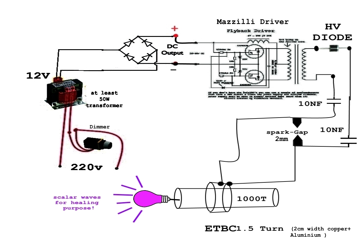

                              electrotherapy is an entire science, most physician don't know the difference between transverse waves and scalar waves a cooperative work is needed, the following schematic was used as a Tesla violet ray device :
                              NB ; i don't encourage anyone to actually build the device i post this for education purpose not for therapeutic purpose!
                              teach yourself before !

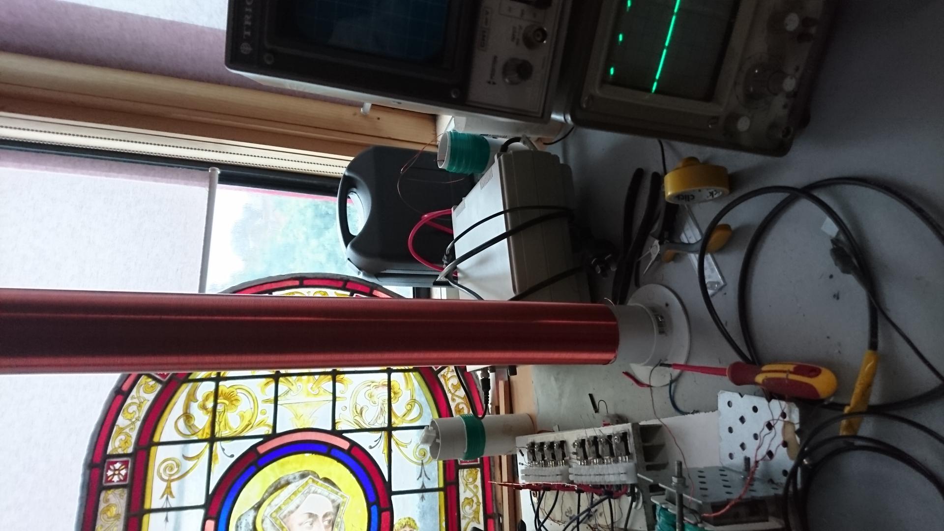

                              • Hi med.3012,
                                I also spent some time watching your youtube videos. This is where I think the confusion set in. I have wound the tower. I have used the 0.8mm gauge wire on a 50mm poly pipe and 600 turns, the length of the winding is 489mm. I have wound the coil before I have seen the alteration to dimensions. It is raining again today, so I shall look at winding the ETBC and toroid. Although I think my toroid might be a bit smaller than yours. Will see how it goes.
                                Dwane
