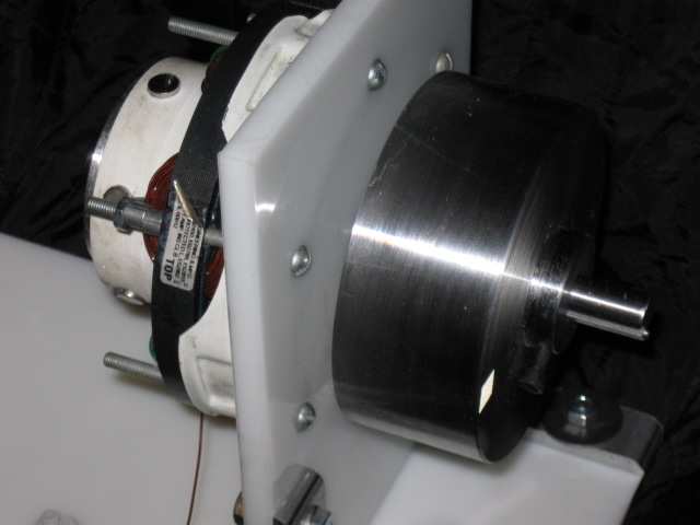

    I finished winding my motor and it worked, not the best but it is a start.
    So, I built a brushless motor with no permanent magnets, just an itch I had to scratch. The build is very similar to the 90* gen, posted by UFO, the rotor is also similar to Dragons rotor.
    The first of the video is the build, last min or two is the motor spinning.
    http://youtu.be/o6yZQpX9y5k
    Again, just an experiment, will probably switch to pm rotor.

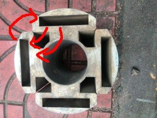

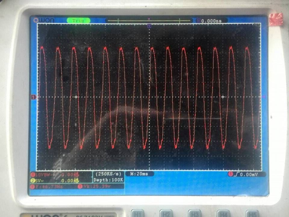

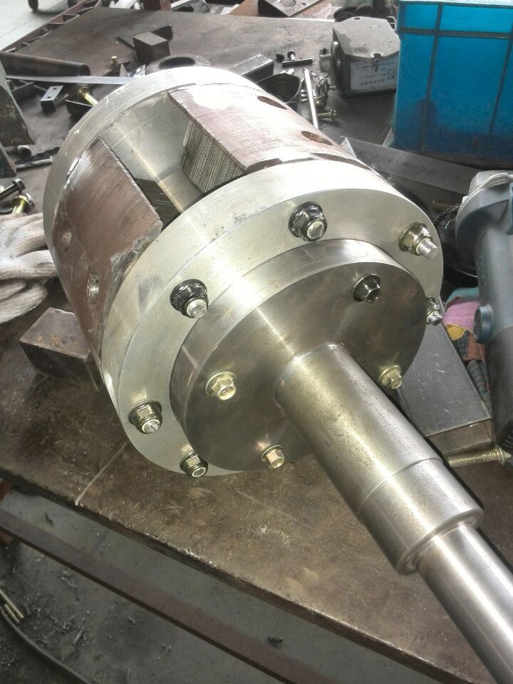

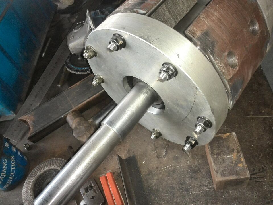

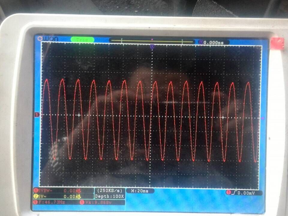

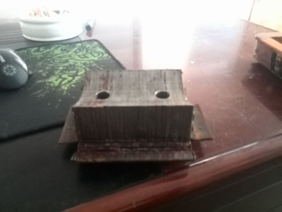

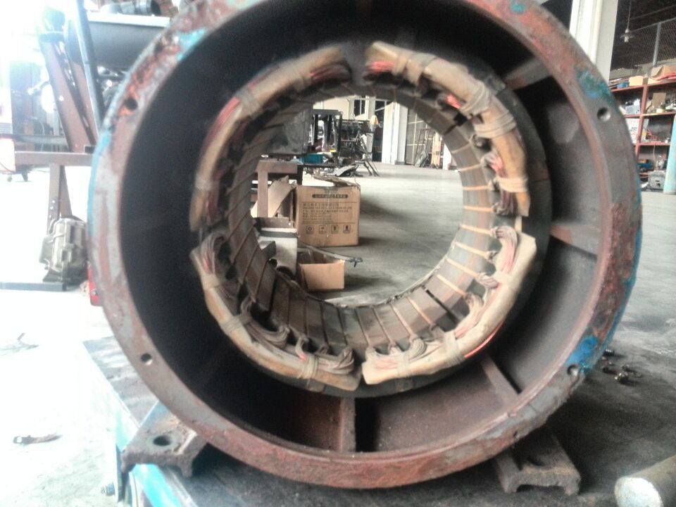

                        • 10kw 220v 50hz 1500rpm gen is convert to the new gen ,but the gen voltage is about 25v NO LOAD at 700rpm,the pm magnet is 100mm *50mm*10mm N52,arrangement NSNS,i dont know why the voltage is so low。
                          here is some pic。

                            Hello Aweiaini,
                            IMO I do not find 'suitable' your Generating Coils Fields arrangement versus your Four Pole Iron Segments, therefore, the magnets which are not seen on pics...
                            The Stator Generating Field overlapped coils are based on only two poles, while it has Four eight pole single coils, which seems for the exciting circuit.
                            Are you reproducing the Original Rotary Stator segments size circumference exactly as it was?
                            I see too wide gap between each iron segment.
                            [IMG][/IMG]
                            In my opinion you will need the iron transfer cores to be matching the smaller size overlapped coils, meaning from two to four poles size from stator generator core, and not based on the four larger coils, which are not overlapped. That limits your continuous and increasing V generation.
                            Also, you do not need the "T" shaped laminated iron ...that is wasted space from solid magnetic field transfer, use semi arc rectangular segments. There is no wires going there...so, no need for that T shape. And make them not that deep, that is also 'delayed' transfer on the long run.
                            Just my two cents
                            Good luck there!
                            Ufopolitics.

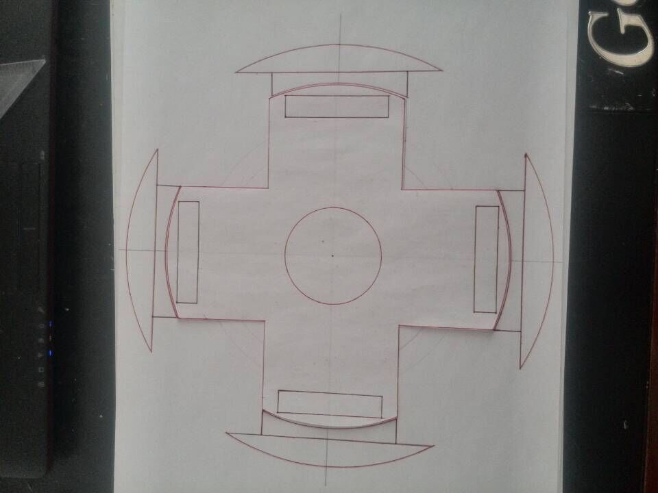

                            • first pic is for install pm magnets,
                              • Originally posted by aweiaini View Post
                                [/IMG]
                                Hope this helps you...
                                Plus, you must realize you are using straight magnets (not Arc Segments), therefore you already have a loss in gap geometry transfer communication.
                                Ufopolitics
