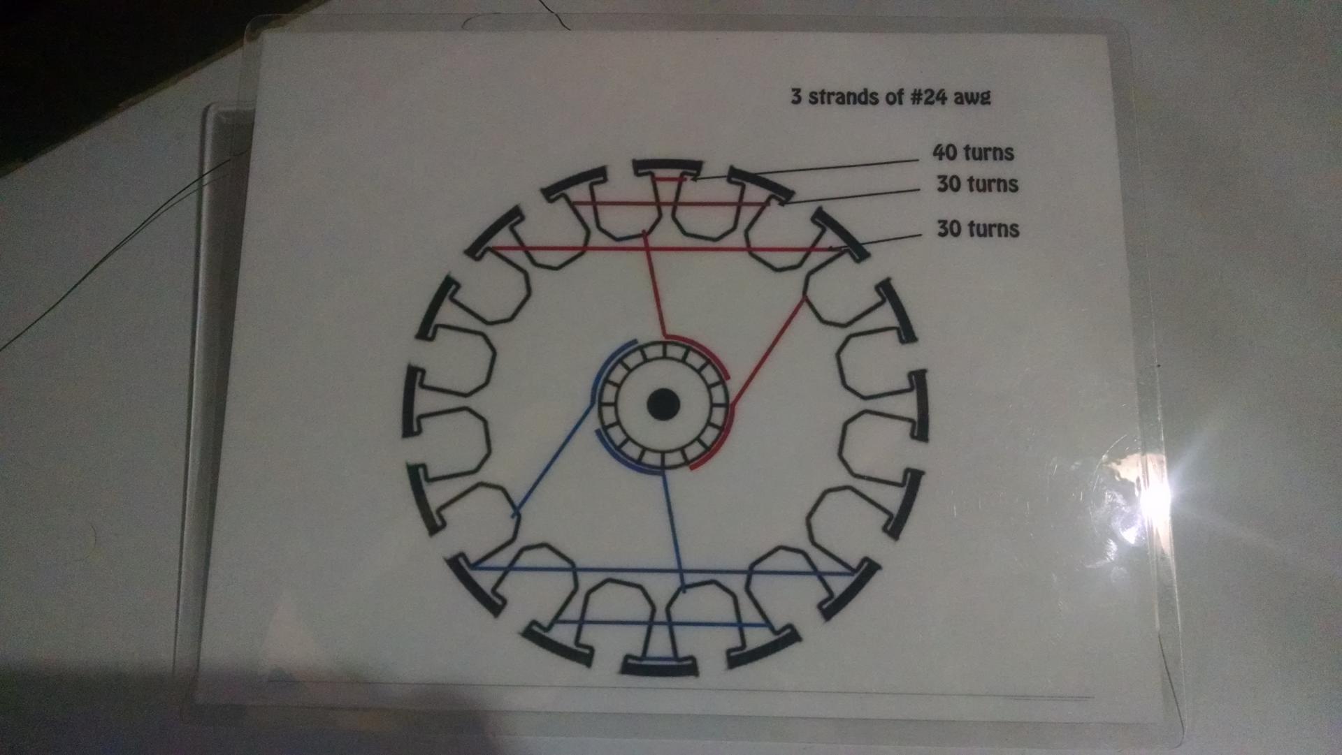

                Matt, I'm winding one of your Razor Scooter modifications using the attached drawing. It says, "3 strands of 24 AWG". Is that 3 strands per turn (the 40 turns has 3 strands, the 30 turns has 3 strands) or is it one strand of 40 turns, then one strand of 30 turns, and one strand of 30 turns?

                  Its just 3 strands all the time. I think the total was 100 turns.
