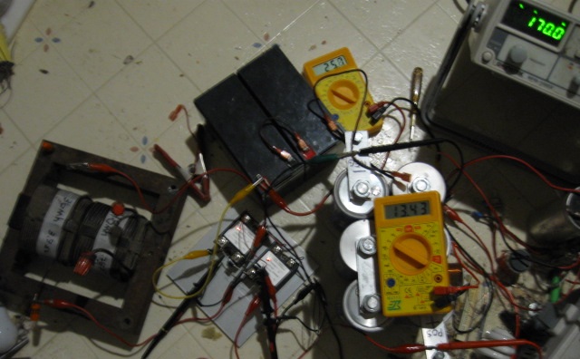

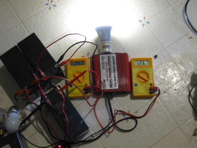

Below is a picture of my spaghetti ball of wire, switches, batteries, transformer etc... that picture shows a complete balance of energy being shuttled back and forth between the batteries and cap bank. At 170 hz it holds at 25.7 on the batteries and 13.4 on the caps. The interesting part is that when I lower the frequency I can charge the cap bank while draining the batteries and raise the frequency I can charge the battery bank and drain the caps. There were no loads running during this test, simply a curiosity of anomalies I saw in prior testing. It appears to be acting as a resonant circuit between the batteries and caps through the coil - off resonance high or low we get a different directional energy shuttle. I can measure everything but the batteries so this leaves one variable that is unknown. My own little quest for some answers...

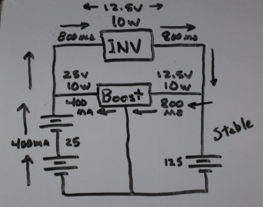

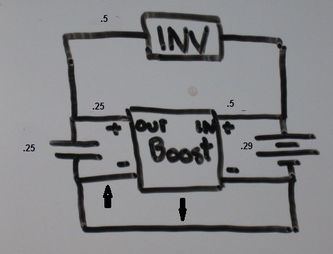

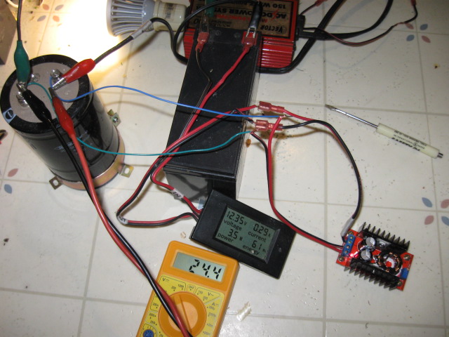

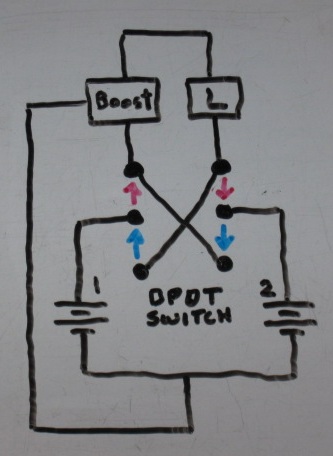

So while pondering the tests, the 3 battery system and creating a potential difference it occurred to me that 2 batteries and a boost converter basically does the same thing.... so I scratched some thoughts on my white board then put together some quick tests... can anyone explain the difference??? The diagram shows a 2 battery system using a simple manual DPDT switch to shuttle the batteries - one is being drained while the other is charging.

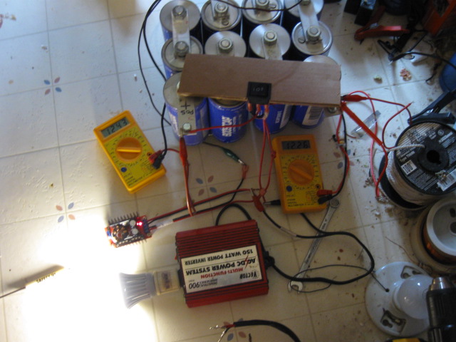

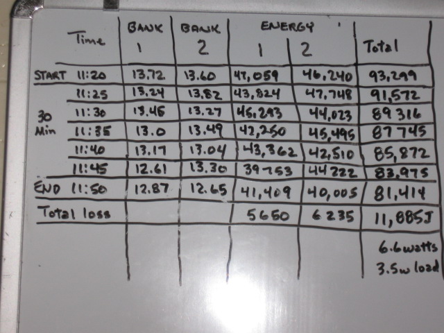

Today I'll wire up a 2 battery system to drive an inverter between the two using 2 500 farad cap banks.... it should be reasonably easy to measure the losses/recovery...
