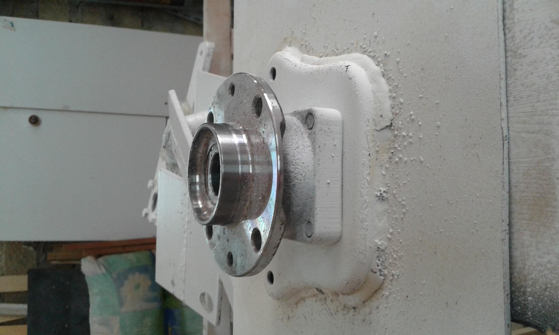

      • Base bearing
        Originally posted by armandino View Post
        this is my tangential acceleration system that allows to obtain an increase of the output torque.
        See you soon
        I realized in this way the sealing system and of all the load rotation. it is de bearing of the hub of the wheel of a machine (used by many brands). this hub is ideal for our realization as within two different diameter bearings are installed. in this way it acts as a conical bearing which can weigh many Kg. and resists lateral traction as if it were mounted on the machine. in the upper part I installed a crown of the transmission of a Quad, step 420, and with chain connect all four rotors.
