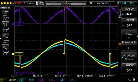

COP 20.0 (2000%) Demonstration
  • All,
    Attached are measurements made on a single cap switching scheme, (also attached).
    The Watts display is 20W per division. Ignore the units displayed in the Math function as AxB function takes its units from channel A or B, so to get the measurement table to display Watts I hade to change the Amps units on Channel 1 to Watts. This is a bug in the DS1104Z Rigol scope.
    I increased the switch open times so you can see the zero line in the Watts display. I then included another shot with this line marked in red.
    Source V & I phase is close to 0 deg.
    If you look at the max and min in the Math measurement table it shows about 30W forward and 30W in reverse, with an average close to zero.
    Load measurement in the Math measurement table is showing a 16W avergage.
    Load V & I is in phase.

    • All,
      Higher resolution shots are available at
      COP 20.00 (2000%) Times, Reactive Power Energy Source Generator,
      Along with the full set of circuit diagrams.
      Barry

          • All,
            Not wishing to mislead anyone, I discovered that I had my voltage probe across the switches, instead on the source input. Just forgot to put it back after looking at transients across switches!
            Having corrected the monitoring I changed the 6uF cap to 4uF to get the greatest V & I phase shift. The best I could achieve was approx 60 deg.
            Looking at ratios not absolute measurements, for the source I have about 52.8W forward and 37.6W reverse (peak). The average power is 7.03W
            For the load the average power is 6.21W
            So I have not got close to replicating the Babcock Murray results yet.
            Barry

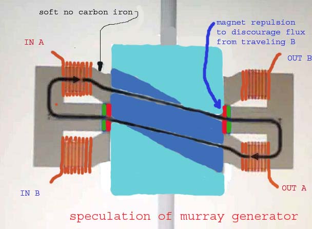

                      • Speculation of flux switching in the dyna-flux
                        I made this illustration from the youtube videos from user syncopetra on dyna-flux alternator in hopes it might further the understanding.
                        It is by speculation and needs a proof of concept.
Name:	flux path murray copy.jpg
                        The role of the red - green magnets shown are in repulsion mode and facilitate the direction that the flux will take toward the path of least resistance.
                        when the concept is understood the model can change to replace the repulsion magnets with electric magnets that gate the flux at the precise timing.
Name:	flux path murray2.jpg
                        A permanent magnet alternator is difficult to turn under load.
                        The low Lenz principles demonstrated by Jim Murray Alternator does not require much torque.

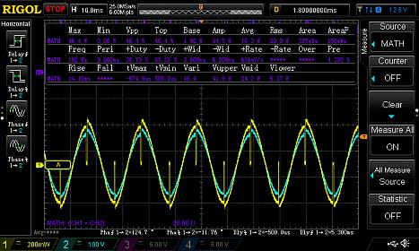

                        • Parallel Charge Series Discharge with shunt cap
                          All,
                          After trying many schemes, the parallel charge series discharge scheme with an added shunt cap across the source transformer secondary, appears to provide the correct conditions.
                          The switching does not have a gap between charge and discharge so the waveforms are not exactly the same as the Babcock Murray ppt presentation. My setup is in a different configuration at the moment, so I will have to make changes again to try this out.
                          Barry

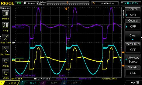

                              • Latest Result
                                All,
                                Attached is a scope shot showing transformer primary V, I & W.
                                I had issues with the zero cross circuit seeing the next half cycle switching transient and miss-triggering, however it is possible to run the circuit with a single half cycle, which you can see.
                                You can see from the power waveform that the return power through the load is almost equal to the forward power through the load. This particular waveform had a reversal of charge and discharge signals. The balance of charge and discharge current pulse amplitude was achieved by discharging into a different tap on the transformer secondary using a single capacitor.
                                I have found that a single capacitor for each half cycle is required and having solved the zero cross problems I starting testing both half cycles. This worked for a while and I was generating both half cycles but in pushing the power up I fried my MOSFET's so now I have to wait for parts to arrive to build some new switches. The cap value is not critical and 150uF was used.
                                You can see the transformer primary magnetising current (0.5W average) overlaid on the switching waveforms, confirmation that these measurements are on the primary of the transformer.
                                In this case the source power differential (1.77W Average)
                                and the power through the load (0.6W Average), were close in number and a really good test would be to increase power through the load, so the ratio is 10 to 1 or more with respect to the source differential power. This is the test aim after constructing some new switches that should handle higher peak voltage/current.
                                This does serve to illustrate that if the circuit can push power back into the primary source, it should be able to do the same with a generator. No other conclusions can be drawn as the load power was so low.
                                Barry
