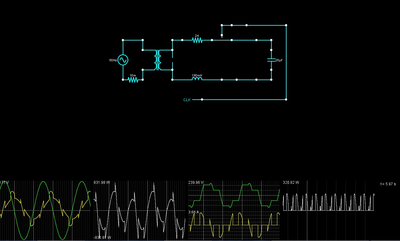

  • Here is a single cap simulation of one switching scheme which is not ideal and is limited by the simulator clock capabilities but it illustrates that 320W peak power through load, is obtained from 831VA reactive power. So the generator needs to support this reactive power but it is returned to the generator. You still have all the transmission line losses remember.
    Ideally 2 caps should be used with each cap charging in alternate half cycles and then discharging in the next alternate half cycles. This will give you the waveform shown in the presentation.
    You can partially see this in the simulation but not exactly because the falstad simulator doesnt allow timing to be set up for each quadrant (1/4 cycle).
    Barry

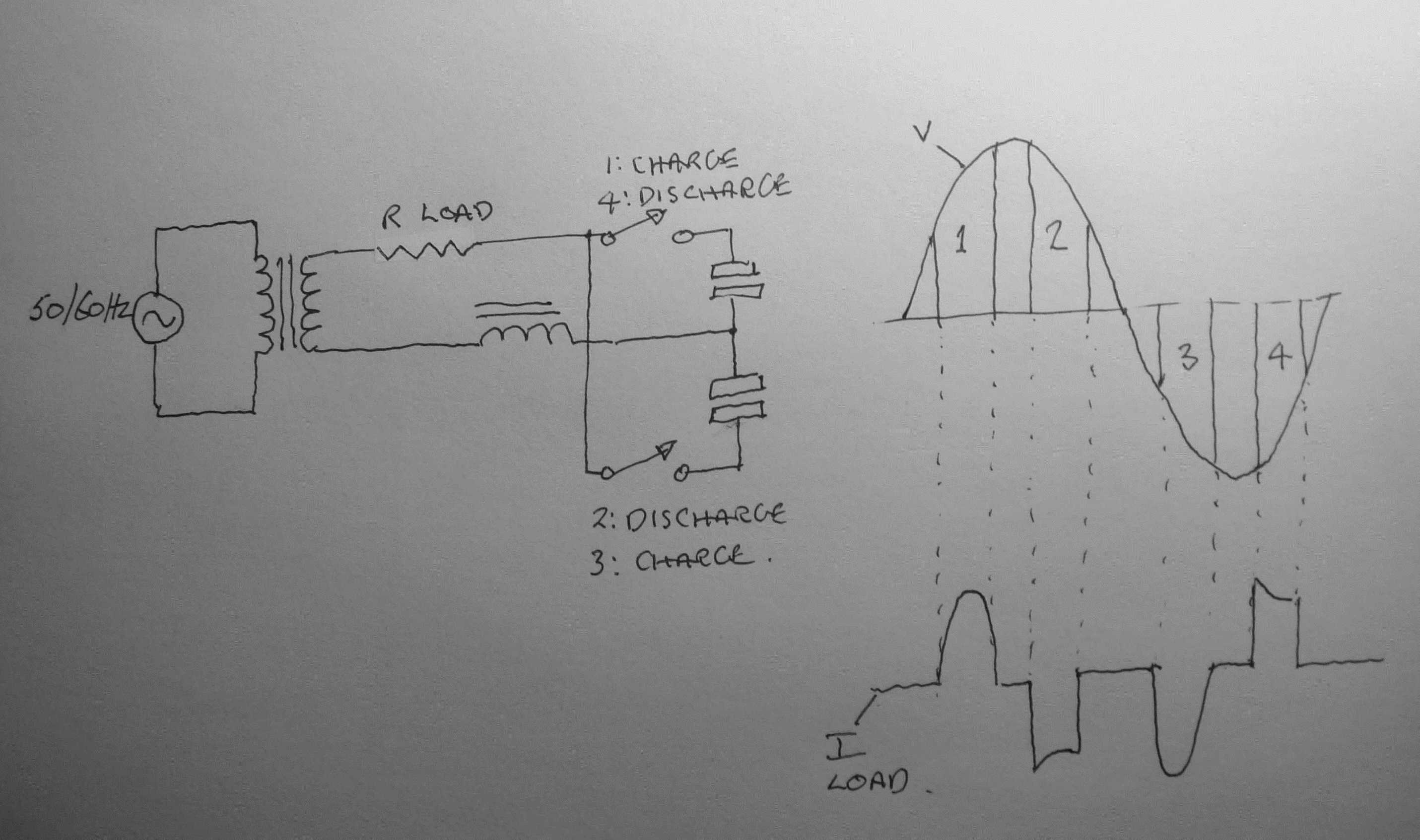

            Great job Mike. I'm going to pollute it with one crappy image to give my interpretation of this wave form. I have superimposed where, I think, the original, unbroken sine wave is. At the top is numbers to represent what I feel are important events in this image. Comments below image.
            1. First quadrant ( quarter ) of the sine. Terminated with first switch.
            2. Flyback from first switch off.
            3. Switch off with pause (important).
            4. Down side of sine terminating with switch off.
            5. Flyback from switch off.
            6. Final pause.
            When I say switch off I am referring to as it relates to the source. They obviously are redirecting between input, caps, gen coils, and output. Using the switches to change the circuit from gen/rlc/load to motor/load. Remember, they load both directions.
            That is my opinion of this wave form though I could be WAY out there. Please correct my understanding if I am.
            Randy
            This is a close up of the waves but I do not know what is what as far a what is called a quadrant.
            This is 1 or 2 cycles not really for sure coming out of the transformer (standard isolation type)
            Thanks Mike
            _
            • Hi BroMikey,
              Firstly all simulations I have run albeit with less than perfect switching, confirm what Babcock and Murray are saying is correct, so I am not a naysayer.
              The simulated circuit is a resonant tank. In past experiments I have never had success in extracting power at these low frequencies from a resonant circuit, as the load usually kills Q. This configuration is different.
              The simulator doesnt allow the switching scheme Babcock and Murray are using to be replicated exactly, so to investigate further I am working on a build.
              I already have bidirectional power switches zerocross detectors etc, just waiting on parts for the timing side.

                • Hi Mike,
                  Re generator stress: In my last simulation 320W real power through load is comprised of +831W from the generator in the forward direction through the load with the cap storing charge, which then is returned through the load in the reverse direction -831W to the generator. This power would be considered reactive as it largely cancels.
                  However the +831W from the generator is a load driven by the prime mover which is burning fuel and the generator rotor is under torque for the first half cycle when this happens. When the -831W is returned in the second half cycle the torque on the shaft from the prime mover is negated as the power is turned into rotational torque on the generator rotor.
                  What I am saying here is the prime mover sees an intermittent Torque/Power demand every half cycle and rather than a continuous demand through 360 degrees of rotation. This is a mechanical stress on the system. If the rotor was large enough, the inertial mass may well even the torque fluctuation out and so the primer mover would just see a reduced torque requirement through 360 degrees. In a small generator this may not be the case though.
                  If this were a simulation including the electromechanical part I.e. the generator, there would be conversion losses which would add to the transmission line losses, so this would reduce the power returned.

                    • also opinion
                      The rendering of the waveform there is a timing in there can be approximated there is a sequence of two and inverted two. The first wave resembles half an ellipse and the second is a trapezoid common in motor switching and has a bottom of an offset sine spliced into top of the trapezoid then the next sequence is inverted. This looks like microprocessor programmed wave. The output has been converted to 2 sequence positive.
                      • I believe this how the wavform is obtained.
                        Barry

                            • Very clear examples
                              Barry
                              Wow yeah I see it now thanks Barry.
                              I think you are right as to this being chopped up and moved around and the ETO stuff is old I agree, with the scr and fet.
                              Mike
