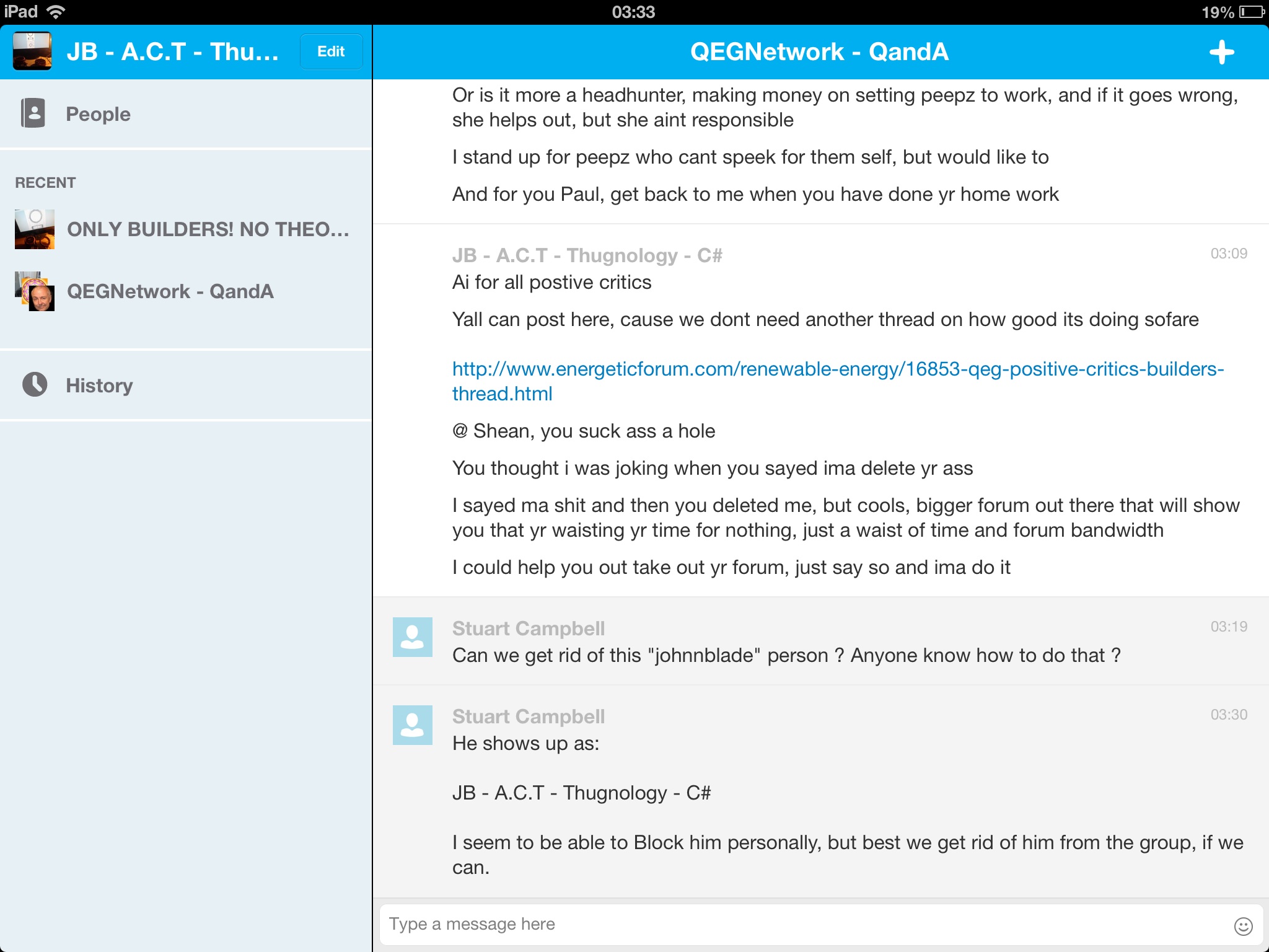

    @ Shean from QEG forum, thnx for the support ass a hole
    http://youtube.com/johnnblade
    Hhahaha nothing new when once in a while someone comes around with his eyes open. And stimulating yall, and this is what i get hahahaha
      I have been busy checking out peepz who claim ****, but never really showed anything usefull.
      Why i am acting like this is cause anytime i see a new person doing something good ( efficient device, selfrunner ) they act all cocky and ****, and peepz ask them real question without even being offending but then those peepz reply in a disrespectfull maner, untill that person comes across a person who can say more then one of those ass a holes.
      I did not ask for this, but the way they promote/show/share sheit with attitude, i get a feeling to like dude, if you can do this, then i can do this to them, cause in a few years i seen trolls come and go, cocky peepz come and go, and more, and i kept my cools ( just another read on the internet ) but now i must be tired of peepz bull****ting more on the net then them real good peepz, so i cant stand that, so ima do back what i feel ( and offcourse if i dont "like" im must be a troll im not, im just tired of trolls talking to much sheit, and they continue thinking they can do whatever to fool peepz, dude i have now time for that, so if i see crap and im paying for internet i might as well involve myself cause reading and doing **** aint gonna change the real trolls it might or them peepz with cockyness, they must just know that in time you will face someone who gone tell you ****, and it aint scientific at all.
      Only by the way peepz write online i see a character, but if it suck and yr pushing it, im test you, and if im going to far to you may try to do or tell me ****, but **** is, im more down to earth then those talking to much ass a holes acting like internet knowledge, energy divas ( not only woman )
      So from lately, i will insult or provoke ass a holes if i see they aint showing respect online, dude, on the street you would shut the f up, but online yr mouth is soo goooooooooooogle.
      To most of the online community/internetters looking for their own interest, dont talk **** **** to them, cause ima show you inter **** aka Thugnology
