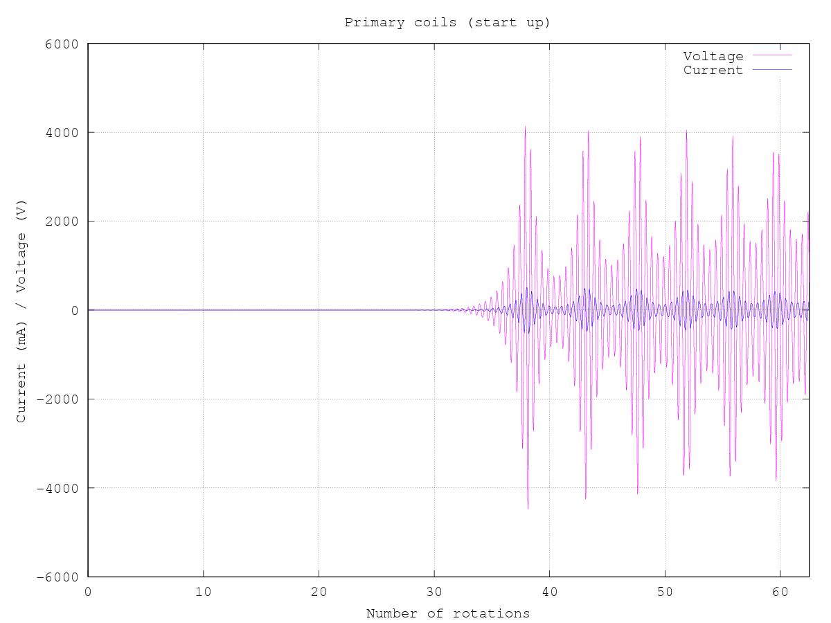

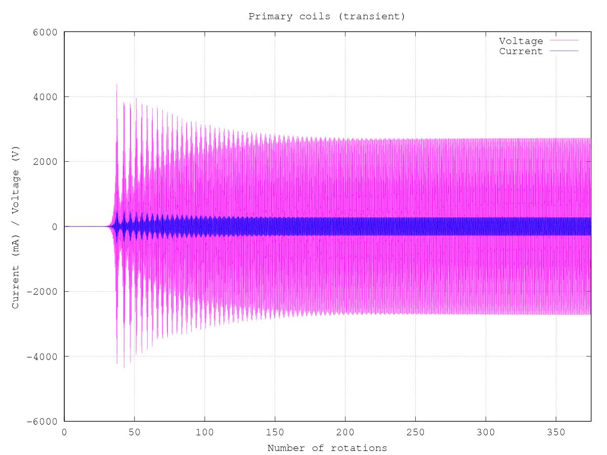

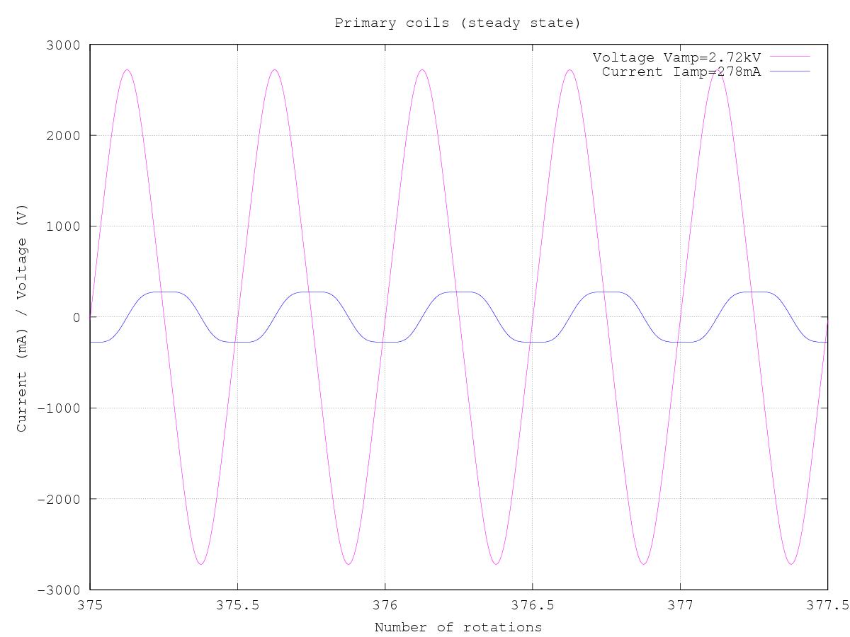

              The rotor will vibrate because of the magnetic forces that build up in the core. Simulations show that a force does build up between rotor and core when flux moves through the rotor. These forces can become quite large and thus a sturdy build with tight tolerances is necessary.
              I have done quite a few simulations now analyzing the complete system with inductances, mutual inductances, resonances, etc. and here is what I find from the simulations:
              1. The system is started up by parametric excitation of the inductance of the primary coils. Quite a few links have been posted in this thread about parametric excitation, so if you wish know what that is all about, read some of those papers (a lot of them were written in the 1930s).
              2. Starting up the system is no magic. It can all be explained with normal electrical equations. Current noise (e.g. a pA in my simulations) in the coils will grow to about a few 100mA in the primary coils and the voltages associated with that run in the kV range. In my simulations I have seen voltages oscillate with magnitudes of 1kV to 20kV depending on system parameters that you set (inductances, modulation index of inductances, coil resistances, etc.). The capacitance sets the electrical resonance frequency. Tuning the system (electrically and mechanically), it is very easy to get high voltage spikes that can burn out the isolation on the coils (which is what happened in Taiwan). From my simulations, I find typical stable voltages for the primary coils around 2kV-5kV range. The secondary coils run at a factor Nsec/Nprim = 350/3100 = 0.113 lower than that, so in the couple of 100 volt range.
              3. The humming that was witnessed is most likely caused by the enormous flux densities in the transformer core and due to the fact that the core is laminated. A normal transformer also hums. Vibrations occur when the rotor closes in to the core or moves away from it AND a flux is going from core through rotor back to core.
              4. Parametric excitation can occur at multiple frequencies. Typically, the inductance is modulated at a frequency of 2v (v= Greek nu) while the electrical resonance is set at f = n*v/2 with n an integer. It is easiest to find a stable region when the electrical resonance is set at the smallest n number (n=1). In this particular case, the rotor runs at frequency v and the inductance is modulated at 4v, so the electrical resonance should be preferably set at 2v. In this case it appears the resonance starts occurring at a rotor speed of 1500rpm (about 25 Hz), so inductance is modulated at 100Hz. James indicates the output frequency is around 400Hz, which would mean he set the electrical frequency at a multiplier of n=8.
              5. The second set of coils is basically a copy of the first set of coils and they perform a similar role. I hope to discuss this in more detail later.
              I have attached a few figures that show how the high voltage develops in the primary coils. You have to pick the parameters right to get a steady state solution. It is very easy for the voltage to go out of bound (which would fry the coils due to high voltage arcing).
              The image QEG_StartUp.jpg shows how the resonance starts from 1pA of noise in the primary coils.
              The image QEG_Transient.jpg shows the transient behavior from startup to steady state. You can see the voltage initially overshoot to over 4kV, then settle down to about 2.8kV.
              The image QEG_SteadyState.jpg show the steady state in detail: as explained before the inductance is modulated at 4v (4x per rotation). The electrical resonance frequency is tuned to 2v with the capacitance. Both the voltage and current oscillate at 2v (50Hz). Note that the capacitance can be choosen so as to resonate at a higher harmonic (e.g. in James' case n=8).
              But now comes the questionable part of all of the above.
              The problem with parametric excitation is that it is very hard to get any kind of power out of the system without destroying the resonance condition. The energy in the primary system runs about a 2-3 joules. Energy for each of the elements is 1/2L*i*i for the coils, 1/2C*V*V for the capacitor and power loss is R*i*i in the coil resistance. All these translate to about 125W total in the coil and capacitor together and about 3W loss in the coil resistance.
              So the question now remains if it is possible to extract energy from this parametric system without destroying the resonance...
              For that I would like to know exactly how the bulbs are hooked up into the system and if the exciter is present or not when Taiwan tried to tune the QEG to resonance.
