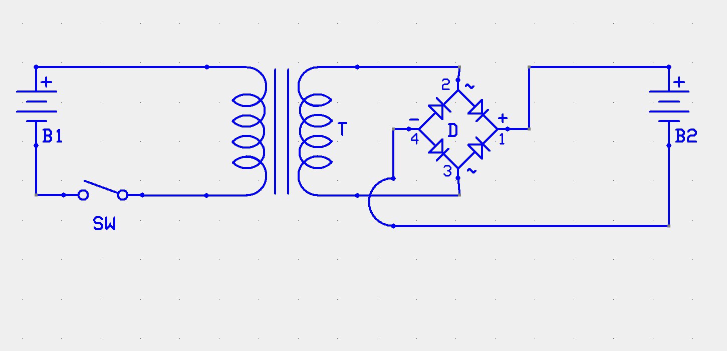

          If I was you I would change that arrangement to a parallel coil being switched
          and use the other (identical) low voltage winding as the output coil like in the drawing
          attached. This will give you transformer action on the energizing phase and
          also direct the coil discharge. This would be a switched 1:1 transformer.
          Once the second battery gets to the same voltage as the charge battery
          the transformer action would not transfer any energy.
          And batteries of higher voltage can be charged with it as well.
          Plus it gives electrical isolation between the batteries.

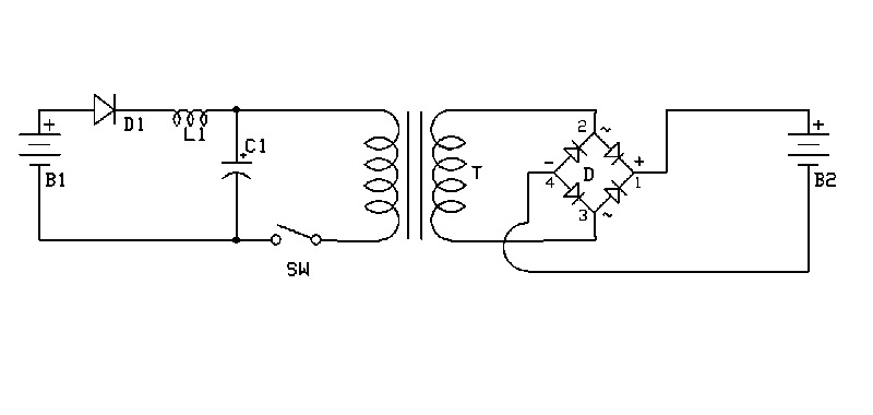

                No your not a dumbass, no one is. Just a note on the in-out power calculations. Volts x amps = power
                If the input voltage is 9.58 and the input current is 0.113 A then that is 1.08 Watts input.
                If the output voltage is 6.13v and the output current is 0.139 then that is 0.85 Watts.
                To get efficiency we divide the output by the input so 0.85 / 1.08 = 78% or 0.78 C.O.P.
                which is actually pretty good, considering all the connections ect.
                With the cap there the circuit returns most all of the energy back to the supply when there is no load.
                Also what you have made there is a kind of resonant charging circuit but your
                transistor switch is in the wrong line, it should be on the low side for the
                negative line to get the coil discharges, the way it is there on the high side
                the coil has no current loop to discharge when the switch is off. A resonant
                charging circuit is a kind of setup that when the switch is turned off the coil
                discharges into the capacitor and charges it up to over the supply voltage.
                Now if you change to a low side switch and then place a diode before the coil
                to stop the energy sloshing back to the supply while the switch is off then
                you will notice a difference.
                I'll modify my drawing to show a resonant charging circuit before the transformer.
                Won't be long.
                When the switch turns on the coil is charged, then when it turns off the coil
                discharges into the capacitor as it now has a complete current path to
                discharge and the diode stops the capacitor discharging back to the supply
                battery. It's a handy circuit as it increases the voltage that is applied to the
                transformer coil on the successive pulses.
                You could just replace the transformer with the charge battery.
                With the high side switch up near the supply battery the coil cannot discharge
                when the switch is off due to no current loop. You could use a high side switch after the capacitor I guess, I just like low side switches is all.
                P.S. My apologies, I think I was looking at your circuit upside down. And back to front.
                The convention is to draw them kind of like I did, more people will "get" the
                circuit quicker. Supply battery to the left and positive line at the top.
                If done right the charging circuit can work as a voltage doubler, usually it's a
                bit less than double voltage on the cap after the coil discharges.
                Nice cat, we've got a black barn cat, we only see it when it is sleeping or
                having a snack or drink. It's not a people cat. But he is cool and a good
                hunter. Keeps the rodents in the chook house in check.
                EDIT: I had the input output figures back to front but the calculation result is
                correct, i just wrote the in out figures wrong way round in the post.

                  In your last attachment. can you replace the supplies with ,generating coils?
                  Can numerous coils be wound around the power coil, in order to be affected?
                  Use them to power loads, they may be small, but alot of small, can get real big, real fast.

                    Yes Shylo the battery B1 can be any source of emf the blocking diode would half
                    wave rectify the input if it was AC but I would rectify it full wave and use a
                    smoothing cap before the blocking diode.
                    As many coils as wanted could be used but the total output will be relative to the input.
