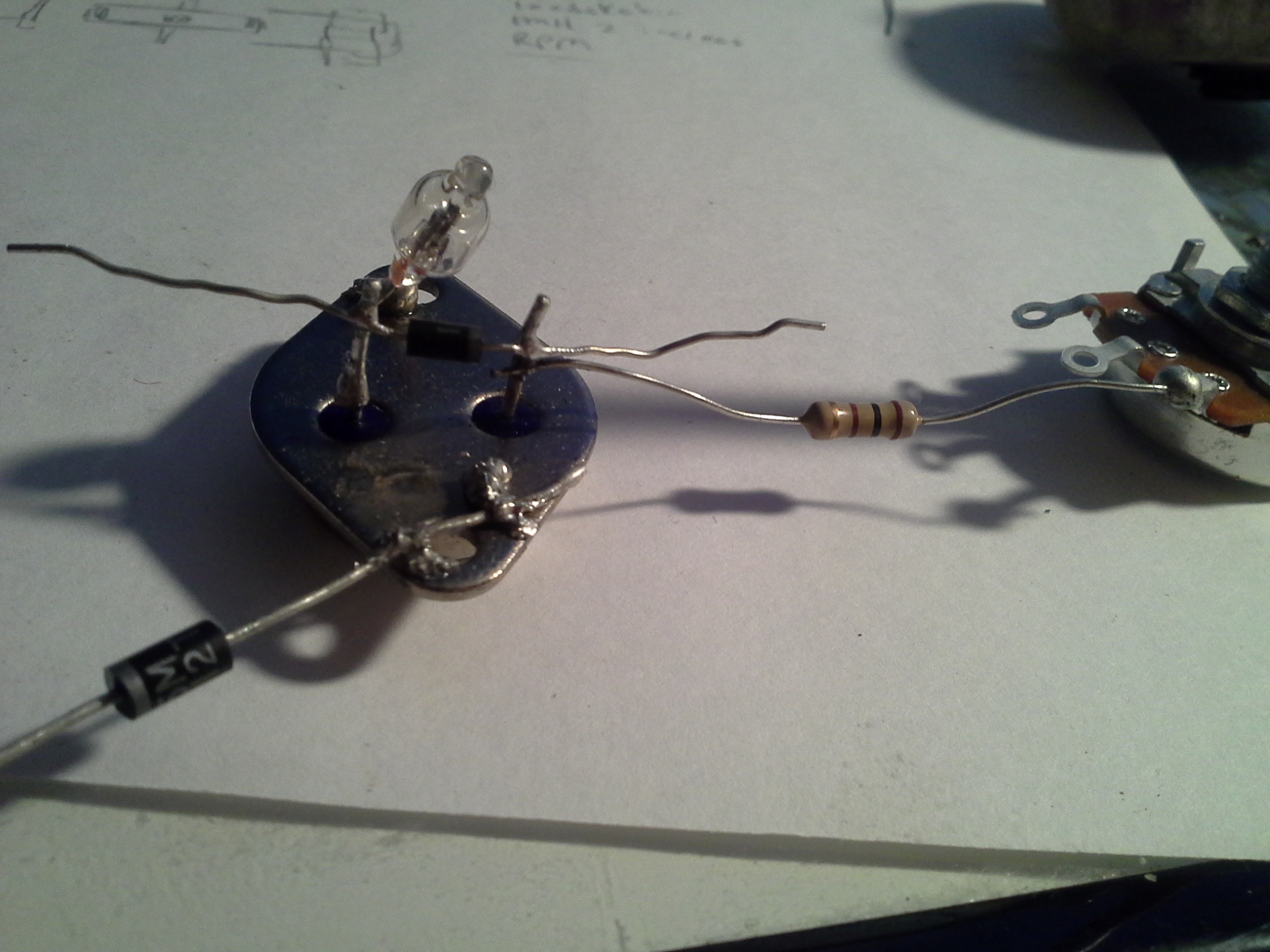

    To begin this is my first attempt at building a ssg and so far i haven't had much luck. I have done some research on other posts by people on their first attempts and tried some modifications to my setup to see if it would help. But nothing so far. My circuit is made of
    a 10 k ohm 250 dc . 25w potentiometer
    a 120 v ac neon lamp bulb
    1. IN4001 diode
    instead of the In4007 diode i found one that is a 1.5 a 1,000 v rectifier diode.
    100 ohm 1/2 watt resistor
    and a transistor
    (Ive heard that a 100 ohm diode may not cause the bifilar to self oscilate, but i've also seen others use it and get it to self oscilate , any ideas if that may be one reason for it not working?)
    I've tested the finished circuits continuity to be sure it is functional and not broken , the results showed it was working.
    my coil consists of a plastic spindle 3 inches long with a soft iron core made of multiple rods. The coil itself has 26 guage and 22 gauge wire in a bifilar configuration with 280 turns. ( i know i need more than 400 turns but this first ssg is just a small version.)
    And my wheel is just a skate wheel with 4 , 1/2 inch ferrous magnets from radio shack ( though i have tried 2 larger 1 inch ferrous magnets.

    Hi Nexgen,
    Congratulations for trying to build the SG.
    100 ohms is pretty low to get this circuit to self oscillate unless the coil might have way more turns that it needs with small wire or something like that since the coil itself already has a lot of resistance build it.
    At 3 inches long coil, 280 turns with that wire might not be enough - if you can increase the turns to maybe 400 or so, that actually might be better - I doubt if your circuit is self oscillating at this point with that kind of coil with a 100 ohm coil in series with that adjustable pot.
    Do you hear a buzzing or whining sound? If you do, your coil could be oscillating.
    With my original roller skate wheel, the coil was maybe little less than 2 inches long and maybe a little over 1 inch in diameter with similar wire it made a coil that was close to the edge of the ends of the spools. With 3 inches, again, I think you need more turns.
    With this size of build, you probably do not need the neon bulb in the circuit and you don't need the adjustable pot. Just do the coil with more windings and use a single 680 ohm resistor for starters.
    Diode should be fine - for this size coil, 1N914's are fine.
    And with this size of build, if you don't have an output battery connected to the output of the coil, you won't blow the transistor - just get it to run.
    I hope that helps!

              got it working!
              Thanks a lot Aaron I followed your advice and replaced the 100 ohm resistor with a 680 ohm resistor, and I also added mroe wraps to 400 exactly. I tried it with my first battery ( a 6 v lantern battery with no response in the orientation that introvertebrate uses in his video). So i added an outlet pllug to the mix ( old phone charger) and switched out the bottom coil connections and I got a pulsing action going on! but its incredibly slow. It only pulses once every second or so . I didn't attach the potentiometer to this because I was just trying to get it going now I think ill attach the potentiometer. Hopefully itll give me some control of the pulsation so it will cause the wheel to actually get a full rotation without stopping.
