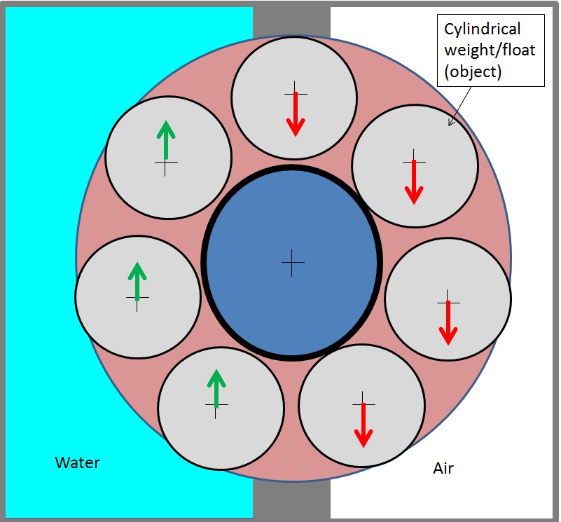

              Gravity is important and can be extracted successfully as hydro-electric turbine does it. Replenishment of a potential energy is the key. Just consider that we have n number of similar objects are at different heights and gravity pulls all of them downward. And if you have a mechanism which can consolidate the force (due to gravity) and use aggregated force for pushing just one of them (at a time) to the water column. Will it not work? That is exactly the turbine I propose will do. Please see the enclosed picture for better clarity.
              >>I think the force required to , insert an object at the opposing force of the water,...will be greater than what the water is capable of producing.
              True, if we consider one single object at a time. But in the turbine I have designed, there are multiple objects fixed at the periphery of a wheel. In which all objects exerts torque on the shaft at the centre in same direction. Some of them due to buoyancy while others are due to gravity. See picture for better clarity. Sum of these torques will be more than enough to push only one object at a time to water chamber.
              Also, note that the object is not really pushed but rolled into water chamber. This drastically reduces the effect of opposing force.
              A short description of the enclosed picture showing basic arrangement: The picture shows 7 cylindrical objects (which will work as weight in air and as a float in water) mounted on a disc. One half of the disc is filled with water while the other is on air. The red arrows shows the gravity force while green arrows shows buoyancy force on cylinders. The detailed design of the same has been already worked out and this idea is in patent pending stage.

                    the floating side
                    Hi Vivek, Won't it take more force to push up through the water, than on the other side that falls through the air.?
                    The water is more dense , than the air.
                    artv
                      no need to push up
                      Dear Artv,
                      We don't need to push it up. Each of the object (closed cylinder with vacuum inside) floats (moves up) by its own. Among the 7 cylindrical objects shown in the picture, 3 are on the air chamber (which are falling) downward while the other three in the water chamber floats (moving up). All six applying torque on the central shaft in the same direction. The seventh cylinder could be in transition from air chamber to water chamber. The torque generated by all six cylinders could be more than enough for pushing (in fact rolling) one cylinder which is in transition.
                      Hope it is clear. Please feel free to ask if you have further questions. I will be glad to answer.
                      Vivek
                        friction
                        Will the 2 frictions , water and air, not be different?
                        The water will create ,a stronger resistance?

                            Gravity Buoyancy Turbine - Friction Does not matter
                            Dear artv,
                            Think of a cylinder (or any body) falling in air. Air friction is there, but the force due to gravity is much more than friction. And hence it falls.
                            Exactly in the same way, a body designed to float in water floats (moves up) irrespective of the friction by water since the force due to buoyancy is much more than friction by water.
