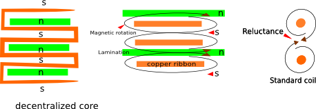

            OK more details
            My brother gave me a the transformer out of his old arc welder. it is a set of laminations +9.4"x5.4" stacked 5.5" thick I'm going to carve out the center to be 3" by 7" inside I'm going to use flat wire or rather aluminium flashing for the coils but bifilar and interlaced with the laminations. I've designed the pattern to have no reluctance between the Coils and to have 1sq foot of core contact for every inch of width the coil will also have the laminations arranged so as to complement the spin uni-formally see thumbnail. Using this formation for the collection coils I can use a single sheet of aluminium 6" wide and 50' long(one on each coil) without loss of induction due to the extreme width compared to the standard flat wires on the market. the control coils will use the same pattern but must be limited on how wide the sheets must be about 5/8" to 3/4" to retain induction as they must drive a field. Further more to limit the loss from the lapses in the laminations the open areas will be stuffed with trim. The final product will be about 3 inches thick. I haven't decided the strength of the magnets yet but I don't want to spend over $125 on them. I'm hoping to have this unit running on straight up house current at first but to be part of a larger operation once I start selling power to a power co-op a few counties down. The collectors are the equivalent of 3- 0000 cables So I should definitely bussbar it. That's the reason I was asking about jacking up the oscillation to try to get it to a virtual DC for inversion. The more oscillation the more power.
            PS I know this is pretty far out as a goal and it all depends on the first step but hey this is fun too.
