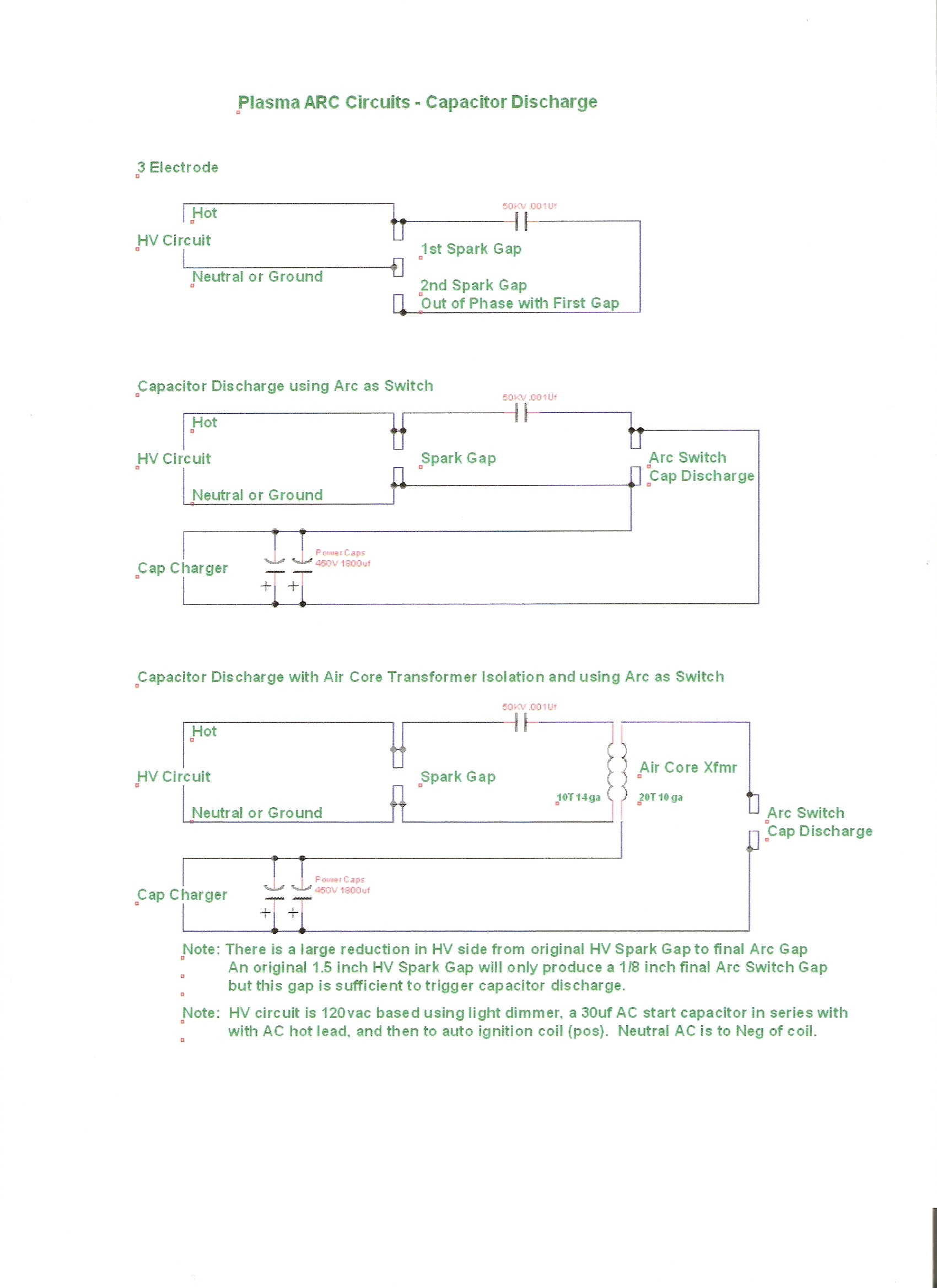

    I am starting with high current to create my plasma. The first challenge was to create a high Current Plasma Arc by tying together High Voltage with a High Current Capacitor Discharge. The three Plasma Arc Circuits I am attaching is how I accomplish this.
    The first circuit showed how to obtain 3 electrodes by using a 50KV isolation capacitor.
    The second circuit expanded on the first circuit by splitting the Neutral Electrode in two (by wire) and adding a Capacitor Discharge Circuit. This worked.
    The third circuit expanded on the second by adding an air core isolation transformer along with the Capacitor Discharge Circuit. This worked too.
    **** Test Result *****
    Capacitor Discharge Circuits were dissapointing. They worked but I only get a pulse. To be really useful, I need a continous Plasma Stream.

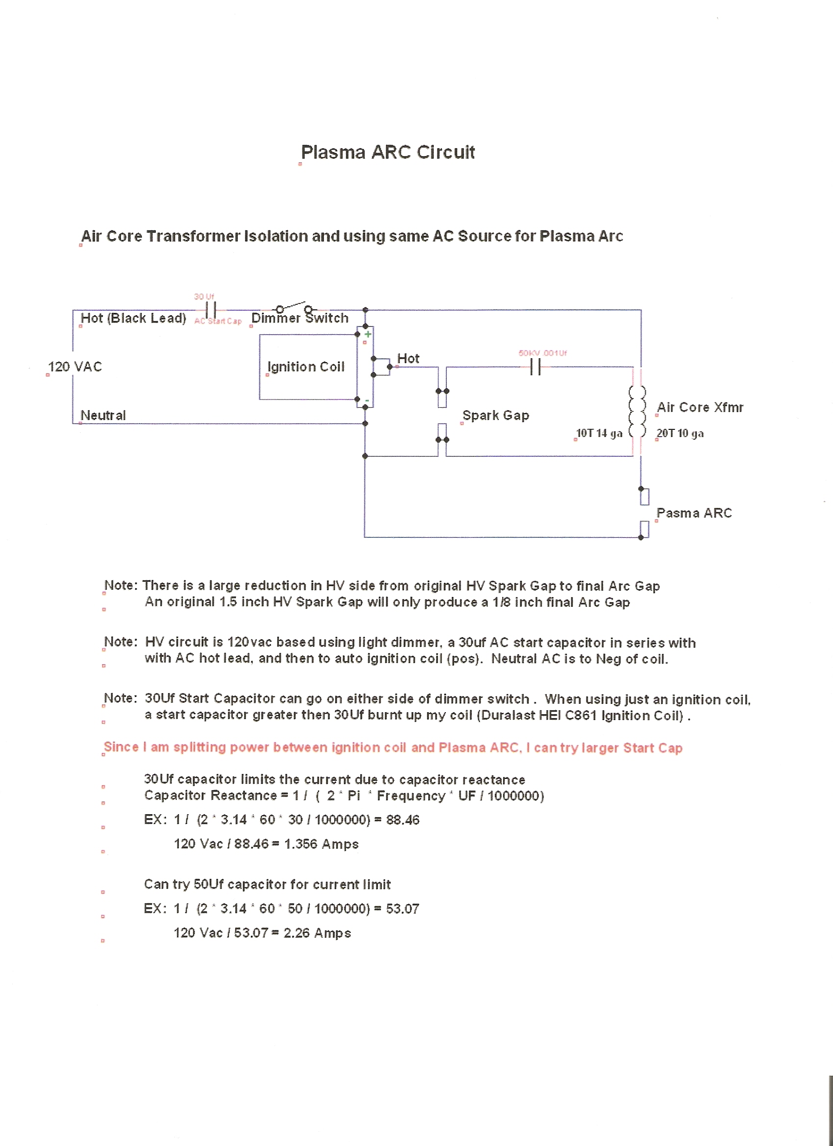

    I got Continous Plasma by modifying the third circuit. By dropping the capacitor discharge circuit and directly connecting the AC to the air core isolation transformer, I get a Continous Plasma Discharge.
    I still use the 50KV capacitor to drive the isolation transformer, but instead of merging the arc with the discharge capacitors, I directly connect the transformer to same AC source. Now I get to add the AC Current to the HV arc. WOW!!!!! The AC current I use is limited by the AC start Capacitor.
    **** Update ****
    What is really of significant importance, is the current limiting 30Uf AC Start Capacitor. This AC capacitor can be placed before (or after) the light dimmer switch. Wherever it is placed, it limits the current to the circuit by Capacitor Reactance.
    Capacitor Reactance = 1 / ( 2 * Pi * Frequency * Uf / 1000000)
    So a 30 Uf cap on a 60Hz circuit would be:
    1 / (2 * 3.14 * 60 * 30 / 1000000) = 88.46
    120Vac / 88.46 = 1.366 Amps.
    So the 30 UF circuit limits the current to the coil and Plasma Arc to 1.366 Amps.
    I had limited myself to a 30Uf capacitor, because, when I used larger caps, I blew out my ignition coil. But since I am now splitting my circuit between the Ignition Coil AND the Plasma ARC, I think I can upgrade to a larger value Current Limiting Start Cap. The limiting factor is now the 600 Watt light dimmer. I think I can pick a larger start cap and go as much as 4 Amps, unless I upgrade to a 1000 watt dimmer.

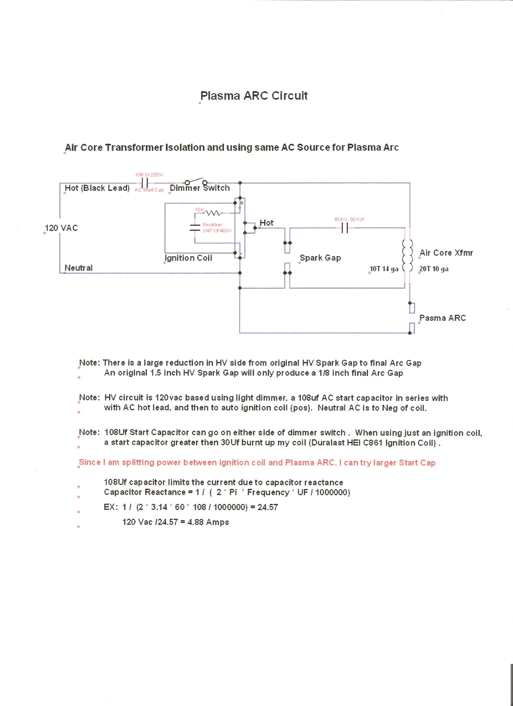

    *** UPDATE ***
    I changed to a 108Uf Start cap which puts the circuit at nearly 5 amps. The result was a larger plasma ball and burning sparks coming off the electrodes. More current = more powerful (and hotter) plasma.

        Added Snubber

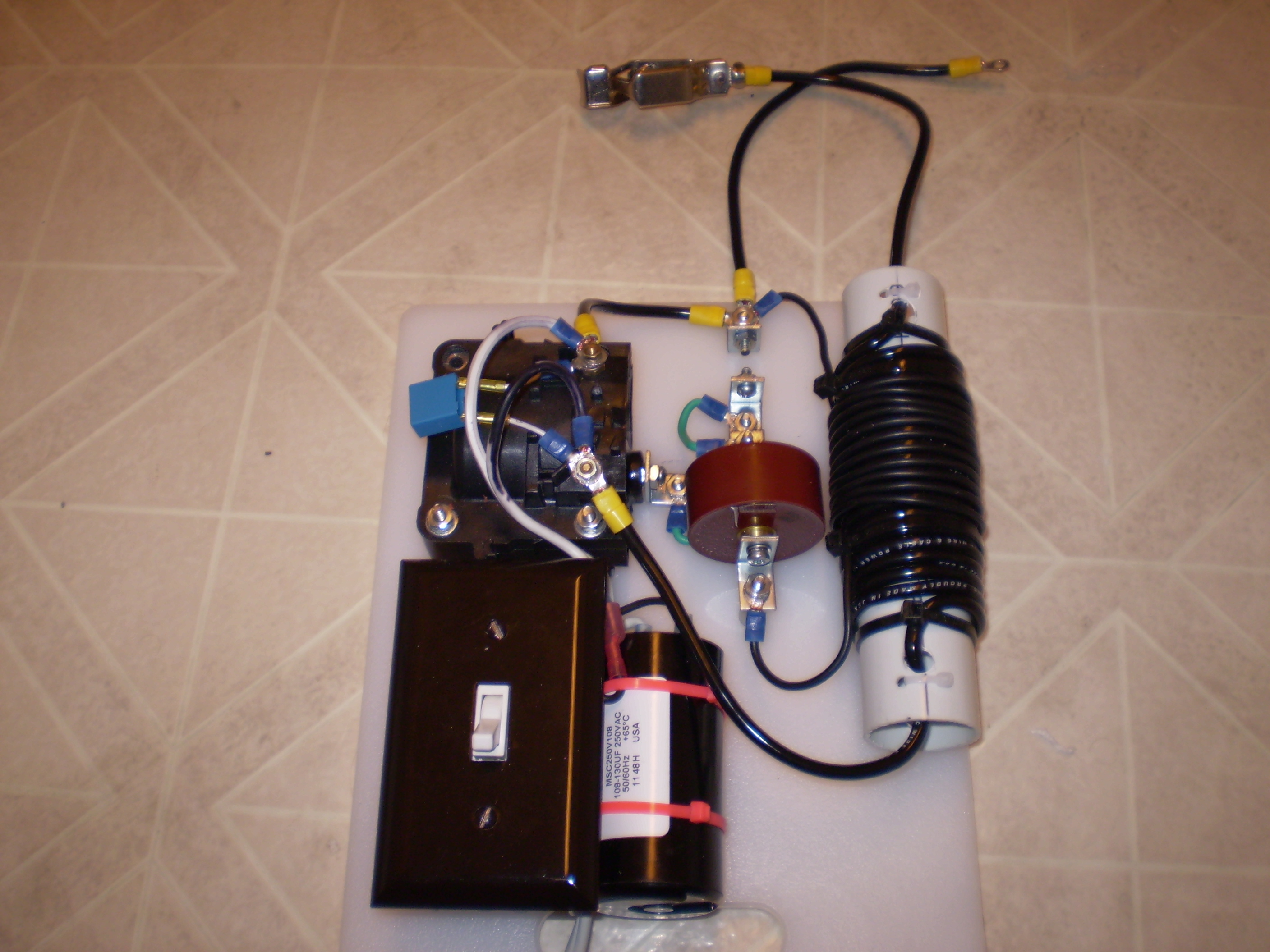

        I rebuilt my board using the 108Uf AC Start Capacitor to limit the current to 5 Amps. Turns out 5 Amps is powerful enough to erode electrodes and burn anything close through radiating heat.
        I am updating my circuit to include a snubber on the coil to absorb spikes.
        The attached are the new circuit and a picture of the 5 Amp board.

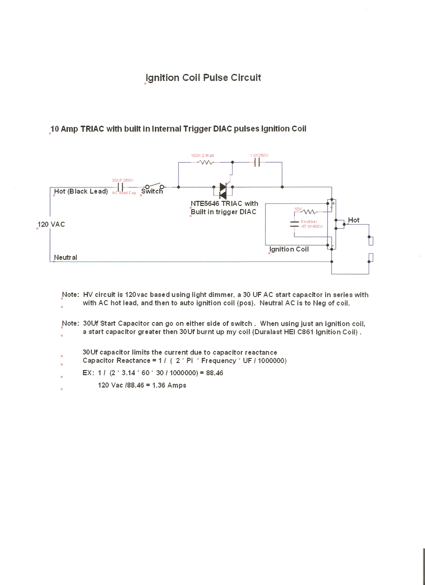

          Replaced Dimmer Circuit
          I pushed the circuit to the limit and burnt up the dimmer switch.
          I found that I can replace the dimmer switch with a TRIAC based pulse circuit.
          The TRIAC (NTE5646) is 10 Amp capable and has a built in Internal Trigger DIAC which simplifies the circuit. That plus an on/off switch, a 100K resistor, and a .1 UF 250V capacitor is all that is needed to have a solid state pulse circuit for an Ignition Coil.
          The attached schematic shows how to hookup the TRIAC based pulse circuit.
          *** Update ***
          Tried different RC values for TRIAC to see which gave the smoothest spark gap. I didn't feel like updating the schematic. Got the smoothest result with 100k and .039UF 200v timing cap. Could use 39k & .1UF to get the same math result:
          1T = 1000000 * .039 / 1000000 = .0039 Seconds Or:
          1T = 39000 * .1 / 1000000 = .0039 Seconds
          *** Update ***
          I did some more testing, using different ignition coil and different AC start capacitor (To limit current). I found that the RC values used with the TRIAC are dependent of the coil and current provided by the AC start capacitor. Switching coils types and increasing current required different values for the capacitor and resistor used for the TRIAC gate timing. Too high of a resistor and it won't turn on. Too low of a capacitor and it won't turn on. You will have to test different values and decide on the right combination for your hardware.
          If you increase the current available (larger value AC start Capacitor), then you need to slow the RC timer by increasing the values of the resistor and/or capacitor.
