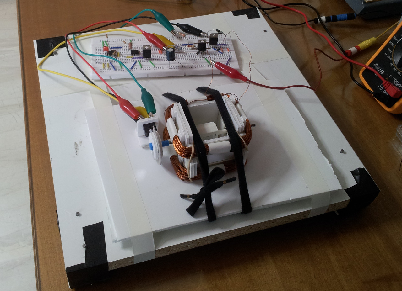

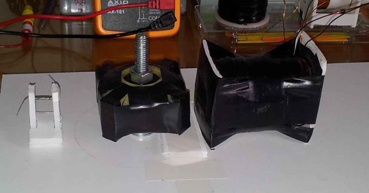

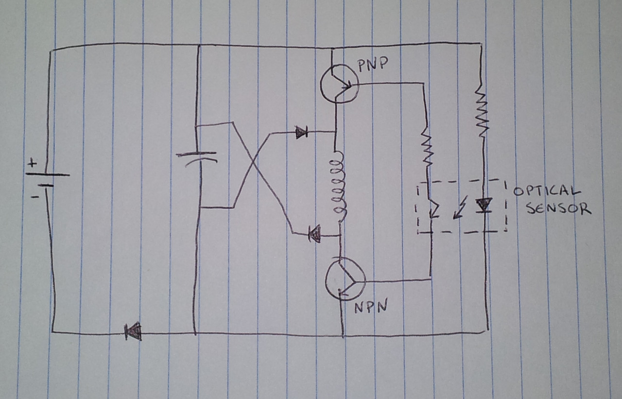

    I have built a small model (shown in the first picture) in order to get a basic understanding of it's operation and to test out a few things. Ideally I would like to capture the collapse of the magnetic field when the coil shuts off and reroute this energy back to the motor for usable torque, and do this in the simplest way possible partly because my knowledge on electronics is rather limited. To do this so far I used the circuit on the second picture. The transistors I use are TIP32C and TIP31C, the source is usually 12V power supply, the diodes are 1N4007 and the capacitor and resistors I vary. I used this circuit on a simple pulse motor design (shown in the third picture), consisting of a skateboard wheel with 4 magnets glued on it as a rotor, a coil as the stator and a reed switch for triggering (instead of the optical switch shown in the schematic). With this motor the circuit works fine. With the feedback loop the input power drops by ~30%, the rpms increase slightly and the transistors remain cool. In the keppe motor model though there doesn't seem to be any difference if the feedback loop is closed or not, and the transistors get hot, especially the NPN TIP31C. The behaviour is similar whether I use an optical swith or a reed switch. With the optical switch the duty cycle is about 33% and the waveform across the coil is shown in the fouth picture. Also when I load the shaft of the motor the input power remains stable independantly of the load.

          Hello level. I am aware of the similarities between the keppe motor and the newman motor as well as the bedini-cole window motor. Here is an explanation from the keppe motor group about this subject: Basic Differences between Newman and Bedini-Cole Motors and the Keppe Motor. As far as I have understood the keppe group claims that the motor implemented in the fans they manufacture is highly efficient (up to 70%), especially considering the simplicity and the low cost. They have made claims about overunity results using a more advanced system, which they call turbo system, that uses relays. As far as I'm concerned I just want to build the best that I am able to and conduct some proper tests to measure efficiency. Thanks for the videos. The first one I am already familiar with. The second I hadn't seen and looks interesting. I was thinking that at some point I should probably replace the transistors with mosfets, it's just that I understand how to use transistors better. Also in his circuit the energy recovery is external, meaning that it goes to charge a capacitor or a battery or light up a neon bulb and not rerouted back into the motor. My goal is to reuse this energy back to coils of the motor as to increase it's efficiency.

                      I like your method of harvesting the BEMF, why did you use the lower isolating diode instead of charging the battery ? higher efficiancy ?
                      I'm making another Keppe version with 2 sets of coils 90 deg apart & want to use as a stepper motor, however 2 H bridges raises the complexity.
                      PeterK
                        Hello PeterK. I usually run the motor from a power supply so no need for charging. Also even when I use a battery, from what I have read from Bedini technology, it's not very efficient to charge the battery the same time as it's discharging, though I haven't tried it myself. Anyway the circuit will probably change as I progress so any ideas are wellcome. I was also thinking at first about 2 sets of coils but I decided to keep it simple for now. I will be interested to know how your project evolves.
