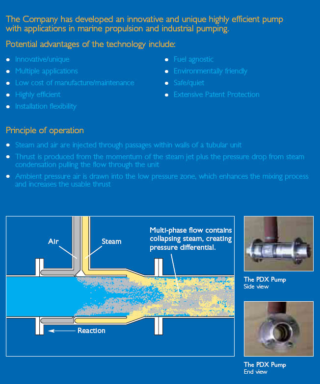

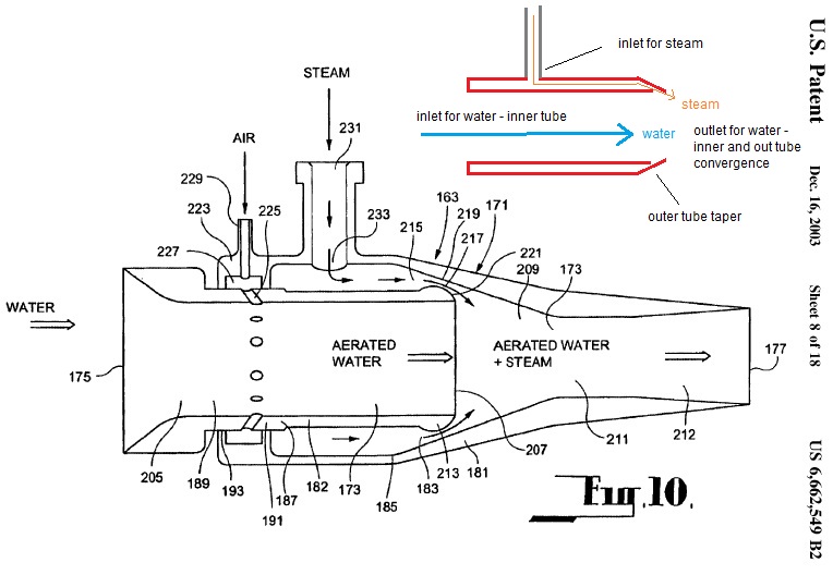

    Unfortunately I do not have any more photos. I crudely and simply tried to follow the diagrams and patent drawings of the jet. The main things to consider:
    There were a lot of both pressure and temperature leakages through out the setup. If you have a way to weld and cut aluminium with the appropriate mix of aluminium tubes then you could have a lot more fun than I did.
    BTW - I did not even have to aerate the water in my test to get it working. Aeration improves the steam/water mix thus giving it more power and efficiency.

          In effect the air creates turbulence in the mixing chamber which allows for the steam to more effectively mix with the water. Without the turbulence the laminar flow of water will only collapse the steam around the circumference of the steam outlet of the mixing chamber. I found that during the tests I did the steam would often 'flashback' into the steam chamber. The aeration mixture I would assume would prevent this while also distributing the steam within the mixture chamber so that the vacuum would be centred. This is my assumption anyway.
          Here is another view on it.
          Also, using plastic has its limitations due to melting but it could work for some initial experiments.
