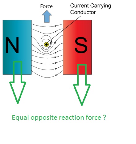

    Hi
    i have 2 questions regarding Lorentz force
    1. Does Lorentz force create opposite and equal reaction force acting on magnets, as you can see on attached picture <?
    2.Does conductor moving in homogeneous magnetic field consume more power than static condtuctor to achieve same continuous amperage? Does the wire movement increase power input <>?
    Thanx for clarification

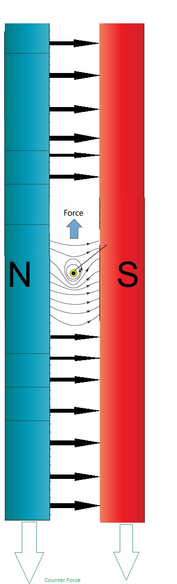

    But in general terms...and relating to Lorentz...looking at the picture you have shown below...North facing South...and a conductor traveling "sandwiched" between (centered)...is a Classic One...that defines Straight/Symmetrical Magnetic Patterns...when in reality... it DOES NOT need to be seen ONLY that way...as the ONLY WORKING Model possible in 132 years...
    [IMG][/IMG]
    North-South could be right next to each others,side by side (As shown in Picture below)...and still generating a strong magnetic field...BUT there... will NOT BE a straight vector of force (Lorentz)...between them two...but a "CURVE"...and still conductor will get induced...by either one moving related to the other one...
    BUT that concept...is Asymmetrical...and linear Vectors, or rigid Tensors...will definitively not work to calculate the Forces...
    [IMG][/IMG]

          ok , can we stick to my question, to my picture
          2 magnets, 1 wire fed with DC
          when wire is not moving 1 amp dc is flowing
          when wire is moving 1 amp dc is also flowing
          will the movement caused by lorenz force change the power input (in this case voltage) compared to scenario when the wire is not allowed to move ><?

                I understand your confusion here as the information you are getting is contradictory and I think that is the problem. Now look at the picture again, is the field homogeneous?, well no it is not hence the contradiction.
                i made new picture to better illustrate what i mean homogenous.
                Of course in the close vicinity of wire there is field distortion and interaction between 2 fields, but before and after this point, the magnetic field between N and S is stable, homogenous
                If we replace the wire with another magnet will it move?, and where will it move to?. It will move to the edge of the stationary field of lower field density which is exactly what the wire will do and then it will stop moving.
                We should remember that the wire and the current flow in it is not the motivating "force" here. The magnetic field of the wire in itself interacting with the external magnetic field is the only motivating force available.
                i dont think you can replace single wire in this orientation with permanent magnet, it will have different lines of force, it will not behave same
                single wire has only one way spin around conductor, resulting in up/down force interaction
                To answer your question outside the context of the picture posted, will the wire move in a perfectly homogeneous and infinitely large magnetic field?. I do not believe it would because the motion relates to the field density. In reality there are no lines of force and we are dealing with a gradient of force due to a difference in field density.
                Now if we are saying the field is perfectly homogeneous then what we are really saying is that there is no gradient thus there is no gradient of force to act upon. It is like saying will a balloon filled with helium rise in the middle of outer space, well no there is no "rise" because there is no "up" or "down", there is no motion because there are no forces which could cause motion.
                i think wire can move in homogenous and stable magnetic field
                once current starts flowing, field is distorted at that point, not homogenous, resulting in new forces acting on the system
                new magnetic field around wire creates "gradient" , non homogeneous area, where forces can act
