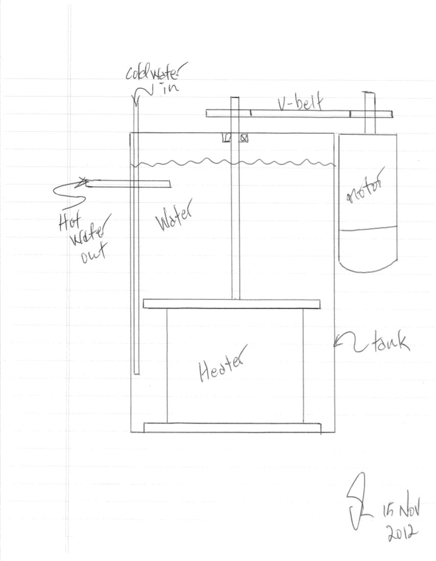

            Water Heater From Friction Heater
            Hey Slapstick,
            Just thinking out loud that you could immerse the friction heater into a tank of water and send the hot water produced to radiators in other parts of the house or to a radiant floor heater.
            Quick sketch attached.

                  Originally posted by Vincevl View Post
                  Hey Slapstick,
                  Cheers,
                  Vince
                  [ATTACH]12450[/ATTACH]
                  Hello Vince
                  Its funny you made mention of this. I am building one just to be heating my hottub
                  Thanks for the feed back
                  Gabriel
