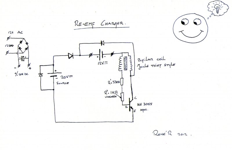

    I've got a little something for you....
    How about a very effective , easy to build battery charger that uses the applied energy not only super efficient, but in a sence twice !
    A charger that can charge, non rechargable battery's , rechargable battery's , lead acid battery's or Bedini's cristal cells. Without heating up the battery.
    Restoring almost dead lead acid battery's if left charging over night(s), desulfating them.
    Cost of the circuit... around 2 dollars... Now thats fun !
    Enjoy !

    Thanks I will try that any variables like I want to charge my 7amp lead acids so how big the coil should I make ..to have it charged faster
      Good to see you posted it here and thanks for including the schematic as the one I tried saving off the video wasn't very clear. I haven't looked back at the other thread but it may be helpful here to to answer what type of coil core you used as in how many turns, type of core, toroid or straight etc. Other than that it looks very straight forward and a fairly easy build. I've certainly got a lot of batteries in need.
      edit: I see another member built your circuit and was very impressed by it. I picked up some answers to my questions from his build and since I've got a 2n3055 I certainly don't have any reason not to try this soon. Sounds like a really great setup. I hope he jumps over here or maybe a moderator can combine the two threads.

          Yes I used a 2n3055 transistor... I want to try a few different ones. Ive used 2 different toroids, first was about 3/4 of a in in dia bi filer wound. The second was 2.5 in and quad filer. Both were impressive the larger toroid was toucher. I was hard to find a sweet spot between charge rate and the heat in the tranny.
          Then I got the idea to use a Bedini monopole style coil. Bi filer with 23 and 26 awg wire approx 850 turns (I lost count when I wound it). This required no resistance. The diodes get warm put 2 in seres were the coil back feeds to charging battery. The coil gets barely warm the transistor stays cool.
          I want to try a ferrite core a air core and bigger wire. Also a few different toroid windings. The charge rate on a good battery is staggering and on first charge yielded a higher voltage than Ive ever seen on that battery with bedini ssg or conventional. Currently trying to desulfate a bad battery.
          Will post some test data when I have enough to post. Definitely worth playing with if you need a efficient way to charge a battery. Never seen it draw more than .54ma Seems the more charged the battery the higher the draw. Im running a steady 19.5 volts through circuit.

            Sounds very good. BTW did you mean you never saw it draw more than 0.54 ma or 54 ma? If it's less than 1 millamp draw that would be really amazing but I'm guessing you intended 54 millamps?
              I built the circuit and on my first very dead battery it was running fine although I'm not sure it will save this battery that I've tried for years to recover. Started at 1.8 volts (a 12 volt SLA) and I was seeing around 5 to 6 volts after just a few minutes of charging and a minute of being off the charger. Everything stayed very cool with that battery. But then I put a riding mower battery on it that had been sitting around 9.5 volts and was run down in electrolyte to below the plates. I refilled with just some distilled water to try this. I hooked it up and was almost ready to walk away for lunch when I smelled that hot electronics smell. I touched the top of the 2N3055 and almost burned my finger it was so hot. I'm not sure where the 1K pot was set at and when trying the first battery I put a scope across the output and adjusted full range on that pot without seeing any difference in output pattern or voltage although that first battery probably had very high internal resistance. I'll try later setting the pot to maximum later. I've checked the pot and resistors to make sure they were correct values. All the diodes seemed cool enough. The one I have across the source input of 20 volts is a very high amp diode. In the couple minutes I had it on the mower battery I saw it come up to over 12 volts but I didn't wait but a few seconds to see if it held. I'll post later if it seems to be recovering and holding.
              A couple other notes - on the first battery I was seeing 28 volts across that when charging. The second battery started around 20 volts and rapidly dropped down to around 12.7 volts. I'll take that as a good sign that I may recover this one. Also the power supply I'm using is an isolation transformer with about 22 volts AC 2 amps with a bridge rectifier and a 680 uf 250 volt electrolytic. I did put an o-scope across the output on the first battery but wasn't seeing anything over 5 volts peak to peak.

                    Turned the base resistance on the pot all the way to 1K but the transistor was still getting too hot within a minute. Added another 1.6K Ohms but no difference. Added an inductor but no difference. Put a resistance between the collector and coil but still got hot so finally I put about 35 Ohms after some trial and error between the emitter and power supply and that was the only way it wanted to stay reasonable. Also put a heavy heat sink on it which seems to work. I'm just shooting in the dark here so if anyone can suggest a better way I'm listening. My bifilar toroid coil does only have maybe a total of 20 or so turns on it with some 18 guage. Using about a 30mm diameter toroid. Also I'm just seeing a clearcut sawtooth pattern in the DC output that only has about 30 mv peak to peak on the battery that seems to be taking a charge (mower battery).

                          With 2n3055 the low frequency and high amps draw causes overheat , so only way is to increase the number of winds and that changes frequency , best is to wind more and have taps on primary ... For different resistive loads..or use less amps but how?.. I am also stuggling on joule ringer...
