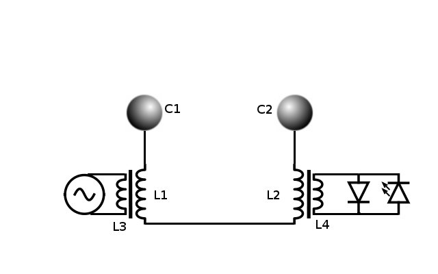

    As I have done a very similar experiment myself I will present my findings.
    The set up is as follows
    (see Meyl1.jpg)
    When L2 is at resonance the LED shines brightly.
    To understand why, we consider the following.
    Because L2 is at resonance, it does neither act as a inductive nor capacitive load. So when considering L1 we do not have to look at L2 and everything behind there.
    This leaves us this:

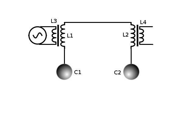

    (see Meyl2.jpg)
    L1 creates a voltage difference. Having a higher capacitance at one end, this results in higher voltage (swings) at the other end. So what is intended as a ground line actually becomes a transmission line. And of course, shielding C1 or C2 has absolutely no effect!

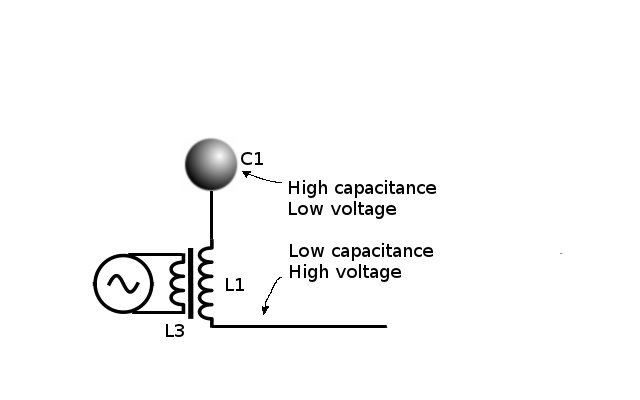

    (see Meyl3.jpg)
    Removing the diodes means that much less current can flow in L4.

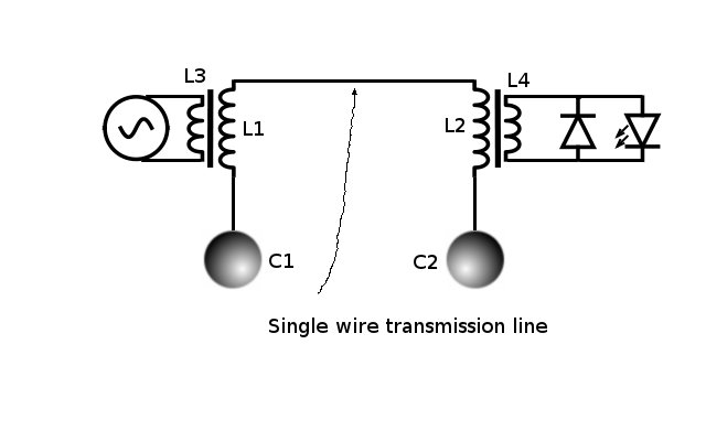

    (see Meyl4.jpg)
    This increases the inductance of L2 (see Colorado Springs Notes of Nov 9, 1899), giving a lower resonance frequency. This results in an inductive load on L1, disturbing its resonance as well. Not because the sending antenna 'feels' the receiving circuit.
