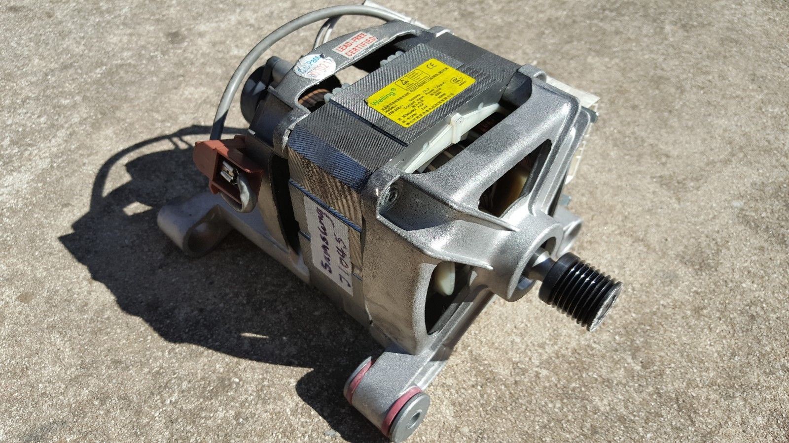

            • Ac Series Motor
              Hi Guys,
              Is this what I am looking for. Series AC/DC motor. Not that anyone calls them that. I take it that there are two coils in the armature that are series connected and separated in the middle by the brushes? Get dual outputs.
              • Yes, that is the kind of motor you want. You will of course need to go back and read my post on how to modify it to work as a part G. The field coils are not used.
                Carroll
                  Carroll
