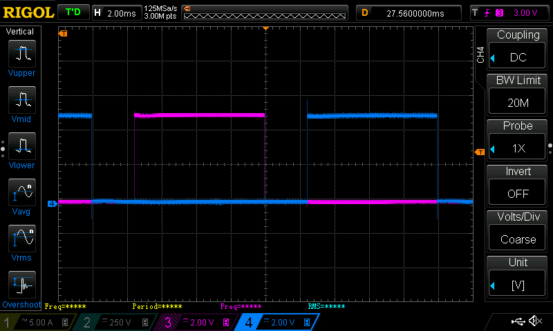

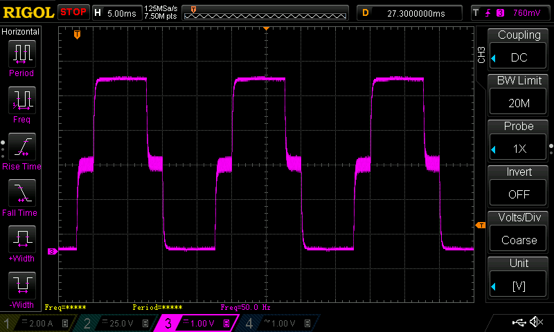

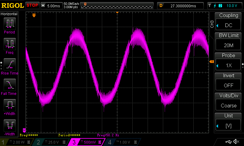

Please see attached scope shot and supporting arduino sketch. This provides the waveform you require.
All the airgap does, is reduce the flux linkage not eliminate it, assuming that the exciter coil/cores do not totally cancel out variations in the flux level in the cores.
L192Attached Files

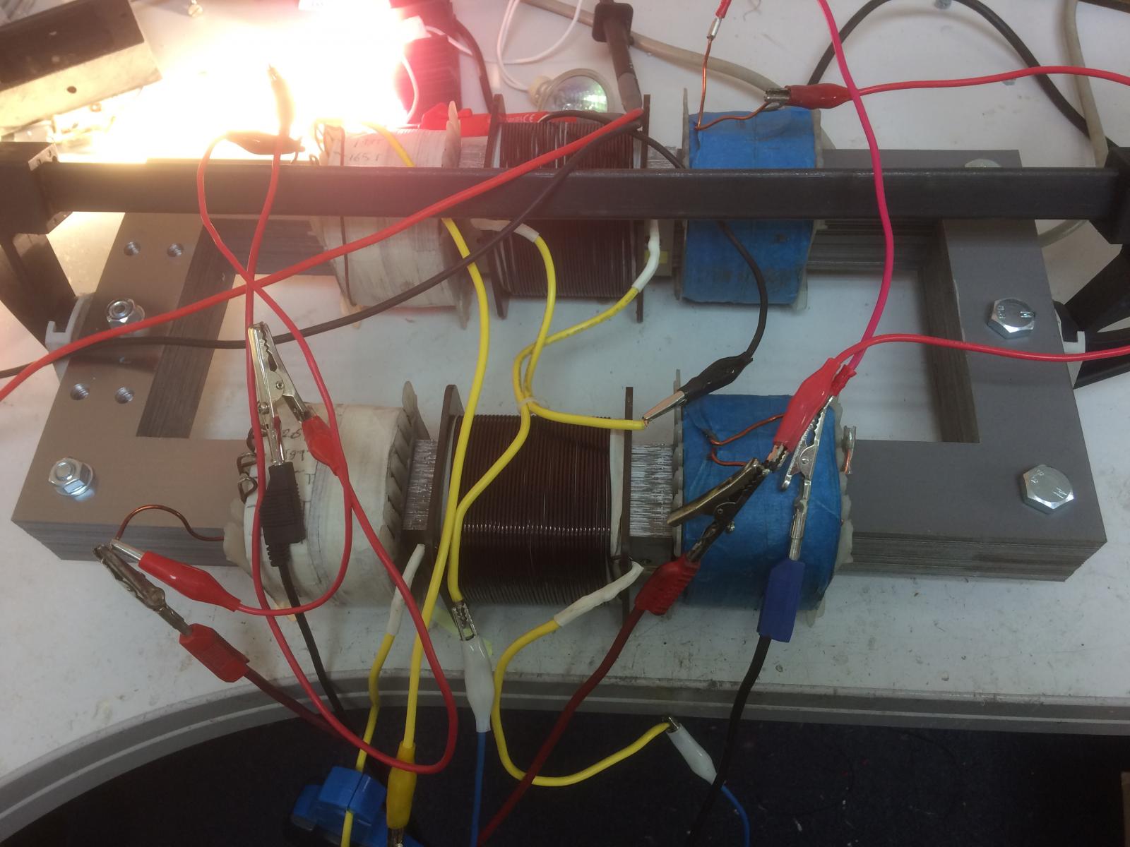

U core setup
I should add the coils on the left are in parallel and the coils on the right are in parallel.
One interesting point.. if you place a hall flux sensor on the outside of the U bend, you see virtually no flux change. If you place the hall sensor on the output cores you see a sine flux.
L192

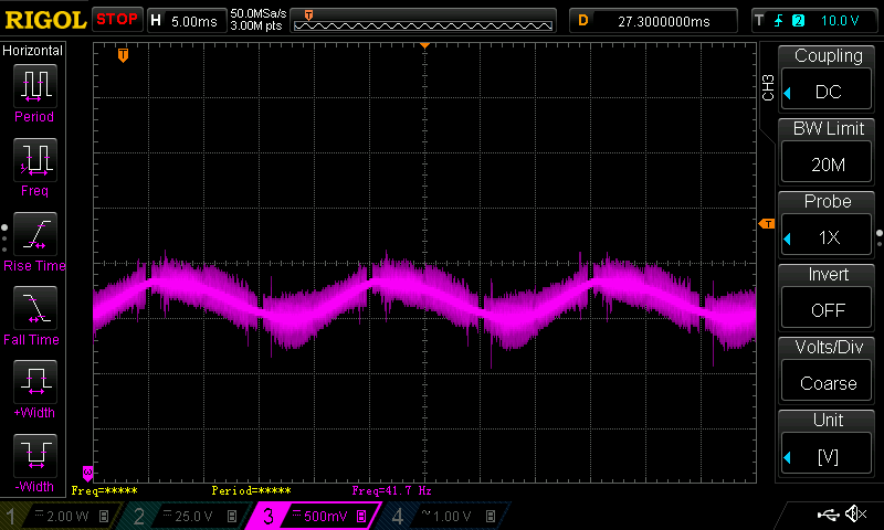

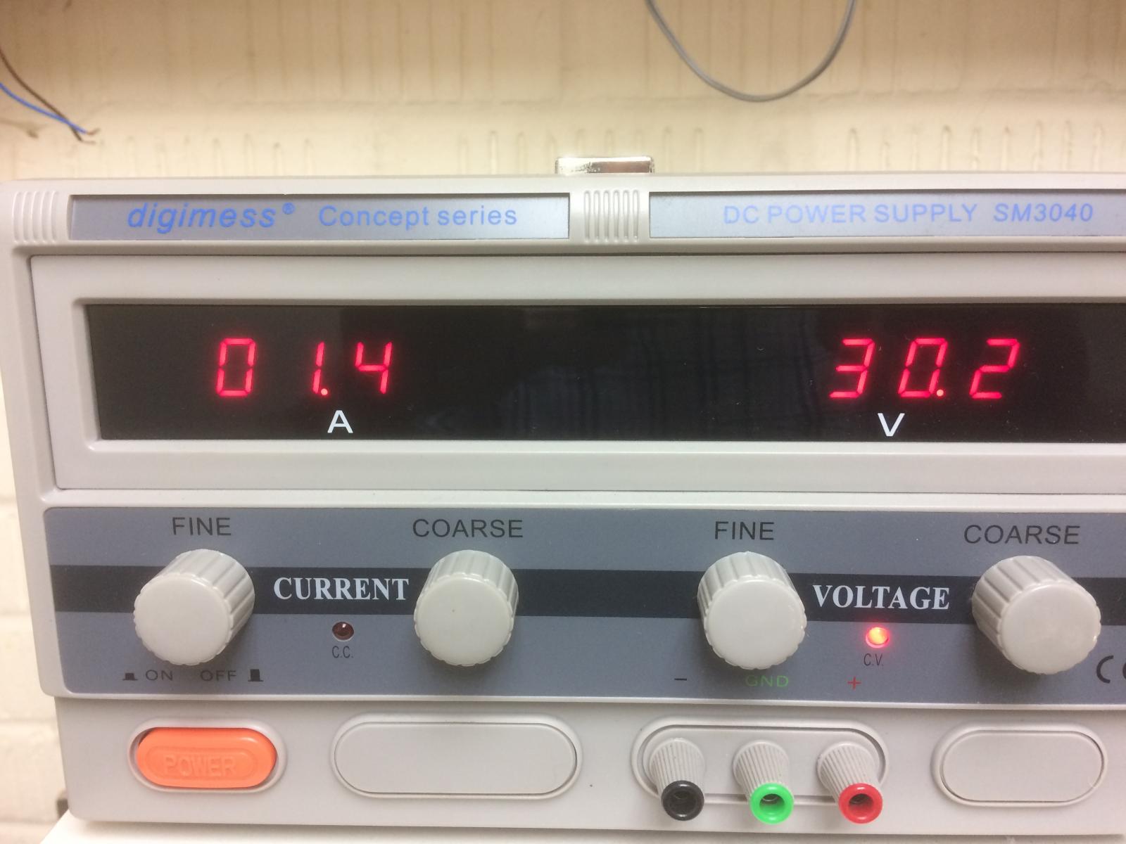

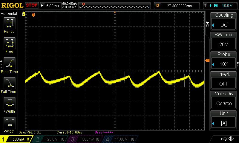

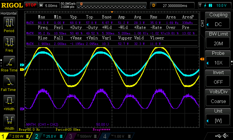

My two core section are of different steel. the one on the right is M-400 and the one on the left is M6.
This got me thinking about balancing the exciter coil currents as close as I can.
Playing with the coil taps, resulted in a reduction in output power and input power but I did get the currents balanced within 0.5A. See attached scope shot. This still equates to about 13W of output power due to flux linkage
Also see attached DC supply input power = 42.28W
Output Power =35W RMS
Approx 13W of output power due to flux linkage as a result of imperfect cancellation.
I have also attached Hall Probe flux scope shots which show relative flux variation. The flux variation at the end of the U core is very low, whereas the flux variation in the output core area is substantially higher.
Note: For an actual flux measurement, the probe needs to be placed in an airgap.

short Magnetic Circuit larger exciters

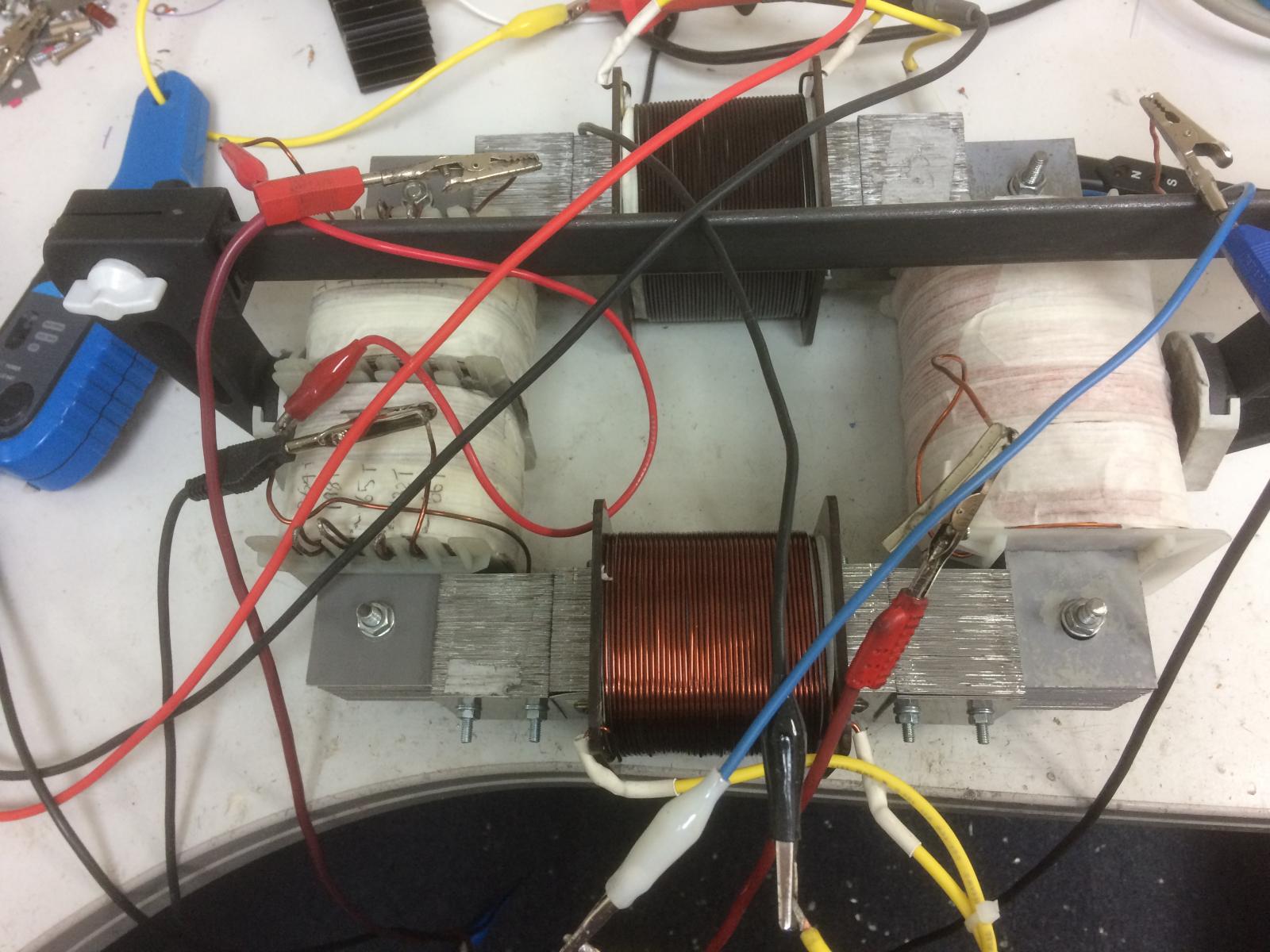

I thought I would try a shorter magnetic circuit and run two of the exciter coils I used previously in series. Using same DC biased 0 sine/180 sine waveform. The reason for this trial was to reduce the off load magnetizing current by increasing the inductance of the coils.
See attached photo.
No load DC input: <5W
On load DC input: 55.4V x 0.91A = 50.4W
Load: 43W RMS
Shorted Load DC input: 55.4V x 0.5A = 27.7W
The exciter coils being further away from the output coils generate less output.
In/out ratio was about 0.85, compared to the large U sections when all 4 exciters are driven of 0.83.
Because of the larger coils I increased the power supply voltage from 30V to 55V but there was no saturation so it could have driven at 80V or even 100V, with power increasing in proportion.
L192
Arduino sketch for UFO's new waveform

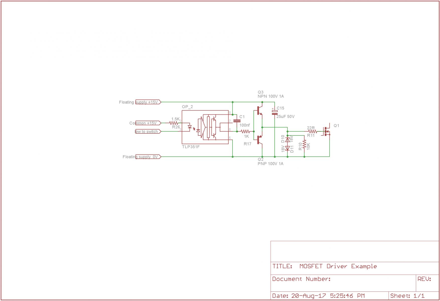

For anyone that wants to experiment with UFO's new waveform electronically, attached is an arduino sketch that outputs TTL pulses on digital pins 12 & 13 with the correct 135/45 degree timing.
The easiest way to use these is (via a suitable driver circuit) for one to drive a MOSFET connected to the + rail and the other to drive a MOSFET connected to the - rail, with the common source/drain connection taken to the coil. The other end of the coil connected to ground.
I have attached the driver circuit that I use. It does need to be used with a floating DC supply (per driver). I designed my own using a simple inverter and pot core, with secondary per output, FWBR, smoothed and regulated with a 7815.
L192
Thanks L192,Originally posted by Listener192 View PostFor anyone that wants to experiment with UFO's new waveform electronically, attached is an arduino sketch that outputs TTL pulses on digital pins 12 & 13 with the correct 135/45 degree timing.
For all your time dedicated to build this signal electronically...nicely done!
I am really sorry, but have to disagree with the bold out, basically the underlined part above, by me...and it is ESSENTIAL, that you understand what is going on here.Originally posted by Listener192 View PostThe easiest way to use these is (via a suitable driver circuit) for one to drive a MOSFET connected to the + rail and the other to drive a MOSFET connected to the - rail, with the common source/drain connection taken to the coil. The other end of the coil connected to ground.
L192
You can NOT have one end of coil connected FIXED to ground!!
The Exciter Coil must receive at terminal#1 a Positive while terminal#2 Negative in ONE CYCLE.
However, in the following cycle, Terminal#1 Must receive a Negative while Terminal#2 Positive.
This will cause a TRUE FIELD REVERSAL of EXACTLY the same magnitude, except their Spin DIRECTION would be completely opposed.
Example: Coil CYCLE1 would produce a N/S Field, and in CYCLE 2, same position coil would be S/N.
This is the reason that I went through so much trouble making this new kind of Slip-Ring-Commutator Rotary switch, which could feed not only one exciter coil, but many more, as we could alternate the way each cycle produces its Magnetic Polarization's PER EACH EXCITER COIL...by just reversing the SAME SWITCH Terminals connections related to the way coil is wound (CW or CCW)....or even more simple by just reversing the physical positioning between two interacting coils, leaving all same wound directions plus same terminal connections...
Hope you understand what I meant above.
