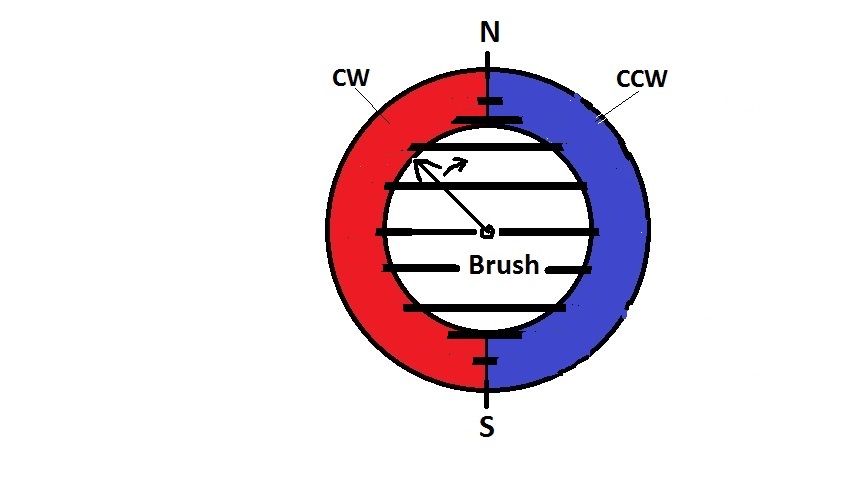

    Look at this diagram.
    Notice that as shown, the brush is positioned directly on the winding (or loop) which is connected directly to coil N. So there will be little if any current limiting from part G unless you're in seaad's frequency (RPM) range.
    Yes, agree at this point no inductance is acting -into Primary N- as it is a straight contact to it...logical....but it IS Acting on Primary S.
    This means, at that point, only the impedance of coil N limits the current. I think Cornboy said he'll wind his coils with the same flat wire. That will yield very low resistance and inductance.
    This boils down to very high current spikes at that point in rotation. This may be difficult to differentiate due to the high current all around. I believe that on Cornboy's part G the inductance will be very low due to the low number of turns of the flat wire and at least on several brush positions the inductance will essentially disappear to the geometry of the winding and core.
    Since it is unreasonable to expect RPM high enough to get reasonable reactance, he'll have to use very low voltage to keep current low enough for his brushes to handle.
    My predictions. Let's see how the test goes.
    I agree with higher current requirement as low inductance...as per coarse wire and only few turns...nothing new here...

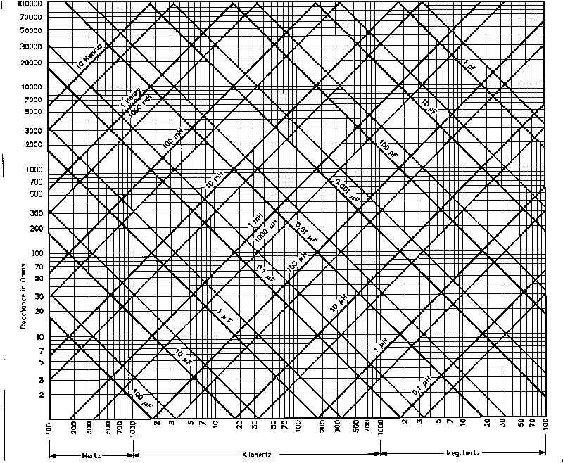

        Hello guys/ tinkers please go and buy yourself an inductance meter!
        Then you can use a "Frequency - Reactance Nomograph" see pic!
        Regards / Arne A

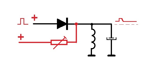

            I would like to add a Cap at each coil on the Primaries of very low capacitance value, but rated for the correct amperage and voltage...what I am trying is for the Magnetic field NOT TO COLLAPSE in FULL, when Coil is disconnected...but just keeping a reminiscence of a weaker field on core...I know I will be creating a "Tank" LC Circuit There...but since the capacitance is low, it should not have any conflicts with the constant driving Currents and voltages...
            Like I wrote before...all I want is for a weak field to still remain ON when Coils are off in the sequence...
            I was thinking an Electrolytic Cap...but then I thought about an AC Cap, so it also attenuates the back spike from going to commutator or source...
            Am I going the right way here?
              At that position of the brush I contend there are 2 equal but opposite paths to coil S. Therefore part G inductance cancels and part G equivalent resistance (which is 1/4th total G winding R) is all that part G will contribute to limit current to S. Not much.
                But then again Bistander...you are analyzing this scenario in a "pause" meaning static fashion...therefore you are only seeing "static resistance" (which is nada) but what happens to the Inductance that has been developing from previous run...plus continuing after passing N Contact?
                Will it just vanish or drops zero when contacting N?
                Or would it continue its path?
                IMHO this is a Dynamic Component...so we must consider its dynamic parameters...
                So, according to you, more turns and finer gauge would do better on Part G?
                Regards and please whenever have a chance, take a look at previous drawing.

                  Hello Bistander and Citfta,
                  After You guys review my design above...which I have tested and it works (and yes, I also feel that "motoring force".....however, I am still not happy with it.
                  Thanks in advance
                  Hi Ufo,
                  To me it sounds like you want to bias all the 8 primary coils with a low DC. You may be able to do that with capacitors but I'd start by using the existing DC source and adding circuits. This way you can control the bias and keep it steady for experimentation. Later, once you get the level you need, look at replacing with caps.
                  I'd use a single pot or variable resistor off source positive. Then slpit the reduced voltage 8 ways, one lead to each primary coil thru a diode. Keep your main coil feed (from the comm) between the coil and diode so it doesn't backfeed.
                  Using the pot you should be able to bias all the coils equally at a percentage of the full switched current.
                  That would be my first attempt were I building the thing.
                  Good luck.
                  ps. Of course I disagree with you about spinning fields, but we all are entitled to our own imaginations.

                    Ufop; "I would like to add a Cap at each coil on the Primaries of very low capacitance value, but rated for the correct amperage and voltage...what I am trying is for the Magnetic field NOT TO COLLAPSE in FULL, when Coil is disconnected.."
                    See pic! Arne
                      See pic! Arne
                      Hello Seaad,
                      Yeap, thanks!...think that should work, smooth decay plus diode will prevent back spike.
                          Hi Ufo,
                          The frequency is too low for the inductane to play a significant role. Adding turns will increase inductance and lower required frequency but I see other issues which will prevent the behavior you're expecting. I don't see a "self commutated" part G as a viable reactive solution. Possibly resistive, but not using reactance as shown on the toroid core.
