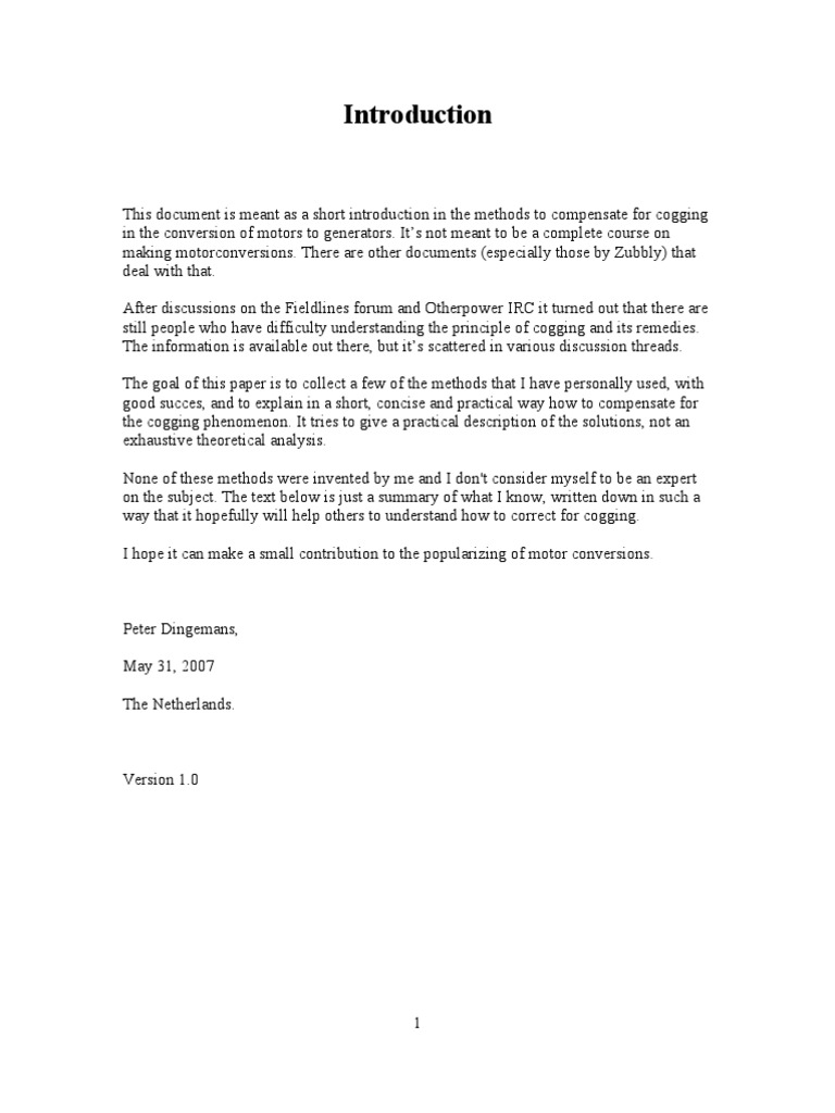

Lenz Force and Repusion Fields...
Hello to All,
Been busy for a while, and just a few minutes to post about Lenz and its relation to Repulse Forces...
First, in a Repulsion Field we have -at least- Two B-Fields facing each others, and while many have written that they cancel...I do not think so...B-Fields, considered Vectors of Directional Force are there at all time during repulsion interactions, causing the compression we all feel...don't you think if they would cancel...we'll still be able to feel this magnificent forces fighting each others?
The ones that we could say that "apparently" Cancel...are the N-S Vectors in Attraction, actually not cancelling but giving birth to a new Field of different and greater geometrical configuration as the two originators...
In the Figuera case, we have that same High Compression Repulsion Field exactly at the center of the secondary core, and as we displace N1-N2 in unison (if we do not keep them in unison, the centered field will loose compression, and induction will drop) the compressed field would move through secondary core and coils back and forth generating an induction.
Lenz, in this kind of induction would have to "split" in two vectors, To a "Dual Travel"... depending on the compression field displacement, therefore Lenz would tend to cancel to zero in every back-forth displacement (which represents a full cycle here) of the Virtual Repulse Compressed Field movement.
This Thread would just be opening "the gates" for the new approaching horizons and future possibilities we never had before, or never thought would be ever possible at all... related to the old concepts like: "Induced EMF", "Lenz Forces", Cutting "Imaginary Lines of Force"...etc,etc
If you want to do another experiment...just take off that iron core from the secondary...then start moving the compressed field at primaries coils-cores...and would observe almost no induction at all compared when iron was present...now what does this tells you?
Does it tells you the Imaginary Lines of Force were still "Cutting" the conductors now?...and they supposedly were doing so...but why no induction now?
This simple experiment tells you very clear, that induction starts at Iron Core first, then it transfers to copper coils...simple.
Regards to all
Lenz force
@Mario
Hi , well my thoughts were along the same line as you about the Lenz force when I first tried the experiment that was given . I used two coils with a NN on one and a SS on the other and had a magnetic closed circuit . With moving the rods through the coils I got a induced voltage as described . I used only one coil and had the same result . Then I thought that as you to short circuit the coil and see if I could detect Lenz force . I could not , with either setup , single or dual coils .
After reading your post I thought hat maybe I was mistaken so I tested it again and again I could find no indication of Lenz force .
I must say that this is a crude test but with more accurate testing you my be correct . But for with what I have here it is not showing .
I don't have a finished device to test with so I can give no affirmative answer as to the complete function of the generator . But MM version that he built and tested with results would indicate that it is not present on the input side of the device .
So I would say that it is not confirmed that Lenz is present
In this device without more tests . And I plan to continue with it . Others can make up there own minds and act in accordance . You may disagree with this , but I replicated he experiment with very strong neo magnets and could not reproduce your results .
Jeff
posting of pics
Hanon;
easier to click post reply.
type reply.
go to website, upload pic.
click pic, right click, copy link.
click yellow mountain
paste URL in post.
submit reply.
TA- DAAAAA. ! mission accomplished.
MMLast edited by marathonman; 09-14-2016, 09:01 PM.
No apology needed
We are in this experience together, an exchange of ideas and knowledge is the basis of life and the advancement of this device whether you contribute a little or a lot. company much appreciated to aide in the spreading of truth and knowledge. remember to tell a friend, 6 degrees of separation.
below is common characteristic behavior of hysteresis curve of pure iron but similar to silicon iron with silicon iron being slightly wider. results are similar as the primaries remain very efficient in operating in the knee of the curve.
MMLast edited by marathonman; 09-14-2016, 08:55 PM.
Just wanted to make a quick post, trying to listen and learn instead of talking. MM, after spending some serious time thinking about my ideas it became clear to me why you are correct. There is no point in trying to use permanent magnets with a coil wrapped around them, the permeability of the magnetic material itself is so low that the coil design to modulate the field by an appreciable amount is totally impractical. Much better to use an iron core and copper windings. Also, to maximize output it will be desirable to get close to the saturation region of the iron core. Trying to achieve anything like this level of induction with permanent magnets is again, completely impractical. The idea of using two windings with one as a bias is equally impractical: they will act as a transformer and the DC supply feeding the bias winding would appear as a load to the AC feed, not at all working as the experimenter might wish. No, the only practical design choice appears to be the one under discussion, controlling the two primary coils with the "Part G" controller that recycles the energy.
Thankfully time thinking is faster and cheaper than buying parts and wasting time building. My apologies, sorry to have muddied the waters.
Image post trial
lets see if it works.
How elves make cookies.
Ahhhhh, success at last.
Thank you HANON.
MMLast edited by marathonman; 09-14-2016, 07:20 PM.
Cool
děkuji, merci, grazie, gratias ago, спасибо, gracias, Thank you.
i will try.
isn't there an insert image url button in top bar also???
ps. well that didn't work.
Pick is coming up as link not full pic.
what is a GOOG LOOKING IMAGE. HA, HA HA. that's funny.
MMLast edited by marathonman; 09-14-2016, 07:05 PM.
Cogging
You're welcome. I try to help where I can. And I've seen that video a while ago.Originally posted by hanon1492 View PostThanks bistander for your post full of expertise.
FROM:A common misconception is that cogging is caused by the interaction of the magnets with the coils. In reality cogging will also be present in the case of an empty stator core, without any windings in them. It has absolutely nothing to do with the coils. Cogging is caused only by the unequal attraction of the magnetic rotor to the iron of the stator.
This document provides 3 methods for compensating for cogging in motor conversions to generators: 1. The helix method skews the magnets on the rotor at a slight angle to cancel out cogging forces as one magnet resists movement while another enhances it. 2. The offset method places magnets so they are not aligned with the stator teeth/slots, with the proper offset angle calculated using drawings. 3. Skewing the stator involves physically shifting portions of the stator to reduce cogging caused by the attraction of the rotor magnets.
When posting there is an icon/botton in the top bar which is like a yellow mountain to link imagesOriginally posted by marathonman View PostHanon/UFO;
How do you guys post pics in the actual post itself separate from the thumbnail.???
MM
What I do is to attach the image file. I send the post. Later I open the image and it pops up as a jpg or png link. I edit the post and I put that link using the "yelow mountain" bottom
This way I convert a thumbnail into a goog looking image.
I have found recently a site https://postimage.org which allow to upload images without any registration, and it creates a jpg or png link which may be linked here.
Pics
Hanon/UFO;
How do you guys post pics in the actual post itself separate from the thumbnail.???
MM
Hi,Originally posted by bistander View PostHi hanon,
You can see some some increase in the alternator's field current when the load current is increased due to the regulator which will increase it on purpose to offset the increased voltage drop in the armature due to increased armature (phase) current. But without the voltage regulator, no, increased load on the armature will not change field (exciting) current.
I refered to the alternator without regulator, at constant excitement. Thanks bistander for your post full of expertise. You may watch how I interpret the induction in transformers and generators in this video. Two different kind of induction.
https://vimeo.com/155371840
Transformers ---> Flux Linking induction ----> E = -dB/dt (Faraday) ; Lenz Law manifest as an opposing field to the inducers
Generators ----> Flux Cutting Induction ----> E = v•B (Lorentz) ; Lenz Law manifest as a dragging/cogging effect opposing to the motion
.Last edited by hanon1492; 09-14-2016, 07:31 PM.
Alternator question
Hi hanon,Originally posted by hanon1492 View PostDo you really have an increase/decrease in the exciting current in the electromagnet located in the rotor of any car alternator when the load is increased? Or do it just show a cogging effect that you have to supplement with more mechanical power in just the same amount that the power of the load have increased? Just curious to know ...
You can see some some increase in the alternator's field current when the load current is increased due to the regulator which will increase it on purpose to offset the increased voltage drop in the armature due to increased armature (phase) current. But without the voltage regulator, no, increased load on the armature will not change field (exciting) current.
And as Mario says, cogging is the incorrect term to use for the torque opposing rotation in a generator due to load current. The classical meaning of cogging in motors and generators is solely due to the core (steel) and magnets. So more load current requires more shaft input torque (more mechanical power) per Lorentz.
Hanon,
I'm not sure I understand your question correctly. In any PM based motor or generator there is cogging, even if the winding is left open and no current is moving through it. Cogging is due to the effect of the magnet approaching the iron core which it is attracted to, and then it is the effect of the magnet leaving the core, which tries to retain it. So in theory the attraction equals the repulsion, but in reality that isn't true, especially with strong magnets and small gaps. You will get a braking effect. There are ways to smooth it out or reduce it but that's another subject.
Now if you add a load to the winding of a generator, the counter-electro-magnetic-force (CEMF)will kick in thanks to Lenz's law, and this will be added to whatever is already there in cogging effect.
Mario
Do you really have an increase/decrease in the exciting current in the electromagnet located in the rotor of any car alternator when the load is increased? Or do it just show a cogging effect that you have to supplement with more mechanical power in just the same amount that the power of the load have increased? Just curious to know ...Last edited by hanon1492; 09-14-2016, 03:08 PM.
Sorry Hanon, but that is just not true. Cogging is NOT equal to Lenz or CEMF. Come on, How many pulse motors have you built? Cogging is the braking effect of the PM passing the core. CEMF is the magnetic field created by the current flowing in the induced that counters the inducing field. While you have both in a motor, in a solid state you still have CEMF, and this, if you do the little test is true here as well.Originally posted by hanon1492 View PostYour experiment is a moving generator. Figuera generator is motionless, and therefore it will not suffer from the cogging you are feeling.
The key on this device is that Figuera achived to create motional induction into a motionless device, without any Lenz effect typical in generators (cogging)
If you instead of using permanent magnets you had sustitued them by electromagnets at constant field and move them equally as your permanent magnets you would not have detected any increase in the exciter current. The effect of increase i the exciter current is found in transformers when a load is attached: Lenz is shown in transformers by an opposite field which increase the primary current. But generators do not increase the exciter current: just suffer from cogging. Do a motionless generator and you would have skipped this cogging effect...
Mario
