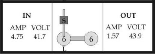

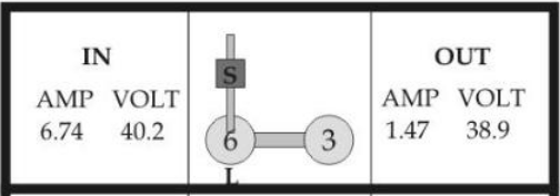

                • Netica Data
                  Hi Netica, Nice work on the replication. Try spring steel on the shaft, less problems with breakage and will allow vibrations to be less damped. I have drawn up the data from the video, I hope this helps those who are working on this. Regards Arto
                  • Thanks artoj for putting the results together.
                    Netica, please noticed that the current of the prime mover (motor) went down by 2 amps when you added 3 more disks to the generator side. Maybe if you remove disks from the prime mover side the current may go down more?
                    We have to keep in mind that Fernando's demo unit the Generator was much larger then the pime mover, so the weight of the generator rotor would account for much of the flywheel weight. On your test unit both motor rotors and generator rotor look the same. So it , maybe worth reducing the flywheel weight on the motor side to see if the current can drop any more.
                    Thank you for your great replication work and sharing all your tests.
                    Luc

                      • Originally posted by artoj View Post
                        Hi artoj,
                        Thank you. Good of you to have put together the data as you have, makes it easy to refer to.
                        The motor and generator are both dc motors, when I purchased them I was told they came out of old computer tape drives.
                        The motor nominal power rating is 50v
                        The generator nominal power rating is 72v
                        I tried to double the input voltage for each video.
                        Regarding the RPM, I have done some rough tests with magnet on shaft, coil and see hertz readings, not sure of the accuracy.
                        unloaded readings for motor on its own nothing connected.
                        12v - 350 RPM
                        24v - 690 RPM
                        48v - 1266 RPM
                        netica
                          Luc
