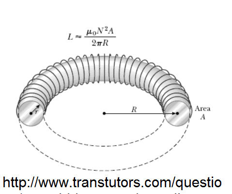

              ... we have the opposite (N) number of turns, (A) square-section of core in meters squared and (l) length of coil in meters, all three are varied over time changing currant and since opposing emf is amplified by the core we have a constant currant variation as the brush rotates, each set in complete unison with the other.
              ... I just can not imagine how he varies the cross sectional area of the core, which is an iron torus in this case. Any ideas?
              You will note that I highlighted "square-section of core in meters squared" and "varied over time" and carefully worded a specific question: How can you vary the cross sectional area of the core (A) over time?
              Understand? you make a statement. I ask a specific question. Tell me how you vary the cross sectional area? Or can you comprehend the concept of statements, questions and answers?
              Here, I'll attach a picture for you showing what A is, cross sectional area of the toroid core. Can you see that? How do you vary that area (A) over time?

                • Toroidal 3D Dynamic Geometry changing Over Time...
                  No. You have just evaded my question.
                  Bistander,
                  What I believe MM is trying to convey to all of Us...relates to Two GEOMETRICAL Parameters which defines a Volume within Toroid Core.
                  These Two Geometrical Parameters are defined by :
                  1- Parameter A which is the cross sectional area of Toroid, and this specific area would be defined by the Moving Brush carrying the positive V value as the brush contacting ring from the coil winding.
                  2- Parameter L Which is the Coil Length defined from A Cross Section to the two output positive Ports Circumference distance between them.
                  This Two Parameters are constantly changing positioning and values over time, therefore, the 3D Volume defined by the Two Parameters.
                  Parameter A changes Positioning over time.
                  Parameter L changes constantly its Circumference Arc Length over time.
                  Both parameters changing over time define a 3D Volume which is constantly moving within the iron toroid volume.

                              Hi Ufo,
                              There are no magnetic poles in the toroid. No North, no South. It is closed. The magnetic field is contained within. That field has a direction and magnitude, but no poles.
                                Hi Ufo,
                                Bistander,
                                A magnetic field without poles?
                                Never have seen one magnetic field like that, swear it, honestly.
                                Ufopolitics
